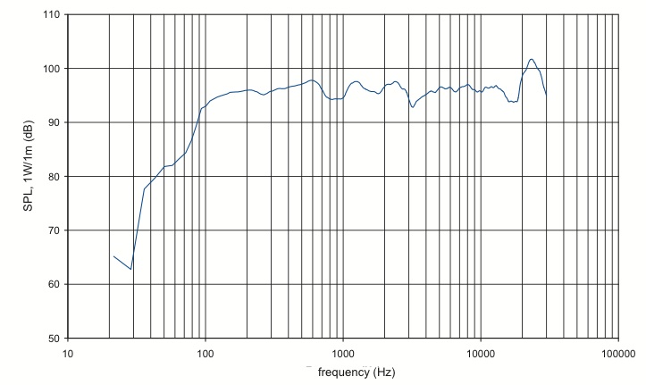

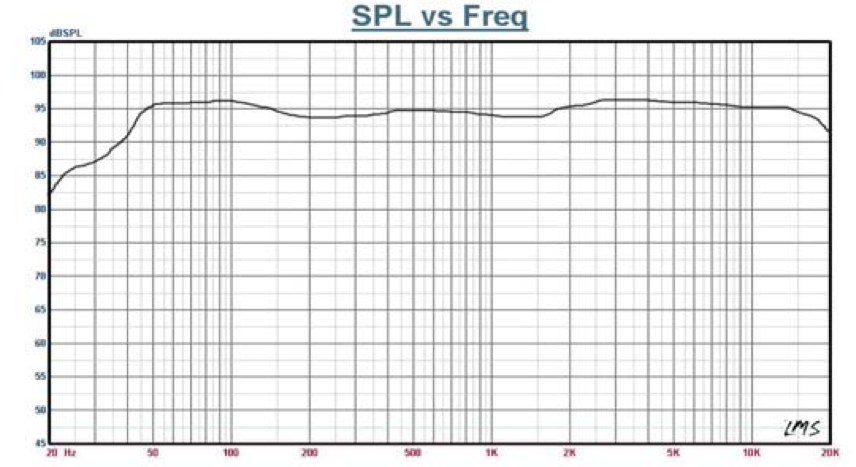

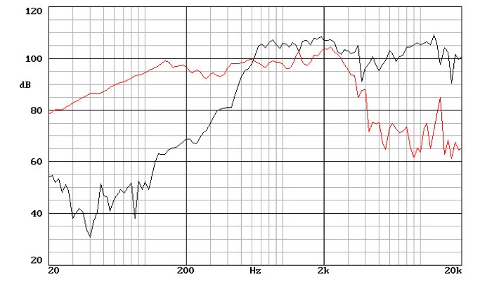

Here's the published frequency responses of the Beyma 15XA38Nd (left), along with the Tannoy DC12i (middle). Both are a lot rougher than I'm used to working with, which leaves me curious what the unsmoothed response of the Radian 5210 (right) looks like.
