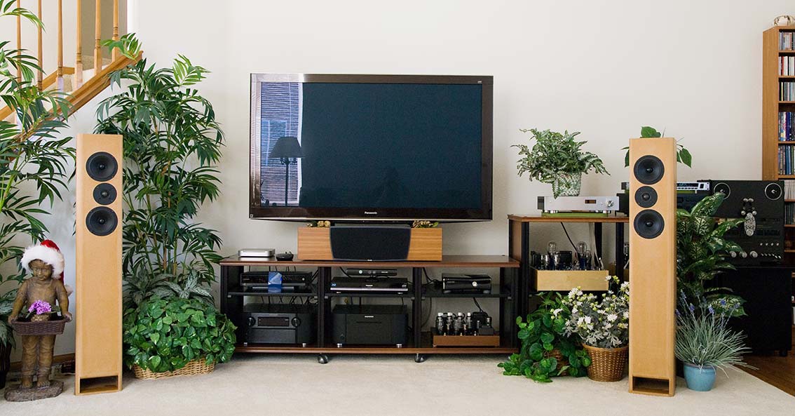

Been thinking about a new center speaker to go along with the new LTO's. As you can see from the photo below, the Panasonic 58" plasma TV is in the middle, with a Dynaudio Contour SCX as the Center speaker.
The Ariels, like the LTO's to come, have changeover switches on the external crossovers, so they can be switched between the Marantz MM8003 and the Karna amplifiers. Both ground and hot are switched, so there is no electrical connection at any time between the 5.1-channel home-theater and the 2-channel all-vacuum-tube system.
The HT system, Blu-Ray player, XBox360, Mac Mini, and a server-grade sinewave UPS (for the TV and Comcast DVR) are plugged into a set of AC outlets on the left side of the picture. Behind the TV there are cable-TV 75-ohm sockets along with Ethernet for the TV, Blu-Ray player, Xbox360, and MacMini. On the right side of the picture, there's a separate set of AC outlets for the Denon 2900 transport, Behringer Ultramatch Pro SRC2496, Monarchy N24 DAC, and the two Karna amplifiers. I expect in time I will have an electrician install separate runs for the HT and audio outlets, going directly to the main circuit breaker panel.
No, I am not going to find a separate room for the audio or video system. Not happening. They have to co-exist together, in the same room, and share the main Left and Right speakers.
So ... the Center speaker has a direct connection to the Marantz AV8003/MM8003 combo, and one of the options for auto-EQ is matching the L & R speakers (which have very flat responses and do not need EQ). But ... I am not completely happy with the intelligibility of the Center speaker. It's OK, I guess, and the Dynaudio is almost certainly one of the best Centers you can buy. I think the problem isn't the drivers (which are real, made-in-Denmark Dynaudios) or crossover, but the side-by-side MTM layout.
I usually sit a bit off-center when I watch movies with Karna, and the arrival time from the pair of midbass drivers is different by a few inches, which I suspect affects intelligibility of movie dialog. I heard plenty of Center speakers before buying the CSX, and trust me, nearly all of them were a lot worse, with atrocious tonality and overall low fidelity. To it's credit, the Dynaudio CSX is neutral, musical, and sounds like real hi-fi, and dialog is reasonably good.
So if I want better, I need to use a different driver layout than side-by-side MTM. As you can see, a vertical layout is not an option unless I want to raise the TV to a ridiculous and visually uncomfortable height (the visual horizon line is just below the upper midbass on the Ariels).
So ... coaxials come to mind. I've auditioned the KEF Uni-Q's. No. I've auditioned the TAD Reference One. No. Tannoy? They won't sell the drivers, and no, I'm not interested in taking my chances with vintage Tannoy drivers on eBay or Audiogon. GPA 604 Duplex? A possibility, but the response is nowhere close to flat in stock form, and I don't want to spend months designing a crossover for a Center speaker that will only be used for movie dialog.
That's when I started looking at the Radian 5312 Neo and 5215 Neo. Hmm, interesting. Pretty flat response with the stock crossover (which I would not use), and they're used in pro applications as compact studio monitors. There's a very nice review by Scott Dorsey in Recording Magazine. I've met Scott at the Positive Feedback get-togethers, and the man knows what he's doing, and has good taste in audio. His favorite is the 12" Radian; point taken.
OK, with the driver selected, what kind of enclosure? My friend Gary Dahl tracked down this source of rounded corners, which can be used for the left and right edges of the cabinet. What kind of bass loading, particularly given that it's going to be used with the 80 Hz highpass filter of the home-theater receiver? That's where Gary Pimm's open-back box, completely filled with Bonded Logic recycled cotton filling, will do the job. His boxes are about 1 to 1.5 feet deep, and surprisingly, are flat to 100 Hz. Unlike open-back dipoles, there's no baffle peak and no requirement for rising EQ below the baffle peak (Gary measured them for me the last time I visited Portland).
This is looking promising. An open-back box filled with Bonded Logic filling, large-radius rounded corners, and a Radian 5312 Neo coaxial driver with custom crossover (most likely using the LTO crossover as a starting point).

Lynn,
I have found that a narrow polar pattern WITHOUT LOBING is beneficial for a home theater center channel because it locks the vocal position queues to the screen. I had 40 Lambda speakers so….. Our home theater center speaker is a Lambda TD15M crossed LR4 at 1300Hz to a no-rim SB29RDCN dome tweeter which is attached to the TD15M's large phase plug with a piece of bicycle inner tube plus a foam rubber bumper. I have played with extending the inner tube beyond the tweeter dome and creating a short oval shape funky waveguide. ... different ... not better sounding. Simple 50Hz Qts=0.5 bottom ported box built into an oak parsons table that is part of our living room furniture set. THX spec recommends flat down to 80hz.
I think you will be very happy with the Radian 5312NEO, if you can find one. Perhaps you could construct a cabinet that matches the length and depth of your HT “rack”.
Experimenting with a narrow pattern tweeter waveguide for the center channel would be interesting.
I tried the center speaker route for a while - first MTM, then WMTW, above and below the TV.
I finally rearranged my room to where the seating position is very close to center, and now I find that the best sound is with no center channel at all.
The shelves below the center speaker create resonances and the TV above it reflections, so with such a poor environment, I think as a rule, it's best to avoid the center if at all possible.
