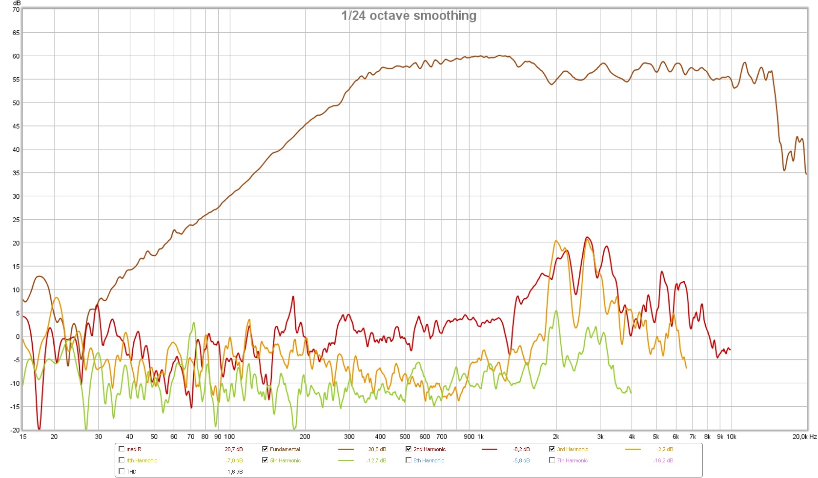

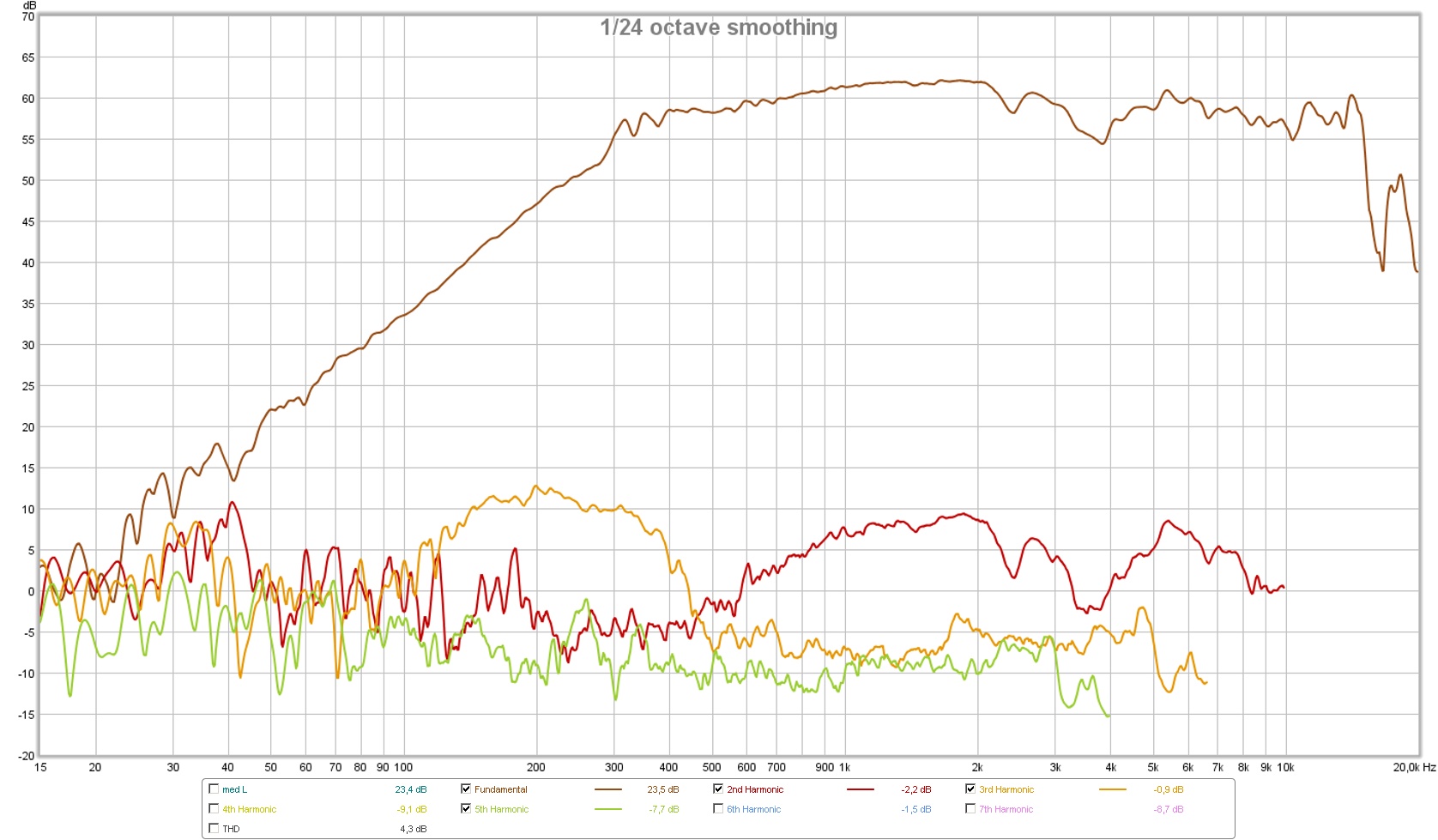

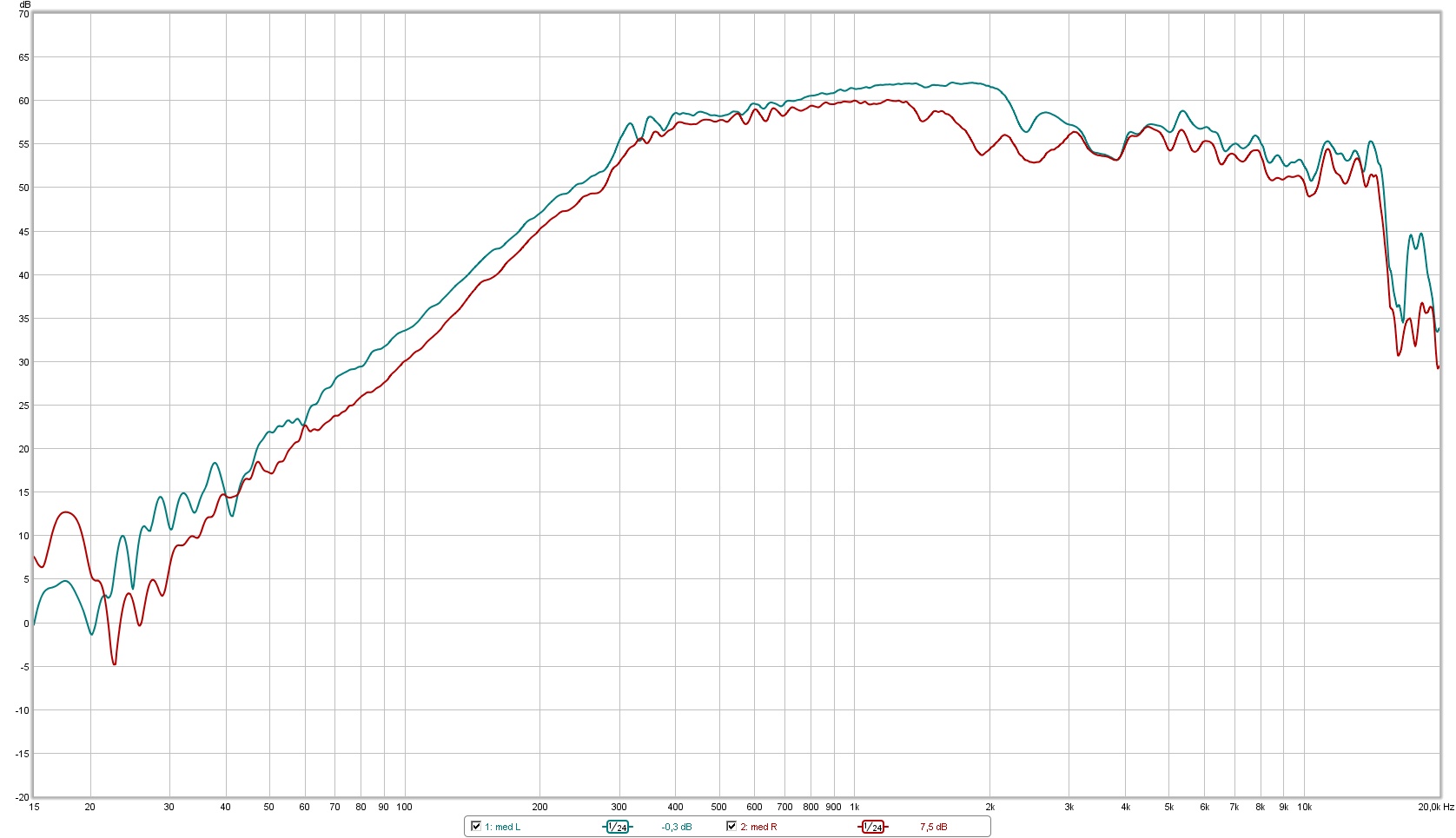

Hi Earl K and others. I measured both GPA 388 drivers. I found that they are quite different in FR and distortion. One of them displays the distortion pattern of a poor fit example EarlK gave. The other one does not although both present similar but not identical FR. I don't know what to think about.
This once again raises the question of quality and consistency of those drivers. I am not very glad of that. I’m able to EQ them flat with 2/3 parametric filters but it isn’t the ideal situation. I must admit that maybe apart some occasional harshness on loud music I can not hear any major problem.
I contacted GPA and asked if they can send me a spider shim. We will see. I would like to be able to at least check the phragms alignment. This is doable although a very delicate operation. I once damaged a diaphragm on an 806 driver. Somebody knows where I can buy a stainless steel or aluminum screwdriver?
Christophe

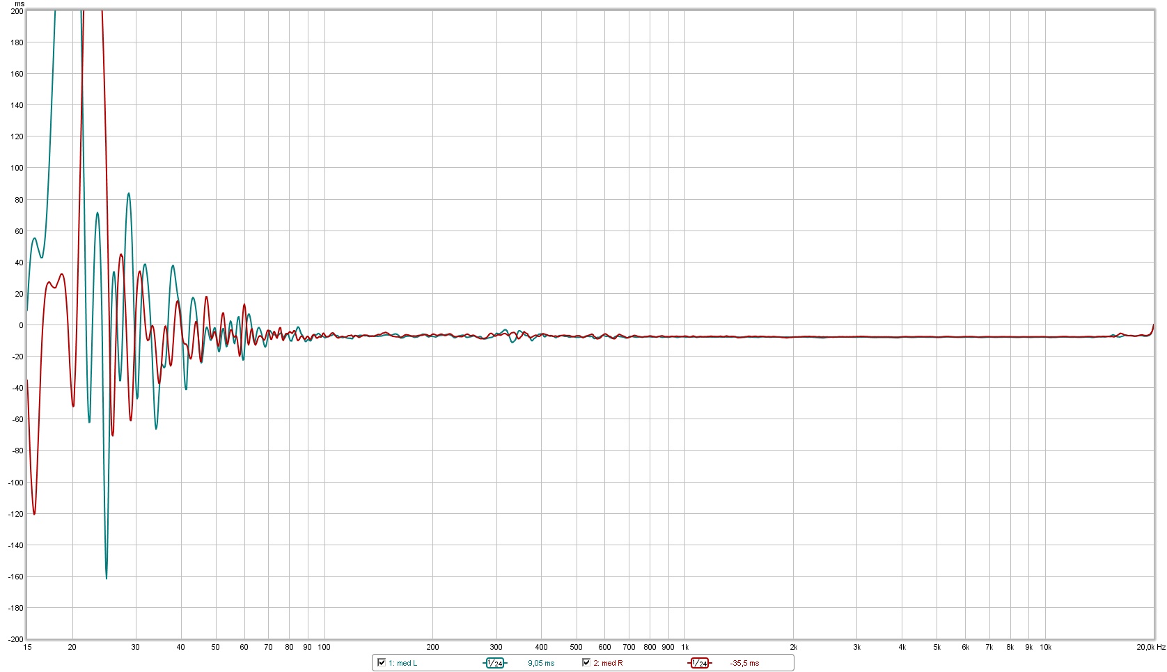

Measurements where taken at the horn mouth. SPL is not calibrated. In order: SPL and distortion of both drivers, SPL overlay and group delay overlay

krzys,
- For a "Pro" driver those variations are not out of line ( & sadly, still expected from the established names ) .
- I'm in Pro audio and don't consider $ 340.00 ( per compression driver ) as a ton of money / so my sympathies are pretty limited here .
- If you had wanted "matched" drivers ( for audio-phile purposes ), you should have offered GPA a premium price (per driver ) to go through their inventory to find two the same.
- I know GPA can match drivers ( when asked ), here are two of their 902s , as obtained by our dearly departed "Zilch" . IMO, these traces are wonderfully matched !
- I would work on getting the distortion content down for this driver ( fyi, from 500hz to 10K, the third harmonic should average @ 15db below H2 on the "full-body" 288 / the pancake-body 388 is anyones guess ) .
- I published these 2 blow-up pics ( of Brandons "overly small" FR studies ) almost 3 years ago to better highlight the variations in GPAs blind-pulls.
- This was before you bought your GPA 388s .
- So I'm now wondering where you got the idea that these "blind-pulls" from the GPA inventory would give you matched responses ? .
- I don't think it would have been from this post ! Please note my opening line .
- A close scrutiny of AugerPros measurements implied a diaphragm fit up problem for one driver ( indicated within his distortion findings ) from more than 3 years ago .
- Here are Brandon's original words of caution ( regarding distortion ) as found in the first measured GPA 288H .
- The data ( on his site ) for the first driver was removed & replaced by a second set of measurements ( I suppose after it was determined that the first driver with the 2K-4K "problem" was not a healthy specimen ).
<> EarlK
