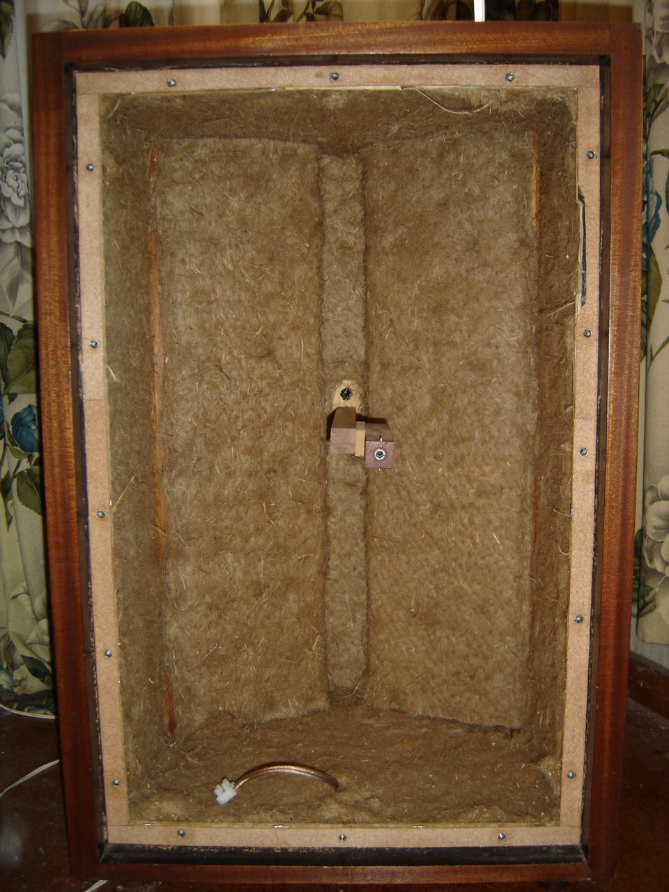

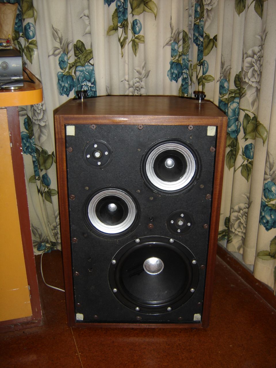

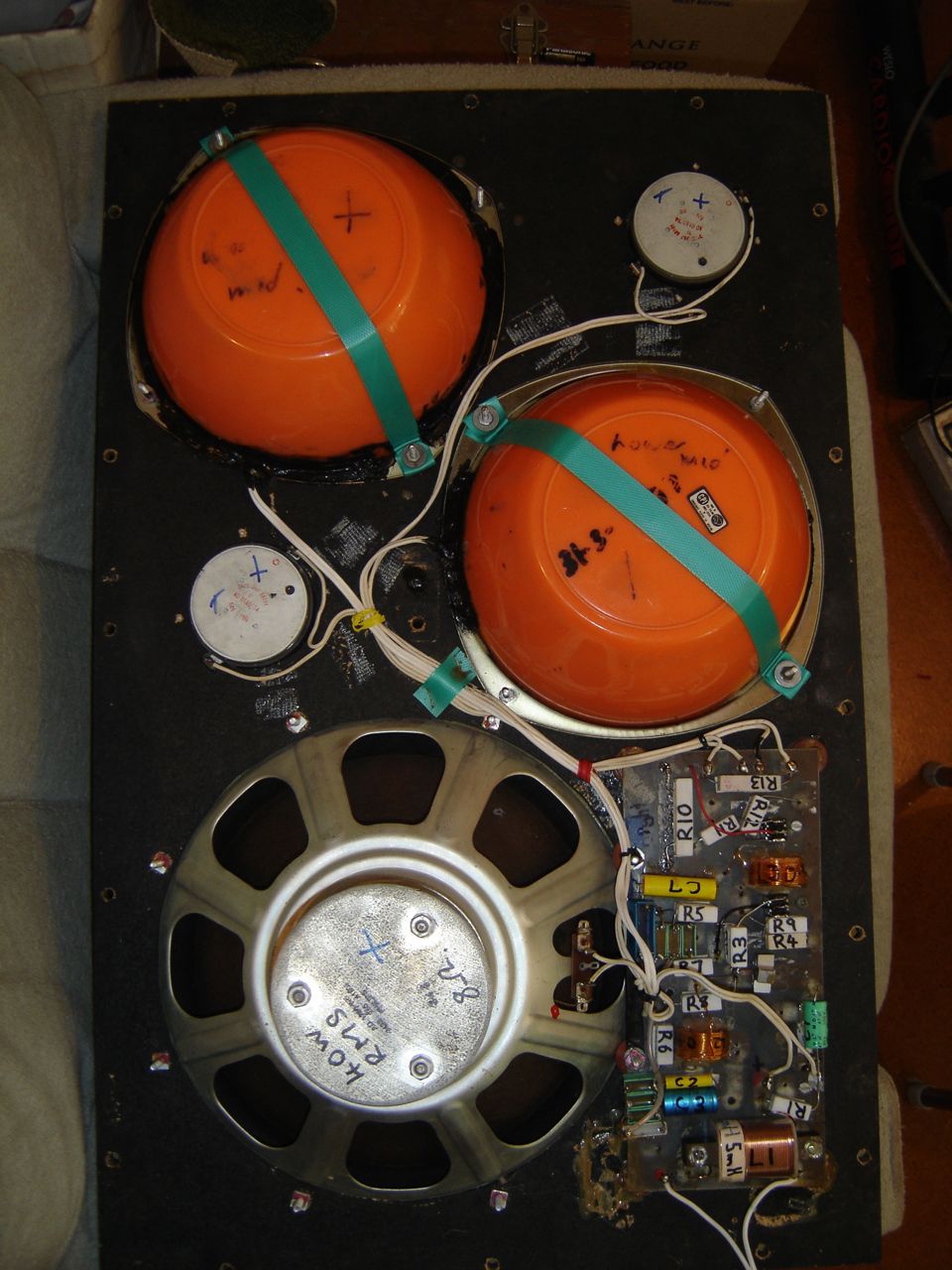

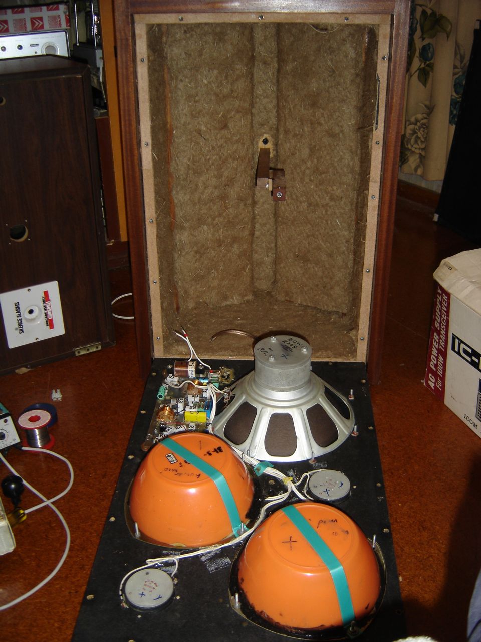

Interesting comments on resistive-vent systems. Do you think the design in the images below counts as resistive vent ?
You can't tell from the angle of the pictures but the rear corners of the cabinets have large chamfers, on each of those chamfers there is a slot/vent which is 15 inches high (roughly half the total height of the cabinet and centred half way up) but only 1 inch wide which enters the cabinet just behind the turnable baffles, and as well as the enclosure walls, both sides of the turnable baffles are lined with the same lining. (The actual slot itself in the cabinet wall which is approx 1" deep doesn't have lining though)
These were built by my Dad in 1971 (and updated to the driver configuration shown in the pictures in 1977) and I always really liked the sound of them, despite the odd driver layout they are incredibly dynamic and whilst probably not as accurate as many modern speakers manage to have an almost eery sense of you-are-there realism and presence.
When I was first starting to get interested in speaker design around 2000 or so one thing that always baffled me about these speakers was that although they are bass reflex (or so I thought) they do not have the classic double hump impedance curve at all.
There is a clear minimum of visible cone excursion which varies in frequency depending on where the adjustable baffles are set - about 36Hz with them right back parallel to the chamfered rear corners, rising to about 48Hz with them set parallel to the front panel, which actually divides the cabinet into two separate volumes with only a 1" gap between the two baffles. (Total box volume is approximately 90 litres)
So clearly there is bass reflex loading occurring, however the only impedance peak is the lower of the two peaks you would normally expect - with the baffles towards the back it peaks to about 20 ohms at 20Hz, however there is no peak in the 40-60Hz region, just a very very tiny broad bump only increasing from about 8 ohms nominal to 9 ohms or so from memory somewhere around 45Hz, but barely noticeable on the graph.
Its easy to assume that there is just so much loss in the vents that the system is close to a closed box but its anything but. There is a LOT of output from the vents, and over a very wide frequency range. Blocking them off reduces the bass output by many dB over a wide frequency range well up into the midbass. (There is still a lot of output from the ports as high as 65-70Hz even though the box is "tuned" to 36Hz)
Cone excursion is also amazingly small at rather high output levels. Yes they do start to move quite a bit below 30-35Hz, but anywhere from about 35Hz up the cone excursion is barely visible even at quite high SPL. (Floor loading from the woofer being close to the floor probably helps a bit here)
The bass doesn't have amazing extension, its good down to about 30Hz including room gain and that's all, but its very tight, dynamic and clean with no boom or overhang. Kick drums sound amazing on them for example.
So what are they exactly ? Just a bass reflex with a lossy vent ? Could they be some sort of coupled cavity when the baffles are parallel with only a narrow gap coupling the two cavities ? They don't seem to lend themselves well to traditional lumped component analysis...(I can't get any match between measured results for SPL and impedance using a normal T/S simulator, even if I play with the vent loss figure)
(pictures taken in 2005 when a bit of revamping and redesign of the networks was done)

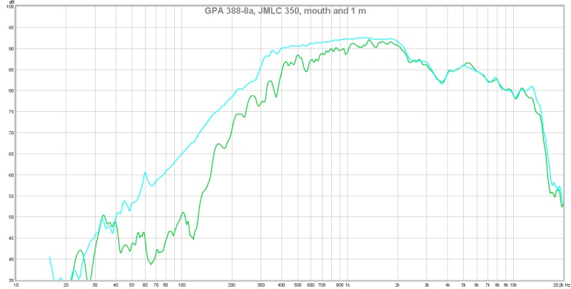

Hi Lynn and others, I'm following this tread since the beginning and find it VERY interesting since the design is going in the same direction that my system. I use 2 tapped horn subs and one closed box sub followed by JBL 2235 in closed boxes (65 to 900 Hz) , then JMLC 350 horns with GPA 388-8A (900-6000 Hz) and JMLC 1000 with Celestion CDX1-1425. My system is multi amplified and digitally crossed.
The 388 GPA is a ferrite version of the 288 with aluminum membrane , not Pascalite. As quoted, you say that your medium combo measures nearly flat. This is not my case and I'm wondering why. Look at the joined measurements (SPL is relative). A broad hump in the medium with a nasty drop at 3700 Hz. Does anybody sees any explanation? Of course those drivers ca be equalized but at the expense of reduced output and I have difficulties to adjust the crossover on both sides of the used spectrum , 900 and 6000Hz.

If the measurements are to be trusted, it's only flat from 400 Hz to 2 kHz; the range above that looks unusable. I'd be very reluctant to apply boost equalization where the response has multiple notches and falls like a rock.
Two thoughts: is the air-seal between the horn and compression driver good? Does the exit of the compression driver exactly match the entrance to the throat, or are there rough spots and a lot of hand-sanding? I've seen $15,000 audiophile speakers where the entrance to the wood horn was crudely done with a pen-knife, complete with wood splinters that partly blocked the horn entrance.
Next, maybe the Altec is just plain defective. There were some years when Altec's quality control was pretty bad. You can usefully cross-check this by getting a pair of Radian 745 (I recommend the Neo) drivers - they're not that expensive from prosound vendors.

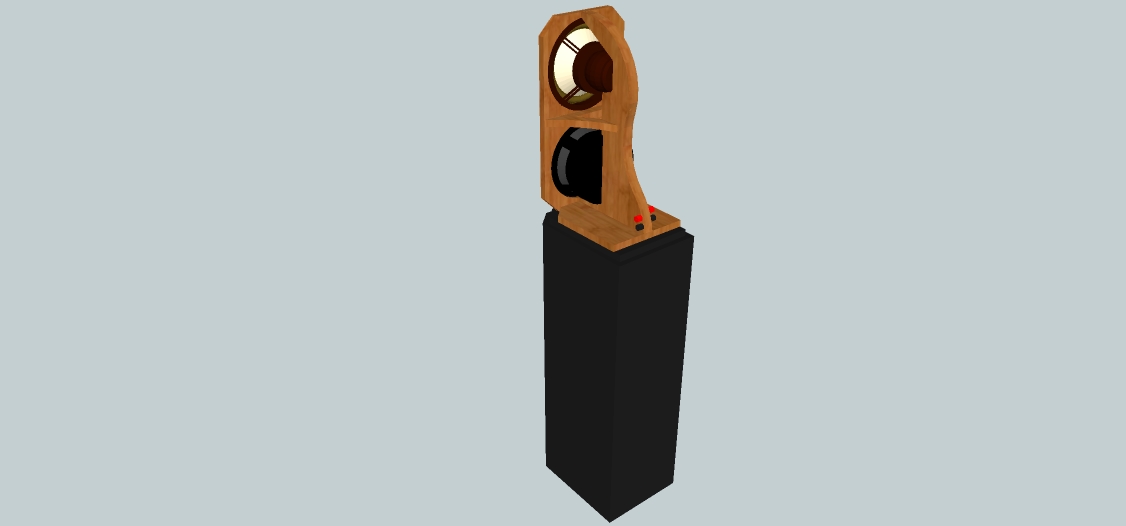

I would certainly agree. I have the Lowther PM6A 16 ohm silver voice coil (whew) and Eminence Delta 8 drivers mounted nude on a simple minimal baffle on top of a pair of Dave's TL towers.
The TL matches the two nude drivers perfectly and meshes with the dipole without any audible grit. The Lowther and emminence are to gen 2 EnABL and neither exhibit any shriek, shout or time "beat" between the three elements, whizzer and two cones. The crossover is a simple first order series, set for 200 Hz between Lowther and Delta 8, without allowing for the series added L&C factors in the crossover components and the Delta 8 runs to 20Hz. Doesn't respond to 20 Hz of course.
The TL's are driven by inexpensive SS plate amps and are currently running up to a 200 Hz cutoff and their phase control is adjusted to about -50 degrees from 0. The sound is effortless, transparent, for the first time out in front of the drivers, along with side to side and deeply in back. All of this without any thinness being evident. Interestingly all of the sound stage parameters can be altered by minute adjustments to phase, cutoff and amplitude for the TL's. I do mean minute, it would be nice to have a bit better resolution to the pots, so I may see to that shortly.
The amp is an AudioPrism Debut with 2,4,6 & 8 ohm out taps, so it isn't yet working at it's best. New Level three outputs and a considerably beefed up power transformer, for Christmas, should help.

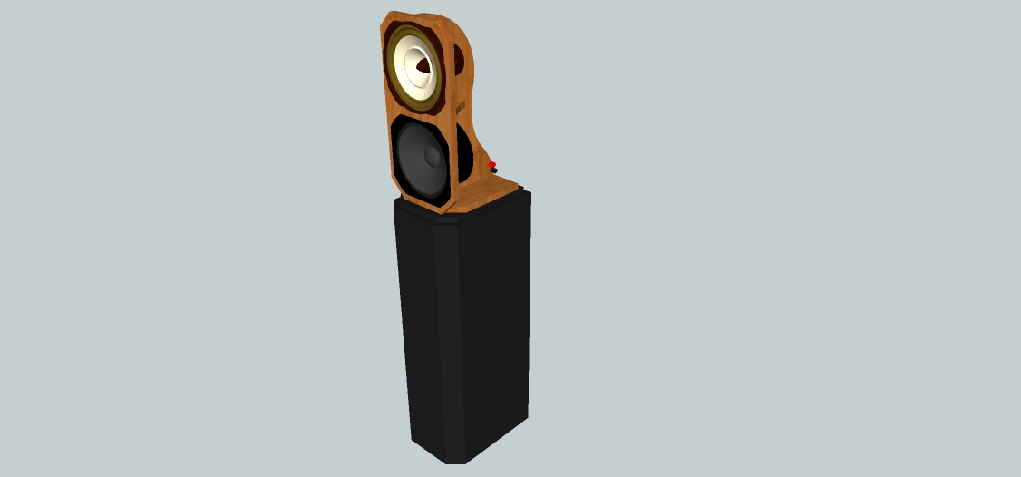

Hi Bud,
You've been busy! It seems that it's doing what you had wanted/ anticipated/ planned on since the beginning. Will you be having a private showing in the future? I'm sure a certain 200% Gentleman, along with a few others of a slightly courser nature, would love to hear these wonders of the Sonic Art.
The drawings look great and I can imagine that they sound absolutely splendid!

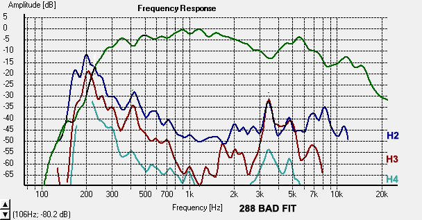

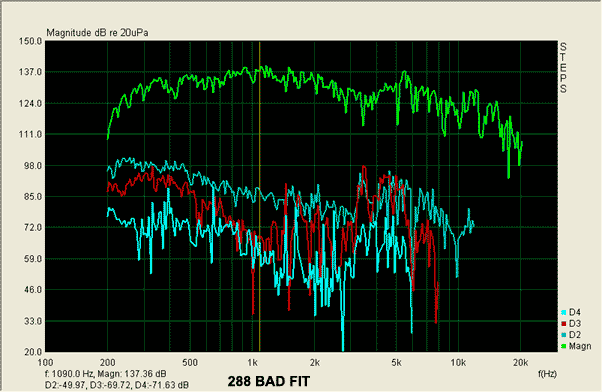

krzys said:
<snip> A broad hump in the medium with a nasty drop at 3700 Hz. Does anybody sees any explanation? <snip>
- The explanation could be as simple as a poorly fitted diaphragm ( on your GPA 388 ) .
- Here's the distortion ( & FR ) plot of a poorly fitted ( new GPA ) diaphragm ( belonging to Pano ) put into one of his 291/288 driver bodies .
More ( from Pano ) ;
Notice the simularity to your ;
- I recommend you remeasure the distortion content ( using STEPS, HolmImpluse or REW ) & then look in the 3.7Khz area.
- If H3 has climbed as high as H2 in the region , then your diaphragm is poorly fitted .
- If that's the case, simply refit/realign it .
H2 vs H3 should look something like this ( when the diaphragms are fitted properly ) ;
or this

Thanks Earl. I'll have to look back at my 288 measurements on a different horn, but I think the dip is always there. You see a little on the Emilar horn, but not nearly what I get. The wavelength is just about the same as the distance from the diaphragm to the exit of the driver throat.
If it's like with the small format drivers, it, and the peaks/dips above it are all due to the discontinuity created by the driver/horn junction causing reflections back to the driver's internal horn throat. I smoothed out/extended the HF response of a pair of 802D/511 combos by replacing the cardboard spacer with a metal one sealed with wax paper gaskets, then align honed the assembly.
The downside of course is that this would have to be redone each time a different horn was used if you wanted to maintain this level of HF performance.

Hi Lynn, Earl K, Pano and others, thank you for your responses and help. Indeed, I bought two GPA 388 in April 2010. Both measure the same so I thought that it is normal with the aluminum membrane (part number 23763) but I got frustrated when I read that 288 measures flat on Azura horns. I have chosen GPA driver because I read some negative impressions about the SQ of Radian drivers.
My horns are Autotech JMLC 350 made from fibreglass with very smooth throat, 8 deg entrance angle, steel mounting flange and 388 have neoprene soft gasket. I think that I can conclude that neither the horn nor the gaskets are the problem.
Searching in the tread I found that we had the same discussion in December 2009, page 646 posts from 7th, post 6452.
I then must conclude that GPA drivers are not reliable and could not be recommended (or that the response isn’t flat at all). I cannot accept that a driver paid 340$ need some work and realignment. I will open them and try to align the membranes and will report the result.
At GPA site I found this:
http://www.greatplainsaudio.com/LgDrvrDiaRepl.pdf
The instruction recommends using a spider shim but I don’t have this shim!!!!!

Chistophe, as far as I know, the spider shims come only with new diaphragms so that you can align them when you install them. My 288s were 291s, I added the new diaphragms to them. Alas, mine did not have the locating dowels, so alignment was very tedious, even with the spider shims.
Your 388 drivers should have come aligned.
