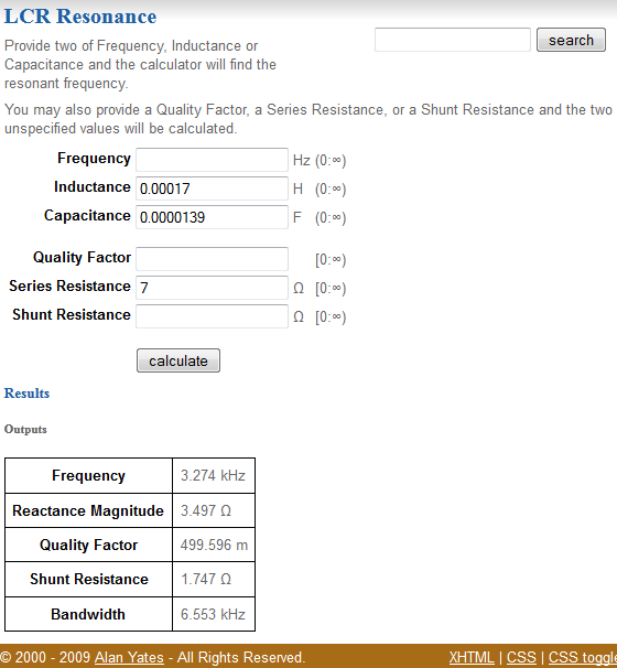

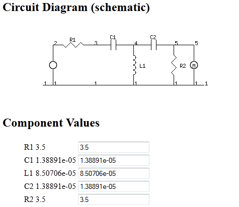

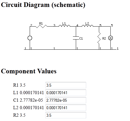

I feel slightly intimidated by the august company in this idea-sharing thread, but care to share an observation about why some combinations of crossover values and drivers might have a sweet spot! 😀
I started with a real midrange driver, the Scanspeak 15M/4531KOO, which has a pleasingly low inductance of 0.17mH, and Re of 3.5 ohms.
I then calculated the simple Zobel to correct it (assuming linearity, which suits my purposes...LOL) and got 3.5 ohms and 13.9uF. I then calculated the series LCR resonance, and got 3274 Hz.
OK, bear in mind 0.17mH, 13.9uF, 3.5 ohms and 3274 Hz. What do you think a third-order Butterworth looks like at 3274 Hz in my preferred matched source/load topology? 😉
Isn't that elegant! There's a pattern there for someone who is paying real attention! 😎

System7 I think the pattern is C1 and C2 are 1/10 the Zobel C1
Also C1 on the first circuit is twice the value of the C1 and C2 of the second circuit
