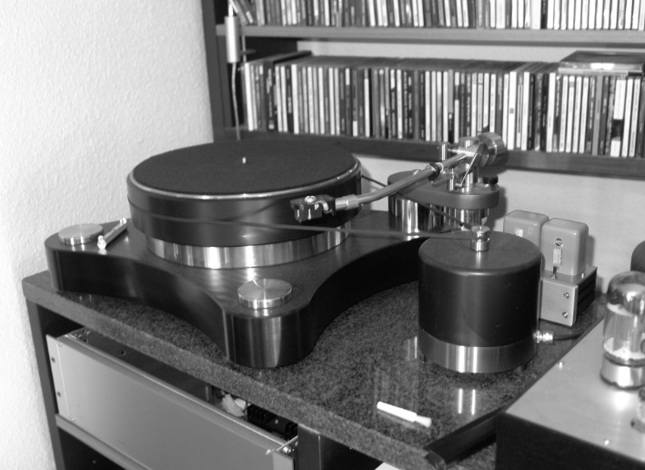

With this kind of cartridges (103, SPU, Koetsu, AT33, EMT), stiff ones (not reallt the EMT... but), the Fidelity Research FR66S will probably be a very good, stable and versatile choice... The problems are that you will need a large enough turntable to install it, the turntable has to be very heavy, you'll never be able to use a high compliance cartridge, and it is not cheap.... But if you use a stiff cartridge (and play a little bit with the headshell), what a pleasure (and easy to trim with the B60 base).

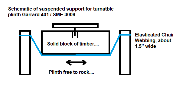

I'll just throw in what I thought was one of the neatest solutions to isolating a turntable plinth I ever saw, can't remember who made it...:)
The SME arm and Garrard 401 turntable was mounted on a solid wooden plinth, but the whole thing was suspended on two straps of elasticated furniture webbing within a rectangular wooden frame. You had to see this thing rocking gently backward and forward while tracking securely to believe. Best mounted on a solid wall of course. Looked a bit like the old SME plinth, but NO SPRINGS.
The acoustic isolation from vibration was quite superb. Your engineering problem reduces to simply the plinth, turntable and arm mounting as a closed system. :cool:

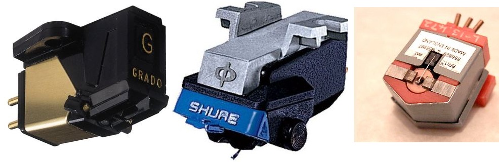

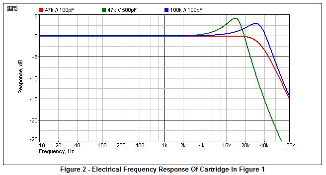

I have previously mentioned how useless most magnetic cartridges are. The high inductance Shure designs ended up with a second-order high frequency LC response that had the stylus moving at 180 degrees to the groove as in the Rod Elliott plot at high Q. It wouldn't matter with a microphone, but for a cartridge that means mistracking.
Magnetic Phono Pickup Cartridges
By contrast, designs like the Grado and venerable 1960's Decca London worked at first-order high frequency, so were much sweeter sounding, albeit they need a heavier tonearm to avoid overexciting arm resonance.
That's a long post by my standards, sorry. Seems to me you get it all rigid, but then think about how to dissipate the energy with one fell swoop. Maybe sandwich construction is a viable solution. Glue a piece of granite to a piece of wood in your plinth, and the energy can dissipate. Many ways to skin a cat. It's all physics in the end. :)

If you must use a high-inductance cartridge (typically these require a stated cable capacitance to measure flat), better to use as little capacitance as possible, and HF equalize in the preamp at a location that is electrically isolated from the input circuit. That way, you can hear the cartridge by itself, instead of a resonant 2nd-order lowpass filter with a bad capacitor (even astronomically expensive cables make pretty bad capacitors).

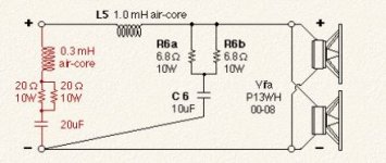

In studying series crossovers with a lot of confidential information supplied by my friend speakerman19422, I have come to realise that you must work with voice coil inductance for a good result, not just try and equalise it.
Look at this classic radio-frequency solution to a 2500Hz butterworth:
The 4 ohm resistance is the RL bafflestep circuit. Now all you need is a mid/bass driver with a 0.25mH inductance and a flattish frequency response. Enter the Scanspeak Revelator 15W/4531G00. L2 is now included in the driver and you don't need a Zobel. :cool:
You have less issues with a low inductance ferrofluid tweeter which really won't need equalising on a third order butterworth. That bit is not hard.
Combining the VC inductance with the lowpass filter design is kind of against my religion; true, it saves parts, and models beautifully. But I don't like the way it sounds - to my ear, murky and congested in the very region where the VC inductance is interacting with the filter.
My best guess is the VC inductance, as mentioned in the previous post, is a remarkably low-quality inductor, very likely the worst in the entire audio chain. Think about it: would anyone set out to build an inductor wrapped on the soft-iron polepiece that has a big fat ceramic magnet as part of the magnetic circuit? Given that VC inductance is possibly the worst single inductor in the audio chain, should it be part of an important lowpass filter? I prefer a degree of decoupling, if possible.
We're stuck with VC inductance, although the exotic current-drive schemes can minimize the sonic impact. Current-drive loudspeakers typically requires multi-amping (with custom amps) and active crossovers, a whole different can of worms. (That approach is more successful if you are satisfied with the sound of solid-state amps and solid-state or digital equalization.)
Staying within the single-amp & passive-crossover paradigm, I prefer to take steps to isolate the nonlinear elements of the crossover from the linear elements, so the reactances do not see each other. Although not perfect, Zobel correctors help a little bit - they sound better to me than synthesizing the VC inductance into the lowpass filter. Saving a few dollars on crossover parts might be important for a high-volume manufacturer, but I have no interest in that market.
It's certainly true that some VC inductors are better than others, thanks to copper shorting rings, etc. etc. But compared to air-core inductors, or good-quality transformers, they're still pretty bad.
I would thoroughly accept that a 2nd order with impedance correction is as viable a solution as a third order bass filter which doesn't need it. If you say it sounds better, I'd believe that too. Very nice drivers in the Ariel, btw. Quite series crossover suitable, IMO. :)

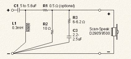

I'm currently interested in the very flat impedance a pair of butterworth slopes seem to present either with series or parallel crossovers, since this should make frequency response fairly independent of amplifier source impedance. Did you try a (10uF?) capacitor on the bass filter to make it second order? Was it bad? I assume the optional 2kHz notch filter on the input is a valve amp impedance correction or notch depending how you look at it.
I started out fairly early in the process with a conventional 2nd-order lowpass, but heard a noticeable coloration (assessed with pink-noise, not music) centered around the crossover region. Listening to the Vifa drivers by themselves, with the lowpass filter in place, I adjusted the series R on the shunt capacitor until the coloration just barely dropped out of audibility - the transition was actually fairly abrupt, obviously falling through a perceptual threshold. With something as variable as music, this slow crossing of a perceptual threshold would have been impossible, but with a steady source of pink-noise, it's pretty easy to hear. I do advise adjusting the control at the listening position with the crossover more or less in your lap.
Examining the effect of the series R in MLSSA revealed a fairly small change in group delay at the corner frequency, pretty much what you'd expect, but audibility of group delay varies quite a bit with frequency, so it has to assessed on an as-needed basis, not going by group-think on the forums. In other words, you have to listen for yourself, and train yourself to hear colorations emerging out of the pink-noise. Not everyone finds this easy to do, but music is much worse when you're trying to fine-tune a crossover and remove the last traces of coloration.
Answering the first part of the question, I'm not actually using classical Butterworth electrical crossovers - the Q is considerably lower, and that is by design. Acoustically, the Ariel is fairly close to 4th-order Linkwitz-Riley, since the null at crossover is quite deep (25 dB) when the drivers are temporarily connected in an out-of-phase condition.
Lower-Q crossovers in general are less sensitive to source impedance and parts tolerance variations. As the order goes up (electrical 4th-order), though, they can become pretty sensitive, especially if the caps are off by more than 5%. Crossover and bass-alignment sensitivity definitely has to be cross-checked with the type of amplifier that is intended to be used with the loudspeaker.

Lynn, if you notice a change in group delay when you adjust the value of a resistor in a zobel there must be a corresponding change in the amplitude response as well. I can not help but wonder if it is not this change in amplitude, rather than the effect of the zobel on the load the other x-o components see, that is the primary effect.
You mentioned your reasons for using a zobel a few posts ago,
I fail to see how a zobel will isolate nonlinear elements from those which are linear. VC inductance is a nonlinear function of both frequency and displacement. To first order Le can be expressed as Le(F,X) = Le(Fo,Xo) + dLe/dx (X-Xo) + dLe/dF (F-Fo) and all the zobel can do is function as the conjugate to the linear part, Le(Fo,Xo). It thus adds another linear, reactive component in the crossover which interacts with the nonlinearity of the driver's impedance rather than eliminate anything. Certainly R and C of the zobel can be calculated based on Re and Le(Fo,Xo) to form a conjugate, but if the values are to be adjusted based on some other criteria, then they would seem to function as just additional response shaping components.
Looking at the LC part of the crossover, yes, the LC section of the crossover may see a more constant load, but looking back from the driver all that is difference from an LC filter is that C has split into a segment with low series resistance and segment with high series resistance.
