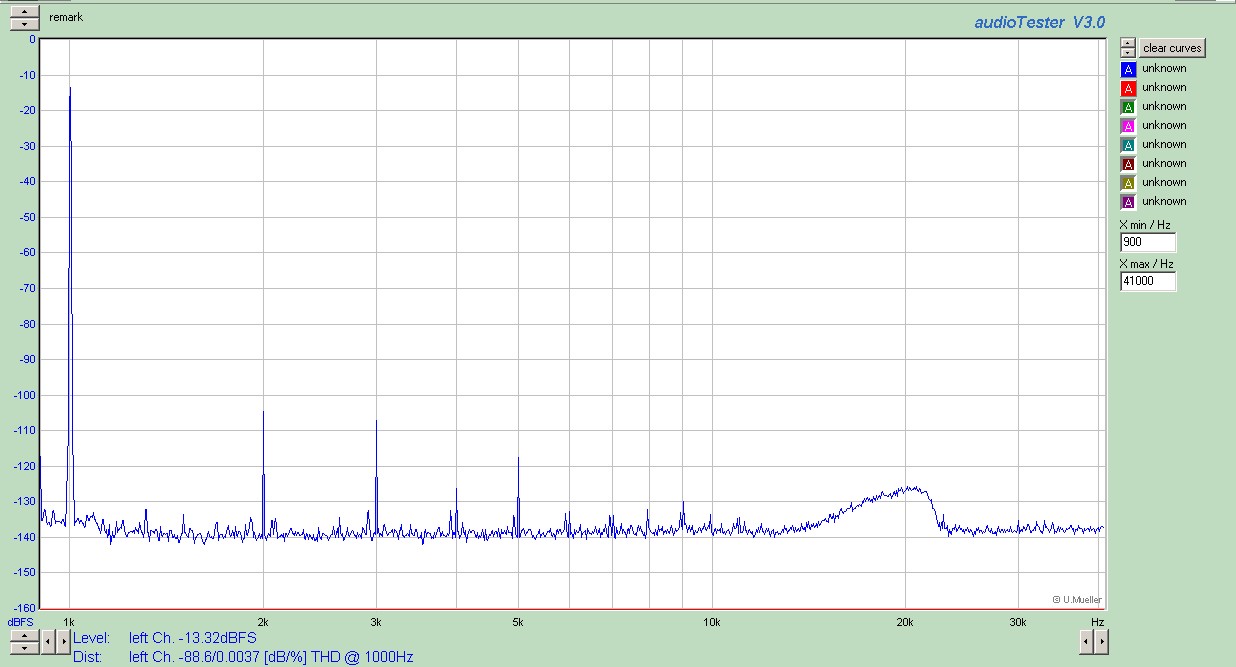

Regarding firewire interfaces/soundcards, I believe you should take a look at the Metric Halo LIO-8, or ULN-8 if budget allows.
Yes, and the optical-out from the MacMini has lots and lots of jitter, thanks to the switching power supply and all the other digital noise sources inside the computer. The better-quality asynchronous USB-to-S/PDIF converters effectively become the "master clock" for the entire digital system, sending commands to the computer when to speed up or slow down the data flow. Although S/PDIF is hardly perfect - far from it - at least the S/PDIF source no longer has to contend with jitter from motor noise and laser servo-correction circuits.
Unfortunately, every DAC I've heard in my system is sensitive to jitter - including the Berkeley Alpha DAC, which probably has the most advanced jitter-reduction circuits out there. Yet you can still hear what the transport and cable are doing to the DAC.
The more exotic tweaks for the MacMini include replacing the spinning disc drive with SSD, which probably quiets down the jitter quite a lot, although optical S/PDIF is the lowest-quality transmission protocol thanks to optical scatter in the fiber.
I'm currently looking at the Audiophilleo and Halide Designs converters, which both claim impressively low jitter specs, as well as garnering good reviews on sites like Computer Audiophile and elsewhere.
Part of the reason I'm kind of a bug about jitter is the Monarchy DAC was dramatically improved - to the point of sounding like a completely different DAC - when I switched from my cheapo Pioneer DVD player/transport to the heavily tweaked and SuperClock II modified Denon 2900. The system went from being thin and bass-light to subterranean bass, along with a much sweeter overall presentation. All from changing transports, which is quite a comment on jitter.
