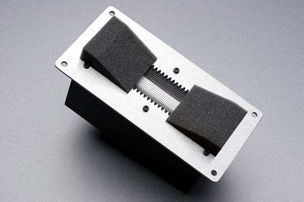

Hi BudP,Romy the cat would also claim that the Raal ribbons are superior to a horn tweeter, even a legendary TH 350, with EnABL on it,
As you know, Romy uses the "teardrop" high frequency ribbon made on special order from RAAL (pic 1). The teardrop ribbon is only 0.2" wide and optimized for the 8KHz Xover Romy uses.

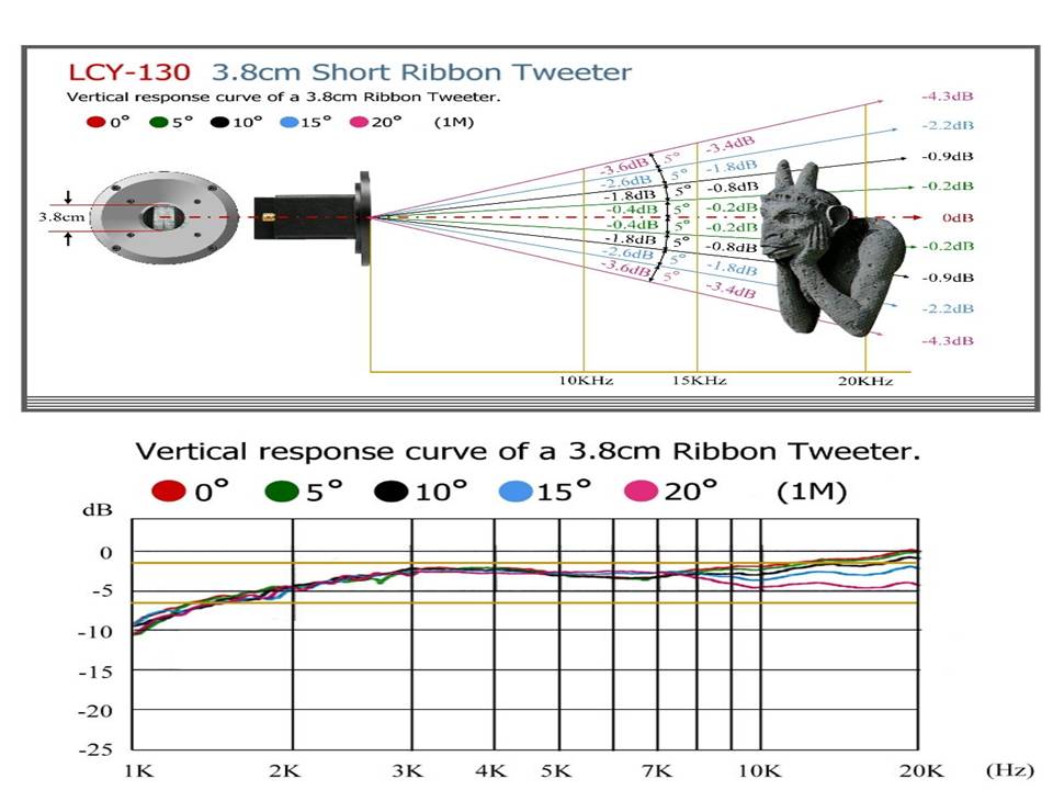

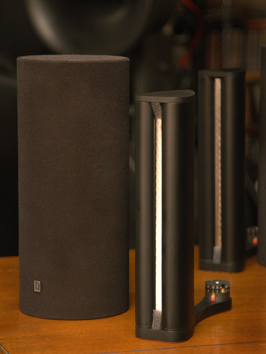

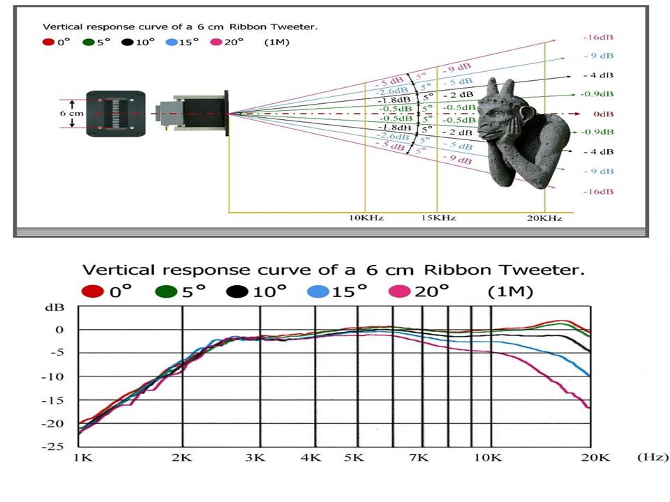

RAAL's production 140-15D ribbon is 0.6" wide (pic 2) and designed for a LR4 slope at 1,600 Hz (pic 3). This seems low enough to cross to a high'ish efficiency 8" or 10" midbass. RAAL's measurements show this ribbon can reproduce 30K-40K Hz super sonics, and reaching these frequencies is an important spec to RAAL.
What if we built a ribbon that used 1" - 1.2" wide and 2" high Al foil to maintain efficiency of 100 db/watt with a 20KHz maximum frequency. Would this ribbon design be "better than" a compression+horn tweeter for horn challenged homes?
