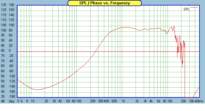

To sum up, the OT12 is a rear-vented horn with a throat approximately 8.5~9" high (the top and bottom are circles that follow the outline of the cone) and 4" wide. The mouth is 15" high by 22" wide, and the horn portion is about 10" deep. If I'm reading the tea leaves correctly, it is a short conical horn that covers the range from about 200 to 1600 Hz, and uses the broad peak of the Helmholtz resonator of the rear chamber to fill in the range from 100 to 200 Hz.
A scaled-up version of Michael's 2-dimensional horn wouldn't be all that different than the OT12, which has most of the horn expansion in the horizontal plane. The OT12 is a simple, straight conical, while Michael's has the distinctive JMMLC contour. Choose a high enough T ratio, and the JMMLC starts to have the slow rolloff characteristic of a conical, with presumably less diffraction at the mouth, thanks to the inherent round-over.
Not thinking I'm a dedicated horn expert either - as I approach the topic solely from the side of diffraction alignment and sound field consistency – I did a BEM simu for you for some further exercises in reading the tea leaves...
The plots show a simu of the OmniTop 12 in horizontal cut – with an arbitrary 12" cone used.
The polars are talken at 1m distance at 0 10 20 30 40deg
As AxiDriver can not simulate rectangular shapes (there is a Beta that should do – but I haven't tried) results may be taken with a grain of salt.
The only conclusion I can draw from above simus are that it seems to be a save bet that Bill's design is *not* dominated by the horn contour (quite in contrary to the Dipole Horn of mine you are referring to).
At least if you compare with the measurements and also with Bill's simu at
http://www.diyaudio.com/forums/multi-way/100392-beyond-ariel-127.html#post1956469
So I'm rather sceptical if there are benefits if you try to improve with a JMLC contour...
For the frequency range of your interest it would become a pretty big animal anyway – if done "right" (JMLC full size horn).

To complete
above plots show the simu of the OmniTop 12 in *vertical* cut
same restrictions and conclusions as above
Michael
Michael
If both sims are for the same horn, shouldn`t the on axis curves be identical? Am I missing something?
Sorry Peter
I should have been more detailed for the ones not familiar with AxiDriver.
The plots show *two* circular symmetric horns simulated with the contour of the horizontal and the vertical cut of the OT12 respectively.
So its not - as one may assume from my poor wording - a vertical and horizontal cut from the *same* simu (AxiDriver only alows for axisymmetric contours to be simulated).
This was of a lesser problem than I actually though - when I simulated my cylinder wave horn - so it might do here as well .
One would have to impose the horizontal and vertical figures one over the other 😱 - more or less ...
Michael
So... no HOM and nasty diffraction effects in this design? The pressure plots look quite.. well.. homogeneous..
Actually, HOM I see as a chapter that is closed.
As for "nasty diffraction effects" this is not related to horn contours only IMO.
Quite in contrary - basically all and everything we do in audio is highly related to the topic of "nasty diffraction".
I opposition to most, I love to see the challenge being *not* avoiding diffraction – which to me is a silly thing, as "diffraction" *always* occurs in all but very rare and academic cases.
Even more – "diffraction" usually is always the same – given any piston like speaker radiating into 4PI after some distance – its simply 180 towards each side - to finally fill the whole room/space available.
The really interesting and challenging point is to *align* diffraction – meaning to set the points of diffraction in space so as to conserve a maximum of sound field coherence.
This is why I brought up the term and idea of "min phase horns" ...
(well, some others help in this...)
Michael
