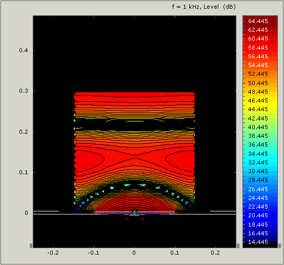

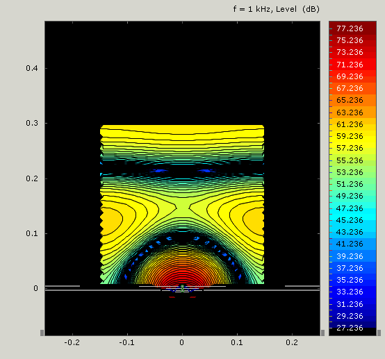

Some AxiDriver demonstration.
Note that the pressure gradiant and pattern difference.

These graphs show the pressure distribution of an area excited by different pressure wave front shape as occurs in different directivity for a single frequency. Each contour line is an equal-pressure line. since this area is a square area, the modes in two directions would be the same. So what we eventually see is that if the pressure wave front is like emerging from a point source, then it starts to excite the lateral mode; if the pressure wave front is like emerging from a piston source, the the lateral mode is not so easily excited.
