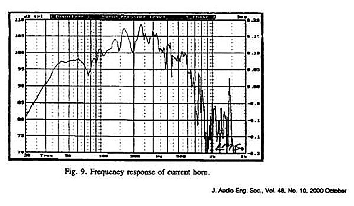

Anyway, a latter day Klipschorn plot:

I took the liberty of post-processing the Klipschorn graph that GM posted, and it appears to be the basshorn by itself (the highest frequency, if I'm reading it correctly, is 2 kHz).
There's a sharp dip at 75 Hz, a peak at 140 Hz, a cancellation dip at 150 Hz, a peak at 165 Hz, another cancellation dip at 200 Hz, the highest peak of all at 230 Hz, and increasingly ragged response above 300 Hz. All of these consistent with a horn with multiple folds in the acoustic path.

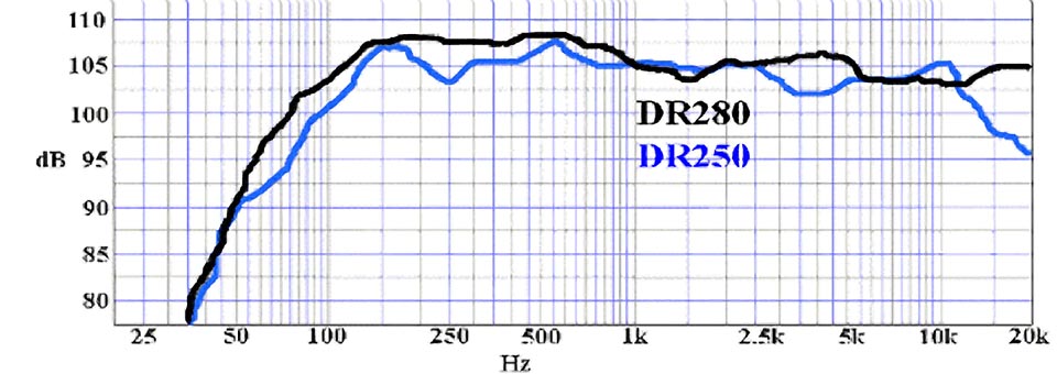

By contrast, the gradually curved Bill Fitzmaurice DR280 appears much smoother (although we don't know how much smoothing BFM used in his chart). Still, it is nothing like the wild roller-coaster of the Klipschorn or the Altec A7.
The folded-horn nulls at 75, 150, and 200 Hz are not really equalizable, since they are due to acoustical multipath cancellations within the folded horn. Trying to increase the level of these sharp dips would merely raise distortion at those frequencies, and not do much for the null itself. If you used parametric or digital EQ to remove the peaks at 140, 165, 230, and 300 Hz, it would help, but the overall response would still be pretty rough, and the time-domain response would still be very poor, thanks to all the reflections within the horn.
The biggest problem for the Klipschorn is going to be the basshorn/midhorn crossover. The basshorn is a mess above 300 Hz, while trying to "stretch" the Klipsch midhorn all the way down to 300 Hz is going to cause gross "honking" colorations. Entirely aside from the questionable performance of the folded basshorn, finding an appropriate midhorn to meet it is not going to be trivial. Even a massive Altec 1505 multicell with a 288 driver is going to be working well outside Altec recommendations, much less the dinky midhorn PWK chose for the K-horn system.

It seems very odd to me that you've gone to the bill fitzmaurice designs. Nothing against them, but they're fairly rough, designed to provide sensitivity and high output as the #top priorities, as well as the ability to be constructed almost entirely with a tablesaw, where we will absolutely see some significant artifacts that can be avoided with a more focused (pun intended) design. We don't need max output, we need max linearity and S.Q. They're also diffraction-heavy compared to the Geddes and LeCleach options.
It's odd that you're focused on his graphs, too, which are single-position and heavily smoothed, vs. the SOTA horns/waveguides previously under discussion.

These are funny comparisons regarding the Klipschorn. That graph was neasured in (quasi) 1/8 space loading and I don't know about the other. But the real issue is the The Klipsch graph has little or no averaging. The other certainly does not appear to be "raw". It is not a real comparison.
Two points I wanted to make. First, the roughness in the repsonse (which is how raw data usually look) may be due to to multiple reflections in the horn or it could be due to a inadequate mouth size. In this case the "impedance transformation" is incompletely accomplished by the horn and a portion of the waveform is reflected back into the horn rather than being transmitted. But you already know this, but others may not.
The second point is that graph is taken from the JAES (2000) article by Delgado & Klipsch. In it a newer bass horn is presented (with performance measures) that show a much better HF extension (about 40 Hz to almost 1000Hz). This is remarkably better than the original Klipschorn. Additionally it has better efficiency and lower distortion. All this done with a comparable footprint.
I guess some progress has been made in the decades since the Klipschorn was first designed. Gviven some of the other comments made above, I would encourage folks to realize the graphs in that article are "honest" ones, with a minimum of smoothing. Unfortuntely folks are freqeuntly not used to seeing the various bumps that do occur in real speakers with real measurements.
I do encourage you (collectively) to read the JAES article. It is a remarkable achievment from someone who made a significant contribution to audio. One that has stood the test of time (in spite of the various bumps in the graphs and using some economical descisions in the choice of drivers etc).
