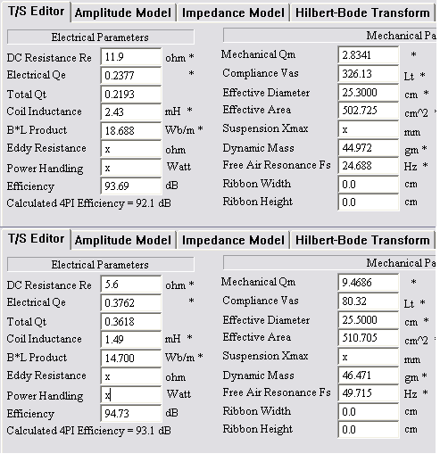

OK, on a more serious note, yes, I've been thinking of the 414 option, comparing the Deltalite-II 2512 and Kappalite 3012HO specs to the Altec/GPA 414.
Looking at Augerpro's measurements (the GPA 414 is at the top), the compliance (Vas) is radically different, but the cone masses (a critical parameter) are pretty close, at 45 grams for the GPA 414, and 46.5 grams for the 3012HO. BL (another critical parameter) is 18.7 Wb/meter for the 414, and 14.7 Wb/meter for the 3012HO. Both drivers have a rising response above 500 Hz, a requirement for the horn. The Alnico 414 might need slightly more clearance for the magnet, and bolt-circle diameter might be a little different as well. The side-mounted vents (which double as cabinet handles) would probably have to be re-tuned for the 414, which would alter the level transition region where the short horn rolls off and the vent output takes over (180~250 Hz at a wild guess).
The 414 variation looks do-able to me, assuming you measure carefully and are willing to twiddle with the complex relationship between the horn and the vented box. I don't think BFM would be appreciative of hand-holding e-mail requests to re-design his cabinet, though - the forums on his site keep him plenty busy, from the looks of things. I am very appreciative he doesn't keep the details of his horns a big unmeasured secret, unlike so many other horn designs from the past and present. Just try and find frequency-response measurements of the Altec A5 and A7, the Klipschorn, Belle Klipsch, or La Scala, or the modern Avante-Garde Trio, for that matter.
I have the full set of BFM documents, and for the OmniTop 12 the optimal T/S specifications are: Fs of 45 Hz, Qts of 0.35, and Vas of 100 liters. The recommended drivers are the Eminence Basslite 2012 (lowest-cost option), Deltalite-II 3012, and the premium high-power options, the Kappalite 3012HO and Delta Pro 12. The passive 2nd-order lowpass filter for the woofer creates 2 dB of peaking in the 1.6 to 2 kHz range, in order to meet the 2 kHz crossover of the piezo array (which I will not be using).
The design of the DR280 curved horn is fascinating, and I can see why it is rated as a "difficult" build. The range of recommended drivers for the DR280 is more restrictive, with the Deltalite-II 2512 (fs=37 Hz, Qts=0.39, Vas=147 liters) being the first choice, and the Kappalite 3012HO as a premium option, with 2 dB higher midrange sensitivity than the 2512, and 450 watt power handling. (The comments in the BFM forums indicate the DR280 is best used with fairly strong active EQ, in the form of the well-known Behringer device.)
