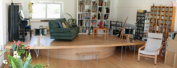

What about a Le CLeac'h bass horn (for what I know at least 5 of them have been built here in France ).
Here are 2 examples:
http://www.diyaudio.com/forums/attachment.php?attachmentid=128826&d=1236807427
http://img383.imageshack.us/i/dsc30511280x768ac0.jpg/
If you have sufficient height in your listening room then it is the perfect solution until 350Hz.
Best regards from Paris, France
Jean-Michel Le Cléac'h

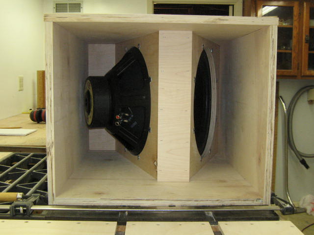

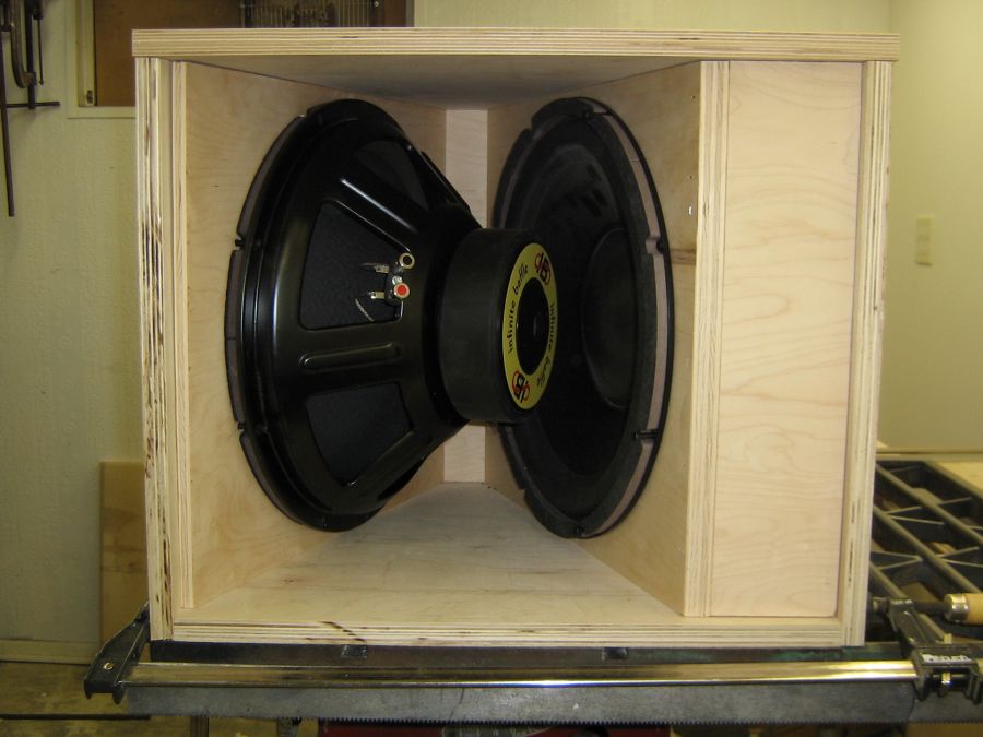

Mr. Purvine, you would need a web-site! 🙂 Or at least a blog. There are to many of your ideas scattered in these forums.

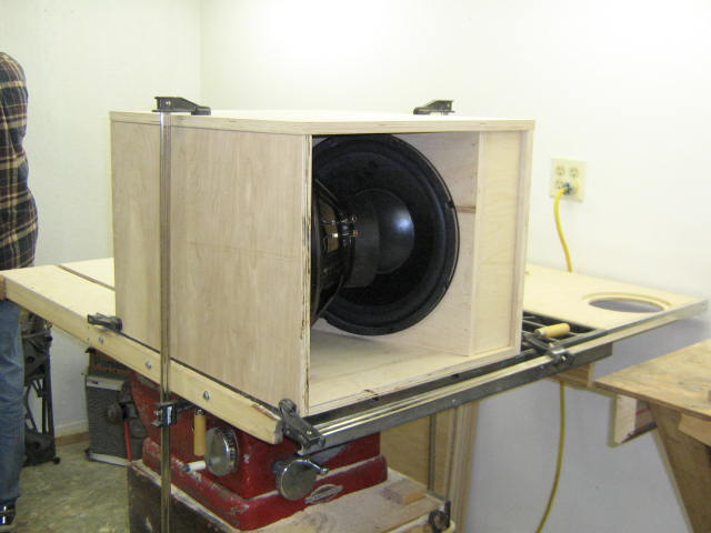

I use MJK's Alpha15a design in a 16" by 16" by 17" H frame, one per side. I measured outdoor (again) two days ago, with 2.83Vrms in, at 1 meter, mic 8" off the ground, a single H frame is 94.5dBSPL sensitive at 50Hz. Add 6dB for the other side, for a total of 100.5dBspl.
cuibono, this is pretty significant... I guess that it would definitely match a waveguide/horn.
Since we are all checking in with suggestions...
I thought the concept with a horn top end, cardioid mid, dipole bass, and monopole sub could have worked well.
Remember Magnetar's system? 5 10'' woofers per side? And it was quite compact also..
Gary's "V-bass" (or whatever you would call it) is a darn good compromise. Not huge, good extension with modest EQ. Super clean. Not an easy build, tho.

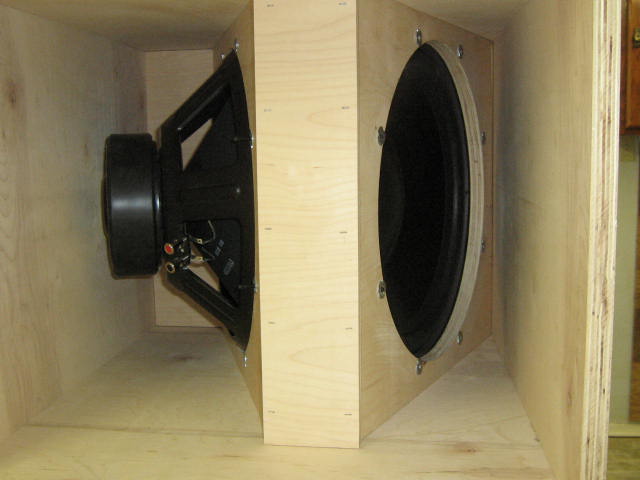

Pano is suckering you guys here. I was there, during a typical Portland thunderstorm trapped in the Columbia river basin. Gary put on a record, as in vinyl, with what he thought was a good rendition of a thunderstorm. The two, inside and outside, were at the same level in the living room, including the house shaking and the window glass obviously bowing. Of course a small amount of EQ and a 600 watt crown amp will do this, but look at the pictures, see if you think it is possible.
And this is clean enough to pick out any bass viol, from an orchestral group and follow it , without strain.
Bud
