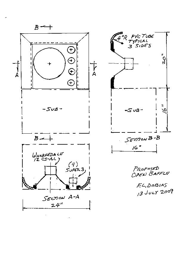

Radiused edges
Telstar,
The attached sketch shows the use of 8 inch diameter PVC tubing cut lengthwise into quarters to provide 4 inch radius edges to my proposed OB.
Ang,
Thanks for the lead to the Beyma CP09 tweeter. It would work well XO at 7.5 KHz. Are you suggesting I should have second CP09's facing the rear on these OB's?

Ang,
While using CP09 tweeters for forward & rear facing sounds like the simplest way to go, I wonder if replacing the rear CP09 (that has a focused output) with the four Super 3 coned tweeters might not provide a beneficial spread of reflections across the front wall. Or is that a bad idea? I see conflicting methods of aiming any rear facing tweeters to obtain a better soundstage.
