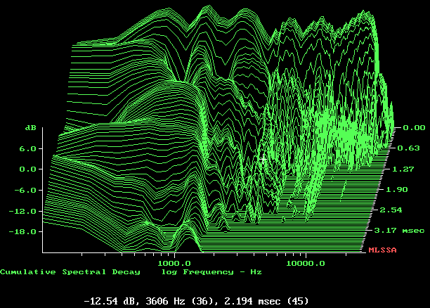

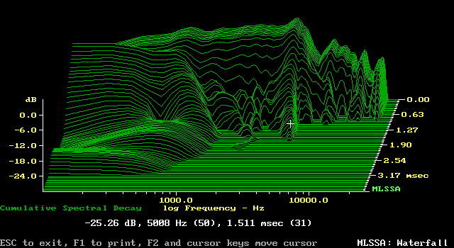

Here's an example from Page Five of the MLSSA Gallery (shown below). It's an Eton 4-203 showing what can only described as perverse behavior - a resonance that starts at 4.5 kHz at T=0 and slides upwards to 5 kHz by T=1.5 mSec. No conceivable RLC network can do this; it takes a mechanical device - like a piano or a driver in breakup - to have resonances behave in this way.
This was a highly regarded driver back in its day. But how would you design a notch filter around a sliding resonance? If it were tuned to the starting point, 4.5 kHz, the resonance would "fade in" after time, an extremely unnatural result. If the filter were tuned to 5 kHz, the resonance would fade in and out, like a very fast shortwave broadcast with lots of multipath skip.
Other breakup behavior, for lack of a better word, looks chaotic, and does not respond to in-band equalization. The tip-off to chaotic behavior is when the waterfall looks radically different when the microphone is moved a few inches to one side or the other. A lot of the "exotic" rigid cone materials have trouble with this - I've seen it with Kevlar, carbon-fiber, and the various composites that get thrown into paper cones.

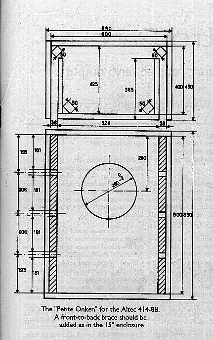

Altec Onken / RCA LC-1A
Dave, why not post or link the dims here for an Onken / RCA LC-1A with the Altec 414 driver for our digestion & DIY and we can proto some cabs for testing...or do you have a mature product availible for this driver & or plan to market one in the near future?

Re: Altec Onken / RCA LC-1A
Unfortunately i have little interest in this driver and at least a solid month of designs & drawings in the queue already. I have discussed the philosopy behind the Fonken design in at least a couple threads... probably the most recent in a thread started by Bigun.
dave

I am quite interested whether you have tried to measure this same driver in a larger room with a longer window.Lynn Olson said:
Lynn Olson said:.... perverse behavior - a resonance that starts at 4.5 kHz at T=0 and slides upwards to 5 kHz ...
Hmmmm.... perverse indeed! Puts me in mind of a funny, small, Chinese gong some guys I toured with had.
It was funny, because when struck, it made a pooiiIIING! sound. The pitch went up! But how? Never could figure that out. Like your sliding resonance, but over an octave, maybe.
A cool sound in a gong, maybe not so cool in a driver. 😛
Hi Lynn,
No argument that if the driver isn't fundamentally a linear device then linear eq won't solve the problems. But the "walking" of the resonances in the CSD don't necessarily mean it is not a linear device. The thing that must be remembered is that when we look at a water fall we are not looking at the decay of a single resonance. We are observing the behavior of a system that can have many resonances all decaying at different rates. Additionally, when two or more resonances are closely spaced we may the summed acoustic output can result in beats giving the appearance that resonances decay below a given level and then reappear.
I would agree that, particularly the second driver you show would not be my choice for a high quality system (and unfortunately it looks a lot like the response of many so called full rage drivers). We are always better off starting with smooth behavior. But the CSD for that driver doesn't imply that the driver is not dominantly linear. This is where digital filtering can be very useful, even if the final objective is an analog crossover (active or passive). With digital filtering we can setup a test with driver and mic at a fixed position, take a measurement of the raw SPL, define the acoustic target the driver will have to meet in the proposed application, digitally filter the driver to that response, and remeasure. Then as I did on my web page, compare the CSD (or any other processing of the impulse) to the CSD of the ideal response. This will give us a good ideal of how "linear" the driver is in the range required for the proposed design. We can then proceed to evaluate the driver through other nonlinear distortion testing.
On other thing, if you look at the CSD's on my web page at the lower frequency range (200 to 800 Hz) you can see there is some walking. However these is no such walking in the eq'ed responses.

Quite interestingly, energy swapping among various frequencies is very common, especially when the diaphragm and/or spider modes get excited. Sometimes if you get the right balance, this can actually help in faster decay.
Very interesting indeed! I always suspected that the gong with the rising pitch actually had the low harmonics decay fast, progressively leaving the higher ones - thus making it sound as though the pitch went up.
I now see that driver can do the same thing, but to a much lesser degree.
Having heard people say that a certain driver "gets the pitch right" makes me wonder is this is part of what's going on.
panomaniac said:Very interesting indeed! I always suspected that the gong with the rising pitch actually had the low harmonics decay fast, progressively leaving the higher ones - thus making it sound as though the pitch went up.
below an example that possibly could illustrate just that (again driver in enclosure):
compare the resonace at slightly below 200Hz with the one at roughly 300Hz.
You'll notice that stored energy at 300Hz initially starts lower in SPL but has *much* less decay than the resonance at slightly below 200Hz.
After the 37,76ms shown, the ~200Hz SPL already has dropped to half the SPL level of the 300Hz resonance
Not sure however that masking effects due to different decay times are the main reason for the behaviour of your gong example.
Closely listen to the pitch when you pluck the guitar - the tone clearly turns higher during decay.
Its more form the nonlinearity of the string at different tension (at excursion) I guess.
If the same happens with the spider of a speaker the main resonance would shift like in Lynn's example.
The decay shift form the Eton speaker must have an other reason IMO, as its harly dominated by spider nonlinearity at that high frequencies.
