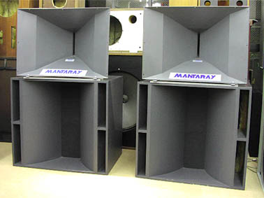

Update for those patiently waiting for 425 horns: Flanges now mostly cast and drilled. Remains to finish, then pack and post.
This is a batch of 7 pairs. Normally I only do an occasional pair at a time - but this has led me to make some nice new tooling..
Drilling mounting holes accurately in the flanges has always been difficult - the bit always seems to wander however carefully one marks out, and drills the pilot hole. What works in metal just doesnt apply in calcine loaded resin. So I made a brass template using mini mill and rotary table. A spigot locates in the horn throat. A pin prevents the template from turning. A central clamp locks it down. Drilling flanges is now 10 x as quick, and accurate every time.
martin

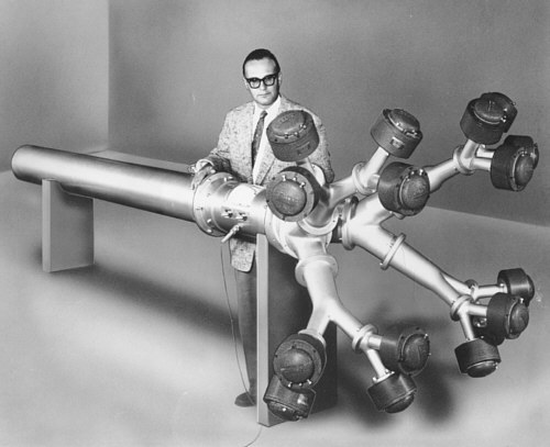

A rather frightening application for the 288's! Looks a NASA or military test setup - maybe to emulate the SPL's of a rocket launch. Some of the early rocket motor failures were due to extreme sound pressures destroying components like turbopumps and piping. It's an extreme environment any way you think of it - liquid hydrogen and oxygen, near-plasma temperatures coming out of supersonic exhausts, and SPL's sufficient to destroy many materials in a matter of seconds. The Huntsville NASA team had their hands full designing the Saturn engines.
