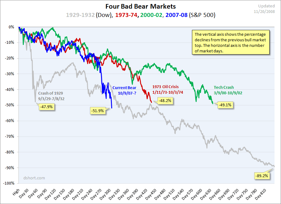

The chart below is from Calculated Risk, one of my daily-reads. I don't personally think we're headed for a Great Depression, but the economic data isn't pretty. If one or more of the Detroit automakers fails, the descent (in the real economy) will steepen.
The real question is where the market bottom is - right now, in January, or some time later in 2009. One ray of light from the recently concluded G20 conference is the agreement on the need for worldwide economic-stimulus programs, preferably in large-scale infrastructure improvements. With any luck at all, the turnaround could be very rapid - there's 12 trillion dollars sitting on the sidelines (parked in T-bills) waiting for conditions to improve. This money will move very fast once the credit markets clear and real economy shows signs of turning around.

Thanks for sharing this plot, Lynn – nothing could proof any better that market crashes are intrinsic part of today's "science of economy".
