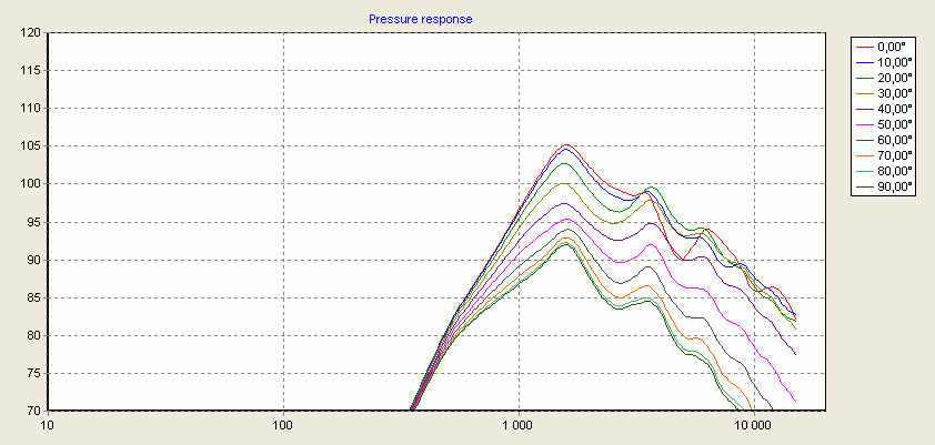

OSWG BEM simulation
Hi Earl, all,
It took some time, but I finally got around to run the BEM simulation of the OSWG with driver internal flare and mouth radius.
After looking at the PWT response of Beyma CP380M, I modified the parameters of the DE250 a little. The parameters used in the simulation are:
Sd: 15cm2,
BL: 7.5Tm,
Cms: 2.0 E-5 m/N
Rms: 1.0 Ns/m
Mmd: 1.2g
Le: 0.025mH (measured inductive part of impedance of CP380M at 15kHz)
Re: 6.3 ohms.
Front chamber: 0.75cm3.
The internal flare starts at 1.5cm2 (10:1 compression ratio, fairly typical), and is conical with a wall angle of 6 degrees to a 1 inch exit, giving a length of 5.51cm. This is perhaps a little long, the compression ratio may be lower.
The OSWG has a throat angle of 6 degrees, flaring to 45 degrees, and is 5.7 inches long. It is followed by a radiused mouth, 4 inch radius, ends at 90 degrees.
BEM frequency sweep 300Hz to 15kHz, 150 points.
The waveguide is placed in an infinite baffle, for simplicity. Field points are at 3m distance. Driving voltage is 2.83V.
Attached is the frequency response with driver at different angles. Does this resemble your measurements, Earl?
It would in any case be interesting to see a frequency response measurement of your waveguide with driver, without the crossover. Also the electrical impedance would be interesting to see.
Bjørn

Re: OSWG BEM simulation
Bjorn
Thank you very much for this. From your data I am assuming that the mouth of this waveguide would be 10", my smallest. I have data for this device and I will post it as a comparison, but I should also say that this waveguide is the worst of the bunch being just too small. The 12" and 15" devices are much better. But at any rate I'd have to say that you have achieved all of the pertinent features that I find. First the constant directivity, and the -6 dB / oct HF loss is typical. The lowest resonance peak is "tamed" by the HP filter and the next one, which I don't typically see this strong (but I use foam remember) needs a second tank circuit to control. The hole on axis is now quit accurate.
I'll dig up my data and post it.

Here is my data for the Nathan 10" waveguide with a DE250. We mostly agree, but the bump at LFs is not in your data. This is likely due to the throat and the gap in front of the diaphragm not being correct.
There is clearly more damping of the resonanaces in my device, this could be the foam, but, in general, I don't find the foam having that much of an effect. Perhaps the driver has more Bl than you have used. I'll dig up an impedance curve and post it too.

Although to be fair the manufacturer measurements are taken in full space in a 30L box. This is in comparison to other manufacturer graphs some of which are taken with infinite baffle.
It has a rising response with little midbass; which can mean its range is actually not very wide. This is unless you use a wide baffle which can make it usable from around 300hz. Although the cone at first impressions from the graph is good and minimal breakup. Its 10 inch size is very deceptive. Take note its Xmax by the simplest definition is 0; the manufacturer uses a diff formula.Originally posted by CLS 10NDA610 is fully equipped: strong motor, light cone, extremely low inductance. So powerful in such a wide range!
Thanks for attention. I've noticed its rising response, too.
And also, I'm still confused by such "evaluation". The results are quite different from what I've experienced (subjectively). So it'd probably be something wrong (or lackings) with the table🙁
By the way, 250Hz was picked because of many smaller drivers are affected by their low end resonant peak of impedance at slightly lower frenquency than this. Say, some drivers actually ride on the half way towards their peak at around 150Hz. So I can not take that frequency (or lower) to calculate their actual impedance by the Re and Le. Around and below this region, driver's behavior is dominated by other things instead of inductance.
So in the end, this seems all in vain. Or I need many more other factors to make it right.
