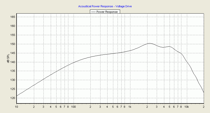

Bjorn - I checked on the moving mass and that was a typo, its more like 1.2 grams. Compliance would then be about 2 x 10^-5. See if those numbers work better. I got the flux data from the B&C website and that number is just the flux density not BL. BL would be more like 18. Sorry for the mix-up.
Thanks Earl, that looks better.
I attach the resulting lumped parameter PWT simulation resulting from this. Does it makes sense?
I have included an internal driver flare, per your suggestion 2 inches (5.08 cm) long, 2.54 cm exit diameter (S=5.07cm^2), and a 1:10 compression ratio, giving a start area of 1.5cm2.
Bjørn
Bjørn
Looks perfectly reasonable. I am sure that those driver parameters could be tweaked a bit, but this is a first cut.
The high end drop is no where near as seveer as shown, but that could be a lot of things. Its probably not lumped parameter up that high. And the inductance could be lower - lots of things.
