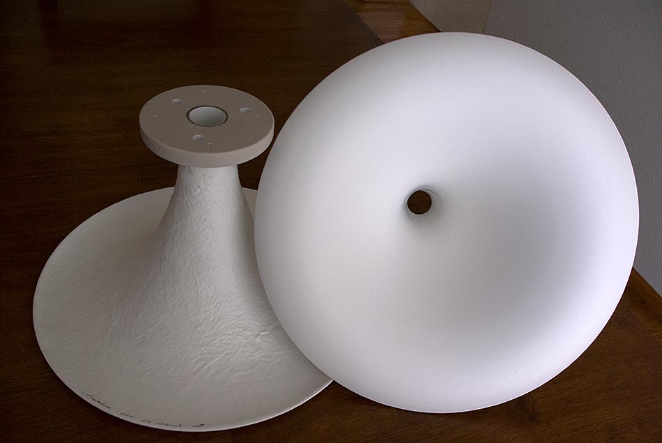

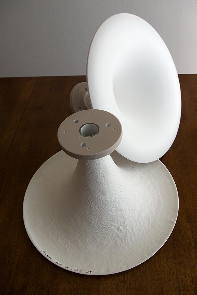

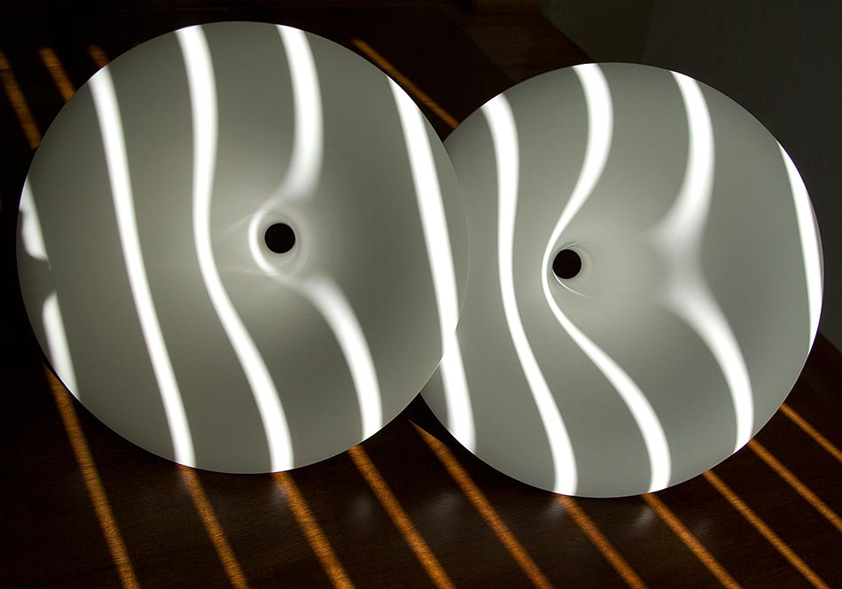

These things aren't easy to photograph thanks to complex internal contours and the silky-smooth internal finish. It's not glossy, but more of a satin finish, with a silky texture that is hard to describe. The junction to the compression driver looks perfect as far as I can tell, no burrs or flaws anywhere.
They're not as big as they look - they're actually kind of petite. Karna approves the looks, and so do I. Very elegant and classy looking, and also surprisingly rigid and solid. Much better made than the commercial horns I've seen, no burrs or flashing, and the rigidity is better too.

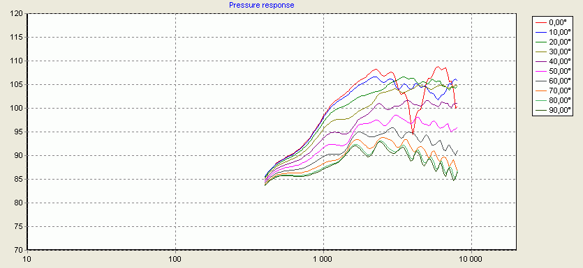

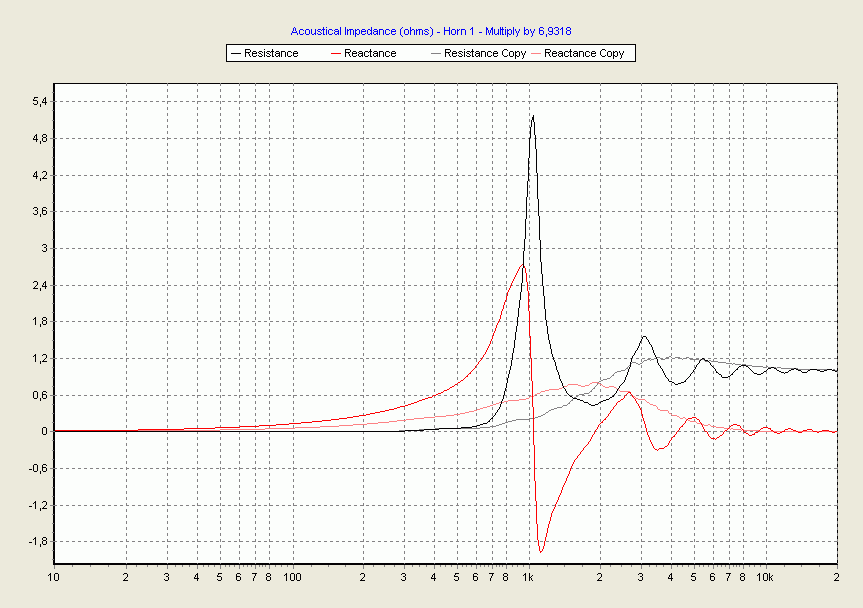

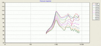

soongsc said:
After looking at the data and reading the articles you have written, I can't help but wonder how things would look for an OS wave guide with a tube section before the throat would perform. Would very much like your opinion.
Not too good, I'm afraid. Attached is a simulation (simple model, not BEM) of a 90 degree included angle OS WG coupled to a 288B internal flare, compared with the wave guide by itself (in grey). The driver internal flare frequency is about 200Hz, and is not well terminated by the wave guide until about 2kHz. This causes quite strong reflections.
A conical horn would look similar attached to the 288B, but the ripple would be worse than for the OSWG above 3kHz or so. The change in flare rate at the driver exit is quite abrupt. Although it is less for the OSWG, in effect the problem is just moved a few cm towards the mouth.
For the record, the wave guide is placed in an infinite baffle, and does not have a radiused mouth. It has a throat diameter (not counting the driver internal flare) of 35.4mm, a mouth diameter of 375.4mm, and a length of 186.9mm.
A BEM simulation is currently running, to check the predictions of the simple model, and to see if there is any change in the directivity pattern between the waveguide alone and with driver flare included.
Bjørn

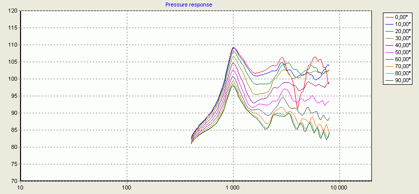

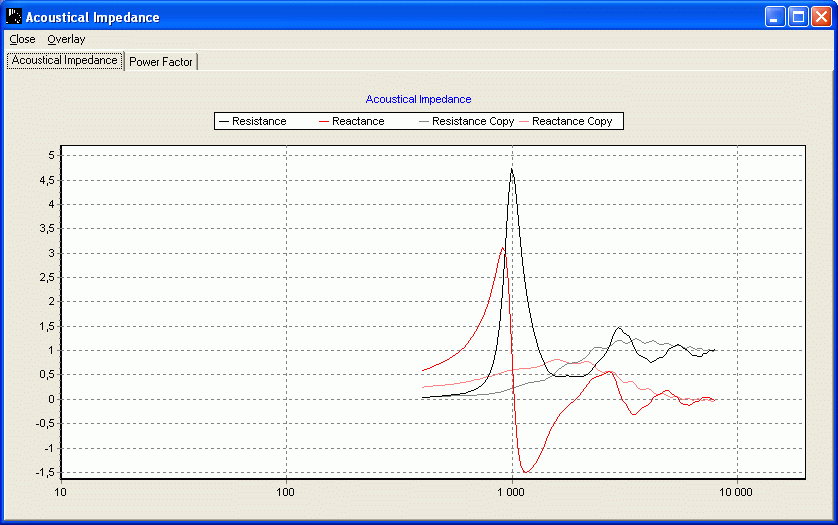

Here is the on-axis frequency response for the two combinations, the red line is including the driver flare. Flat wavefront at the troat, uniform throat velocity of 1m/s, field point distance 3m from mouth.
Including the driver flare gives better LF response, but the cost is the powerful resonance at that frequency. I would not call this an improvement.
Bjørn
