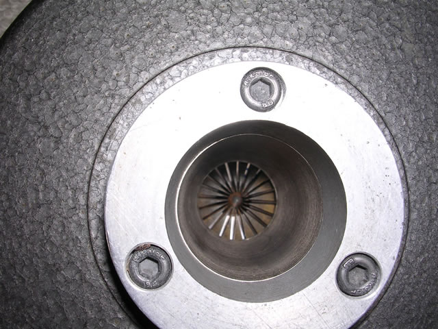

"these are some of the first 288 Alnico/Henricksen phase plug models made in 30 years"
They sure are nice looking

what's the difference between this hendricksen phase plug and the phase plug seen here
rank 379 driver
and
cogent driver
rank 379 driver
and
cogent driver
Well, this is Steve Schell's area of expertise more than mine, but the 1939 Blackburn patent (2,183,528) is one of the earliest instances. I believe this was used in the WECO/ERPI group, but I could be wrong, it might have been used for RCA instead. There were a lot of patent-sharing agreements at the time.
Here's the original 1978 Henricksen AES Paper. Interesting paper, but the frequency response comparison at the end doesn't look too flattering to the Tangerine. What complicates the comparison are the known irregularities of the horns of the day, and the breakup of the aluminum diaphragm.
Here's a lively quote from Todd W. White (Iconic), posted May 13th, 2001 in the High Efficiency Speaker Asylum forum:
In contrast, my audio-friend John Atwood heard a direct comparison between the circumferential and the Tangerine versions of the 288, and he strongly preferred the Tangerine, even if the Tangerine version used a ceramic magnet, and the circumferential used Alnico. (The Alnico + Tangerine version of the 288 was only in production for about a year, thus the rarity and high price on eBay. The ceramic versions were in production much longer and are easier to find.)
John felt the circumferential versions were "phasey" sounding in direct comparison to the Tangerines, which makes sense to me. As mentioned in the Henricksen paper, circumferential phase plugs only have a few discrete paths - typically 3 or 4 - from the diaphragm to the entrance of the horn, and I would expect sum-and-difference cancellations to appear at narrow, discrete frequencies. These narrow nulls might not look significant in a 1/3-octave smoothed frequency response graph, but they would be much more apparent in the time domain.

The TANGERINE Radial Phasing system was developed by Clifford Henrickson in the late '70's while he was at Altec. It was designed to be an improvement over the circumferential system designed by Western Electric and used in WE and Altec HF drivers until the advent of the TANGERINE phasing plug (Acoustic transformer).
HOWEVER - John K. Hilliard's group at MGM had James B. Lansing Manufacturing build the "Shearer Horn Loudspeaker System" when WE couldn't deliver the "Mirrorphonic" quickly enough. Interestingly, Hilliard's book (I have his personal copy in my possession) describes the circumferential method as SUPERIOR to all others, but it was difficult to build with the tooling and materials of the day, so the radial-style system was used instead. It was described as being an accemptable compromise.
Indeed, Mic Dickinson reported that when Henrickson and Altec were touting their "new" invention (the TANGERINE radial phase plug), John Hilliard, seated amongst other audio pioneers assembled at the time, reached into his briefcase, raised the book into the air, and said, "Gentlemen, gentlemen - it has all been done before!"
And he was right.
The large-format Altec 288-series HF drivers developed a "dip" in the 10 kHz region when the TANGERINE phasing plug was introduced. They never could get rid of it, but were STUCK with it, anyhow. Jerry Hubbard designed a new one, but the folks at Extra-Vicious wouldn't allow it to be developed, seeing as they didn't (and don't) know how to design one themselves.
Proof of the real difference is when you listen to the 288-8G next to the 288-H. THe only difference is the phasing plug, and you CAN hear the difference. The G sounds better!
Others have tried to design better phasing plugs, but to no avail. The most annoying-sounding example is JBL's "Incoherent-wave" phasing plug, which is a poor knock-off of the TANGERINE.
Now, don't get me wrong - ALL of the Altec 288's sound BETTER than ANY other large format drivers out there, it's just the G and before DO sound better than the ones that used the TANGERINE.

The 288's used circumferential phase plugs from 1945 through to the mid-Seventies, when Altec changed over to the Hendricksen-designed "Tangerine" phase plugs, which continued to be used until the demise of Altec in the Eighties/Nineties. As mentioned earlier, there was a brief period when the Tangerine and Alnico magnet technologies overlapped, thus the relative rarity of the 288-H models.

I also agree with John Atwood. The radial phase plug is the better design. If you take a step back and really look at the circumferential phasing plug, only a few (3 to 4) places on the diaphragm have a straight path to the throat of the driver. However, the various different radius based frequencies always have a straight and unobstructed path to the throat with the radial phasing plug. I believe this is why the radial phasing plug has a smoother, non-phasey harmonic signature to it. It is more harmonically complete. The sonic textures are more natural and realistic with the radial phasing plug. It really is a no brainer.

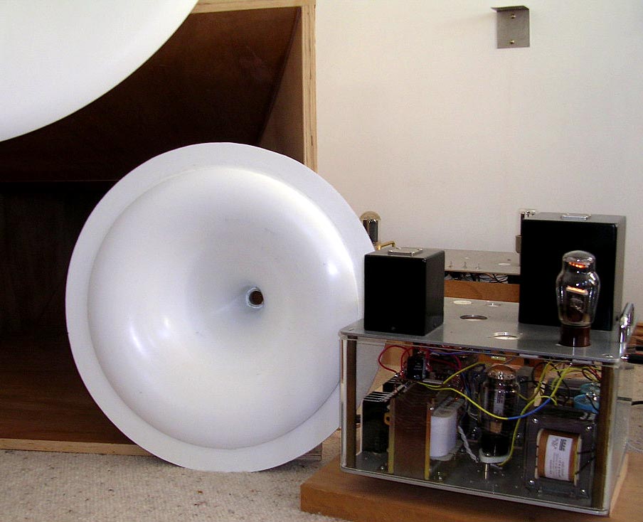

Three-way
Hello Lynn
Your e-mail has got me pretty fired-up about a three-way using the GPA 288 alnico as the basis of an OB project .
You recently wrote :
"I can now reveal that there will be a new AH-425 Azurahorn, commissioned for this project.
Specifications are: 425 Hz cutoff, T = 0.7071, throat size = 35.4mm (actual measured size of an Altec 288), internal flare rate of matching compression driver = 8 degrees, overall diameter = 418mm, length from front of horn to back of mounting plate = 262mm, diameter as measured from the portion that is at 90 degrees with respect to the central axis (the footprint if it is laid face-down on the floor) = 364mm."
Is this still the state of play ?
If so I might consider getting drivers and horns soon and kick this project off . I will still talk to John A as you suggested .
Now, I'm just unsure about whether 16-ohm on the comp drivers is the way to go . I'll just be running a single 15" of some sort as the bass unit - I can't go for an all-out solution like yours in the space I have at home . Your comment about using a transformer step-down to match-in the horn leaves me a bit unsure about which impedance would be most versatile ...assuming the GPA 288's come in anything other than 16 ohm of course !
Mark

I took the first female off today - dressed and polished her ready to take to the shop for tooling gel coat. Will lay up production mould next weekend. Should be ready to get some horns made the week after.
In terms of what we can expect from the 288, scroll down to the last picture on Bjorn Kolbrek's homepage, and look at the red curves. That's an Altec 288B in a plane-wave tube, and you can see the reason I'm considering a crossover in the 5~7 kHz region. The Hendricksen phase plug should be a bit better, but most of the improvement will be in the region above 10 kHz (where it most certainly needs it).
These measurements are exquisitely sensitive to the centering of the mounting on to the flange of the horn/waveguide, and a good match between the 207 Hz internal flare of the 288 driver and the entrance to the horn is also essential. Tiny differences in flare rate in this part of the horn/driver system translate into huge differences on the other end, particularly in the time domain.
I've suggested to Martin that he make a 1.4" flared cylindrical centering tool that can be inserted into the horn when it is mounted onto the compression driver, so centering will not depend on the mounting bolts alone - instead, the tool will be gently slipped into the entire assembly, the bolts tightened, and the tool removed. If the tool gets stuck or visibly tilted to one side or the other, well, the bolts aren't centered, and the mounting holes for the bolts might need to be bored out just a little.
