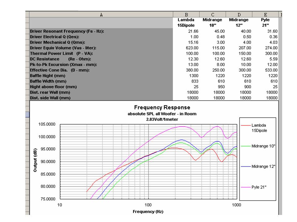

Thanks to Magnetar for the T/S measurements of the Pyle PDW21250 21" woofer. The averaged measurements of four samples are:
FS - 31.61
RE - 5.59
RES- 59.81
QMS- 4.03
QES- 0.38
QTS- 0.34
L1- 1.88
VAS - 274.29 liters
SPL - 95.4
I entered these values into the free XBaffle program, along with some fictional midrange designs which search for the best sounding and most usable dipole midrange T/S parameters.

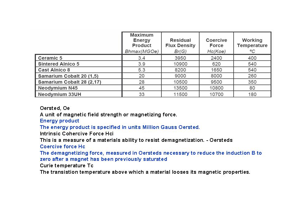

NdFeB has high field strength and good resistance to demanetization. It's weakness is a 180C Curie temperature.
I hope more innovative NdFeB optimized ultimate home audio motors are designed and more golden ears get to review them. Most ProAudio NdFeB designs seem optimized for low weight.
Ok, have a few questions here. I'm not sure exactly what you are comparing in here for dipole as baffle size is 100000mm. You also have different heights above the floor, etc. oh, as I'm typing I see you edited that now... so nevermind. 🙂

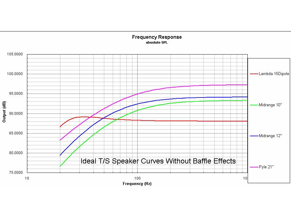

I got the 12 mm Xmax from a German diy website that has been discussing the Pyle 21" for a several months, but even this site also has no official Pyle manufacturer T/S data. I don't trust this Xmax number, and used it to just fill in a blank which has no effect on the shown graph. The Pyle home site has no datasheet. Even inputing Magnetar's measurements into Xlbaffle gave conflicting SPL_watt numbers. Personally I would guess that 12mm is Xmech.. the mechanical limit based upon the photos of the rear motor.. best to wait for more real measurements.
Plot of T/S specs without baffle effects.

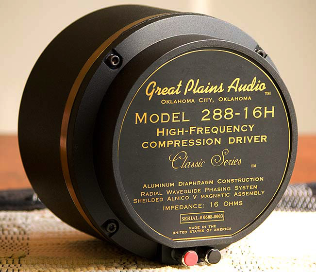

I'll take some photos tomorrow. By the way, they are incredibly heavy, feeling like a solid 20 lb. brick of steel, which in a way they are. With the light just right, you can see right through the radial Hendricksen phase plug, and look at the slightly gold-colored diaphragm. Bill told me this is a thin enamel coating that GPA puts on the aluminum to prevent corrosion.
Still at a loss how I'm going to mount these things, with the right combination of repeatable and precise front-to-back adjustment and secure support of the cylindrical compression driver and the complex shape of the AH-425.

You are not kidding. I was surprised at both the size and weight when the UPS guy gave me these two big boxes of Altec 288. I have purchased the manual linear slide as mentioned in an earlier post. I think it is the best option for precise front-to-back adjustment.

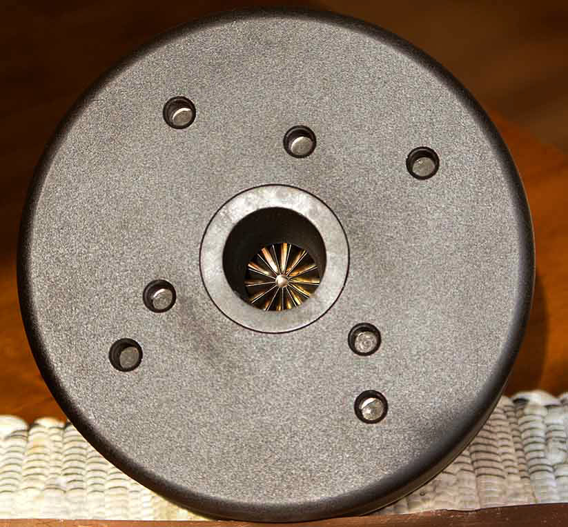

New GPA 288 Alnico Driver - Front View
This photo shows the integral rubber gasket and the dark gray Henricksen phase plug with the aluminum diaphragm behind it. The bolt pattern provides either traditional 3-bolt or the modern 4-bolt pattern for 1.4" exit drivers.
The darkish area towards the lower right of the photo isn't actually on the driver - it's my shadow, since the late-afternoon sunlight is going nearly straight into the driver. The mounting plate and rubber gasket are not actually gray - that is an illusion due to the sunlight creating a specular reflection off the black paint and the surface of the gasket.

Lynn,
Your 288s looks phenomenal !!
I recall reading that you had ordered the 288s with Tangerine plugs. Perhaps I missed a subsequent post about the change to the Henricksen plugs.
Are the Henricksen plugs better than the Tangerine ones?
