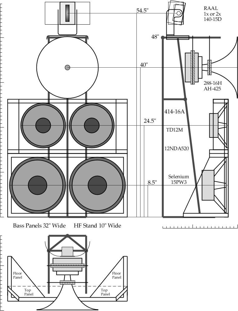

Hi all, I've been busy the last few days. Here's an updated drawing that I'll be showing to the local Northern Colorado woodworkers - I'm still awaiting delivery of several key components, the AH-425, the 288-16H's, and the 414-16A's. The 12NDA520's, the 6ND410's, and the RAAL 140-15D are already on hand.
Thus far, I've spent about US$3000, and I expect to spend another US$1000~2000 before measurements and audition can start. So I'm definitely committed, although I have no idea if it will be completed in time for the RMAF show. Frankly, just moving them to and from the show is such a hassle that I don't feel much incentive to demo them at the show. The last time I took the Karna's to the show, it definitely wasn't worth the effort - the amps nearly got demolished by careless show-goers not looking where they were stepping, and the actual demo lasted maybe half-an-hour. It took longer to move them to and from the show than the time they were up and running.

Lynn, what is your subjective impression of the 12DA520 vs the Tone Tubby (..in the wide band open baffle config.)? Also, how much "time" has each driver "seen", and in general do you feel they are "broken in" sufficiently?
Bummer about the show-goers.

Hey Lynn, I hauled this to a show and although people said it sounded great I thought it sounded like crap. The walls were fake and rattled plus the windows reflected sound all around - taking a beast to a 'show' is something I'll never do This was a heavy system. The subs in the back used four 15's each.
Dipoles would be easy .......😉
Hello Lynn,
I understand you will be auditioning a quartet of 6nd410 drivers. What low-pass frequency do you think would be necessarily to avoid combing effects? 700-900Hz?
I really love the EV Alnico, actually most all the EV 2.5" coil speakers sound really really good. I "borrowed" quite a bit from their cone design I will admit and since those coils are so small they are very wide bandwidth.

speaker alignment
hello Linn
how about a driver alignment as on my drawing ? similar to Jack Bouskas speakers ?
the radiation pattern of the midrange horn is quite wide. The Raal is however more narrowed. So there is a missmatch between these, unless you will use foam.
The OB mid and bass drivers have also a completely different polar pattern and radiation behaviour, than the midrange horn, and Raal tweeters, radiating also backwards. So actually , nothing will match. Specially at the crossover points.
i am wrong about that ?
A direct radiating woofer, close to the floor is very clear audible, where the source is located. Similar to your design. With a row, from the ceiling to the floor, however, the radiation would be much more even , what in my opinion would be preferable.
Angelo
