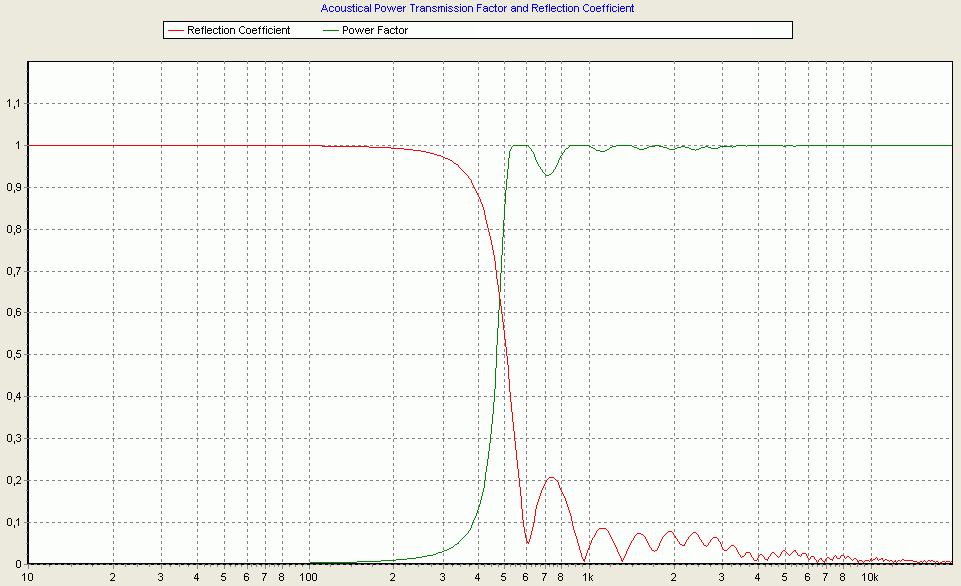

Here is Bjorn Kolbrek's simulation of the radiation impedance of a 420 Hz Le Cleac'h horn with a T = 0.707 and profile optimized for an Altec 288. The green curve on the right is the power factor, or the power admitted into the horn. The red curve on the left is the reflection coefficient, the power reflected back towards the diaphragm. I see this as similar to a VSWR curve for an antenna, showing the transmitted power versus power reflected back to the transmitter.
Now, it is a simulation, and I treat all simulations with a degree of skepticism. But still, it is interesting to look at, and other simulations by Bjorn Kolbrek showed strong reflections when the throat flare of the horn did not match the internal flare of the 288 driver (which is 8 degrees). Very slight mismatches between the compression driver and the throat flare of the horn create surprisingly large ripples in the 500 Hz to 3 kHz response region.

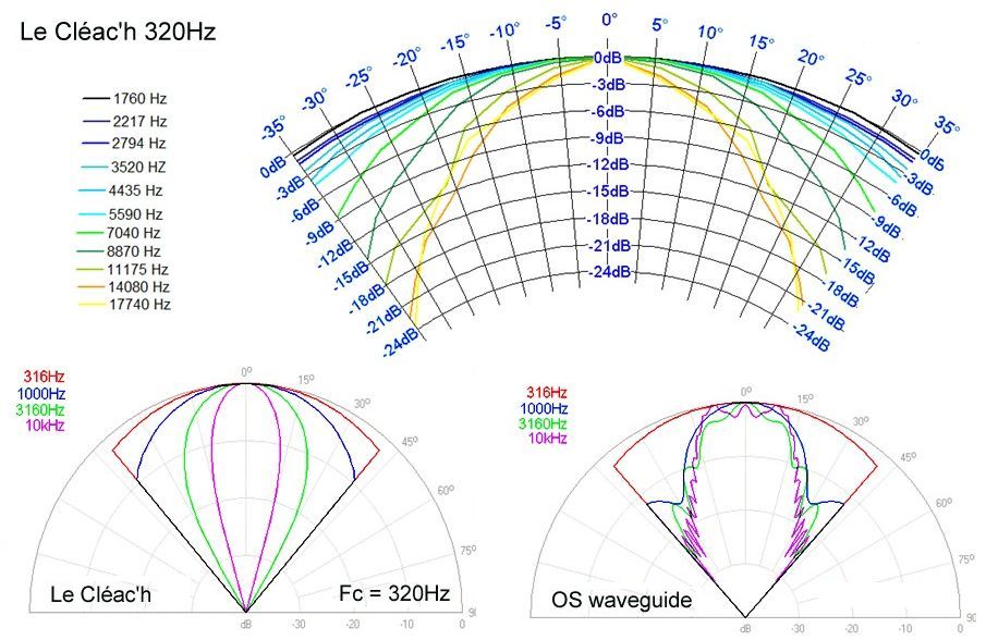

"Here's the measured directivity of a Le Cleac'h 320 Hz horn (top graph), courtesy of the author. The directivity pattern looks very much like a 1.4" to 2" direct-radiator dome-midrange."
Hello Lynn
With twice the DI number for the horn. The included angle 6 db point is twice the horns for a 2 in driver. At 10K you are looking at 80 degrees for the driver and less than 40 degrees for the horn.
Rob
Hello Lynn
Rob
