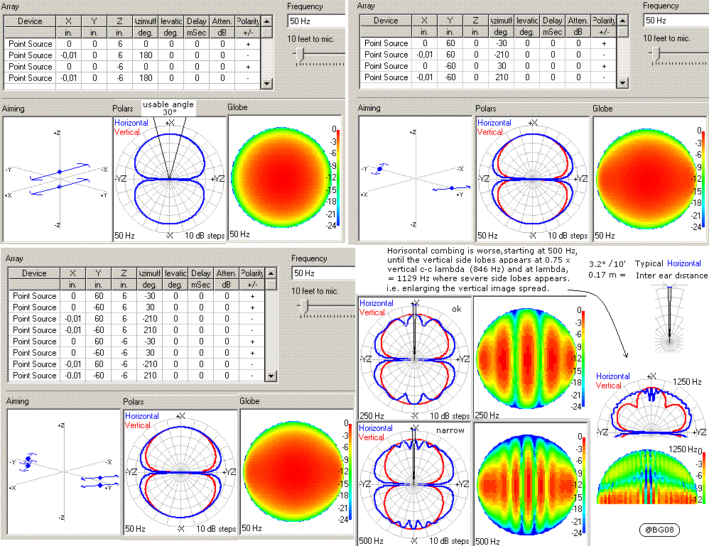

As Brett cautioned,"Once the centre-centre distances are > 0.25 wavelength, cancellation (combfiltering) will occur." I can only say, "Huh?". I admit I'm out of my league with this group's knowledge on the subject.

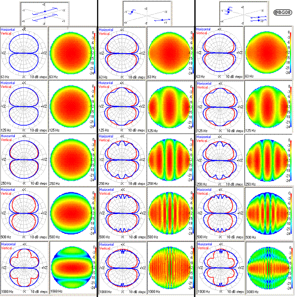

Hi Dobias,
This is something best understood through personal experience.
Set your FM tuner (if it does not mute) so that you can listen to interstation hiss.
If your front loudspeakers are connected in parallel full-range with a centre distance of say 13", where the wavelength frequency is 1kHz, you are going to hear considerable upper-mid and treble level changes as you move your head up and down about their common axis.
With sine driving, these amplitude peaks and troughs will be in different places at different frequencies as you move up and down (comb effect) and be closer together with increasing frequency.
(Or turn your LS on its side and listen to the effect as you walk past it.)
This is why larger loudspeakers are generally not used for mid frequencies - the output from both sides of the cone destructively interfere as soon as you go off axis, thus the HF/mids fall away quite notably. There can also be a central beaming effect unless countered by other aspects of design.
Cheers .......... Graham.

Two 10" to 12" LS side by side are going to lead to notable voice reproduction anomalies for any listening done off-axis, especially with a combining reflected rear wave.
Its not just the centre to centre spacing, but the overall spacing between outer cone edges which will promote frequency selective interferences.
Cheers ........... Graham.
