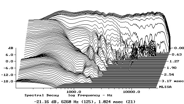

The referenced CSD is about as bad as it can get. Oddly enough, the frequency-response curves (in a separate chart) are quite a bit better, without the horrifically large nulls and peaks occupying the 3~15 kHz region. The two measurements do not appear to be calculated from the same set of impulse data, from what I can see - or the frequency response is very heavily smoothed to remove the nulls. I usually avoid smoothing for first-arrival time, frequency, and CSD data, just so problems in measurement or the loudspeaker can be more easily seen.
One thing about CSD's is the floor reflection must be absorbed by at least 20~30 dB, otherwise the CSD becomes an unreadable clutter. This takes a mixed pile of pillows, cushions, blankets, and winter coats that is at least 60 cm/2 feet high - and more is better. It's easy enough to build the pile - do a series of repeated impulse measurements, look at the magnitude of the floor reflection around 3~3.5 mSec, and keep adding absorptive material at the location of the floor bounce. They may have failed to do that for this measurement, thus the poor results.
Since the raw impulse data is not shown (it should be, just to get a flavor of the time response) we can't tell if the measurement was valid or not. If it is valid (floor bounce absorbed), then the HF time response is quite poor and resonant. The entire region of the CSD is what I would call unusable and beyond the range of any type of corrective equalization. I hope the author's sake the data is simply nothing more than a measurement corrupted by a floor bounce, or another source of reflection.
A reasonably good CSD is shown below - not the best, but reasonably good. You can read the unsmoothed frequency response of the system by looking at the back of the CSD - see how much smoother it is compared to the other system? Note the absence of sharp, narrow peaks and deep nulls, which are never a good sign in any loudspeaker. I consider this CSD to be a minimum standard for a modern high-fidelity loudspeaker - the new system should exceed this standard, I hope, although it'll probably take a lot of work on the compression driver and horn/waveguide.

Lynn Olson said:A reasonably good CSD is shown below - not the best, but reasonably good. You can read the unsmoothed frequency response of the system by looking at the back of the CSD - see how much smoother it is compared to the other system? Note the absence of sharp, narrow peaks and deep nulls, which are never a good sign in any loudspeaker. I consider this CSD to be a minimum standard for a modern high-fidelity loudspeaker - the new system should exceed this standard, I hope, although it'll probably take a lot of work on the compression driver and horn/waveguide.
Lynn,
here's CSD of my current mains - VAF i66. They do sound as clean as this graph suggests (they use twin Seas magnesum Excels as mids), and in this respect they indeed rival ATC's mighty SCM75S.
What this graph doesn't show is how 'dry' they sound compared to ATC. Don't know what it is, but ATC simply sounds more like real music. VAF in direct comparison, well, sounds like (admitedly excellent) HiFi. I really would like to get to the bottom of the technical explanation of what really causes this, but so far I have failed.
Bratislav
To Bratislav: That is an excellent CSD, no question about it. But you're right, it doesn't tell you anything about tone quality - speakers with pretty poor CSD's can have outstanding tone quality (the Lowther and various 1950's classics come to mind here), and speakers with amazingly good CSD's can sound dry and analytic, with little musical flavor and pale, washed-out tonality.
You can also have speakers that are bad in every way, bad CSD's, terrible FR, no tonality, flattened dynamics, no imaging, grossly colored, frankly just crummy all around - and some of these at truly astounding prices, in the $10,000 to $100,000/pair range. And there are very rare speakers that have good CSD's and superb tonality - the finest studio monitors and the outer limits of the DIY world comes to mind here. Almost no commercial high-end speaker would fall in this group, at any price.
A good CSD is associated with absence of gross coloration, natural-sounding vocals and violins, and very realistic spatial qualities - I feel rapid settling in the time domain is more important than the polar pattern for spatial realism. It says very little whether the tone quality is vivid, juicy, exciting, or pale, washed-out, and boring to listen to.
The vividness of tone is more elusive in a technical sense - the most vivid speakers tend to be quite efficient, have sophisticated magnetic design (Alnico helps), lighter cones, higher BL products, fairly simple crossovers - and, well, a certain something, a consistent level of sophisticated and thorough engineering for the drivers. Of the speakers I've heard for myself, large-format Altec, Alnico Lowthers, Alnico Tone Tubby, the field-coil Cogent, AudioKinesis at the 2007 RMAF, and the field-coil and Alnico Feastrex all come to mind as having a thrilling, exciting sound that really brings the music to life - and a sound that is immediately recognizable and brings pleasant memories to mind.
The difficult part is bringing the two worlds together - I don't think they are inherently opposed, they just come from two different audio-cultures, and both have worthwhile contributions to bring to the table.
