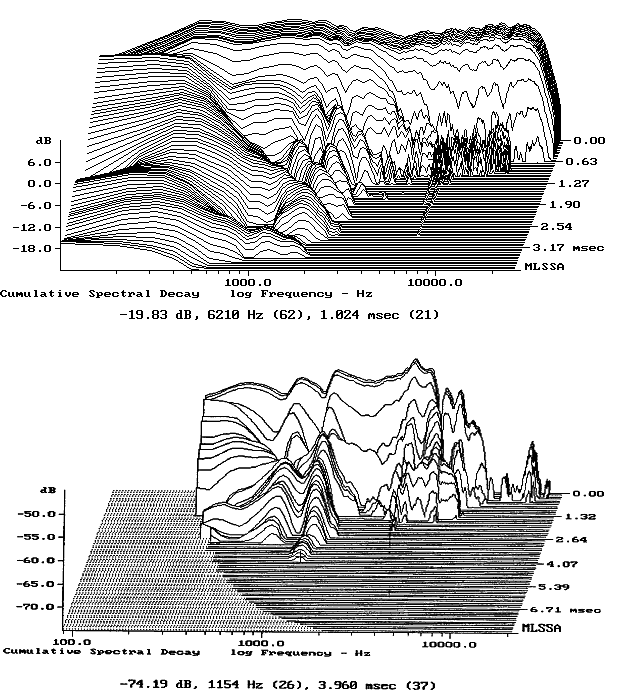

And more thanks to Mige0 for the links to the Prodance site with extensive MLSSA CSD and Theile/Small measurements.
Most of the 6" and 8" drivers don't look all that good. The graphic below compares the CSD of the complete Ariel system (above) to the Eminence Beta8 (below). It's evident the Beta8 needs extensive equalization, including strong in-band notch filters, to approach the flatness of the Ariel (which has very simple filtration for the midbass drivers). I'm not too sure if the Beta8 could ever match the time-domain performance of the Ariel.
Another surprise on this site is the performance of the Selenium 18WS600. It looks like a 2nd-order low-pass filter in the 200~300 Hz region would give exemplary performance as a bass driver. This isn't something you'd expect from an 18" driver.
The additional specs on the Parts Express site shows pretty respectable 2nd and 3rd-harmonic distortion figures as well.
Another gratifying surprise is the performance of the 18Sound XT120 waveguide combined with the B&C DE25 compression driver.

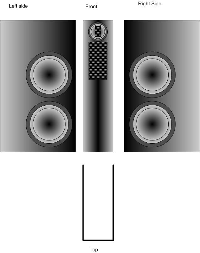

Early on in this thread..
I seem to remember an early proposed configuration by someone that used 4 side firing woofers. Can anyone point me back to that? I'm trying to avoid rereading the first 50 pages to find it.
I'm wondering if a U shaped open baffle speaker has 16" deep sides and an 8" baffle if the effective baffle length is 40"? and how the bass performance is affected by side firing a pair of 12" woofers on each side? I know the "nulls" would be facing the lstening position but also know that the polar response in the bottom octaves isn't as affected as much as the midrange. Thoughts? I have already read John K's and SL publishings on the U frame dipoles and just wanted to hear a few people weigh in. I attached a pic in case my english isn't clear.

Re: Early on in this thread..
OK for subwoofers with sharp lowpass filtering, but using through the midrange (as drawn) would be problematical. Note the magnets of the drivers are facing each other - this is a good technique for vibration cancellation (which is why we see this configuration using in closed-box woofer arrays with rods connecting the woofers to each other).
However, in a conventional closed-box configuration, this array is typically used in a 3 or 4-way system, since the tall, narrow box is prone to severe internal standing-wave modes, and off-axis listeners hear two arrivals, one for the left, and another for the right array of woofers. A sharp-cut lowpass filter reduces audibility of the box modes as well as the differential arrival times of the wavefronts from the L and R woofer arrays.
Keep in mind diaphragms are acoustically transparent, so you can "see" one driver through another. This is why Isobarik alignments must be aggressivly lowpass filtered, otherwise the cavity between the two woofers not only has non-coincident arrivals from the front and rear drivers, but standing waves formed by the cavity itself. (With no drivers mounted in it at all, an Isobarik would form a resonant cavity.)
U and H-baffles are partway back to closed-boxes in terms of standing-wave colorations, thus the requirement for lowpass filtering to minimize coloration. Moreover, the lowpass filtering has to be well below midrange frequencies, since the 300~600 Hz range is exactly where conventional closed-boxes suffer the most from standing waves (due to poor absorption of readily available damping materials at lower frequencies).
