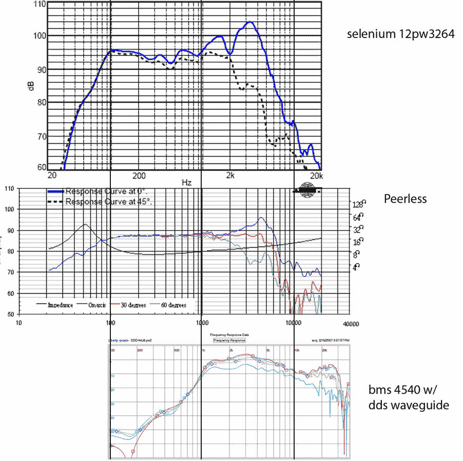

I am thinking of combining the following speakers in open baffle, similar to what is being done here. I cannot afford some of the higher end options that have been listed here and was thinking of combining the following
4 x selenium 12pw3264 somewhat recommended over here by Magnetar
Price 40$ each and Specs
2x Peerless Exclusive 830883 - 7" woofers
price 76$ each and specs
1x bms4540 mounted to a DDS waveguide
price 69+96$ & specs from JonMarchall's measurements over at htguide forum
If anyone foresees any problem with these combinations or think I could make a better choice while still adhering to my budget, I would be grateful. I don’t want to order parts that will not work well together.
I have attached the measured SPLs from the links listed above for easier comparisons
