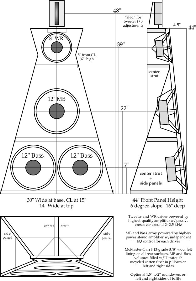

I've sent an e-mail to Mr. Previ, we've made contact, and I'm awaiting a reply. He's probably talking to the technical staff as we speak. Additional contacts within 18Sound are welcome, though, and feel free to point them to the most recent posts on this thread.
The 8-inch spot looks good for the 8NMB420 - an additional 3 dB of efficiency would be welcome, along with retaining the neodymium magnet structure. Any data on impulse, CSD, and swept distortion would be most welcome.
The 12-inch spot looks good for the 12NDA520, with the 12ND710 as a second choice. The efficiency is good as it is, and like the 8NMB420, any data on impulse, CSD, and swept distortion is welcome.
The 18-inch spot looks problematic for 18Sound drivers, due to the very large 1.5 kHz peaks. I know these are intended for professional subwoofer use, and pros use 24 dB/octave LR active crossovers and EQ. I won't be using such steep crossover, and want something more like the conventional woofer response of the RCF L18S800 or L18P300, or better yet, the response of the 18Sound 15NMB420. The rough response of 18-inch drivers is what makes me think of using a pair of 12-inch drivers side-by-side instead of single 18-inch driver.
The system will NOT be using 24 dB/octave LR crossovers, so smooth out-of-band performance is a requirement, along with low distortion in the desired frequency range, which is 60 Hz ~ 2 kHz for the 8-inch, 60 Hz ~ 300 Hz for the 12-inch, and 60 Hz ~ 150 Hz for the 15 or 18-inch.
The problem with the ICTA is the large inter-driver phase angle, as indirectly indicated by the magnitude graph - if my eyes don't deceive me, I'm guessing an inter-driver angle of about 120~135 degrees, right? As an old-time quadraphonics guy, phase angles this large are directly audible in their own right as a "phasey" sensation. although not everyone is sensitive to this. Inter-driver phase angles of 90 degrees or less seem more acceptable, but this depends on auditioner thresholds.
This is not the same as midrange lobing, which sounds quite different. I'm talking about a lack-of-cohesion sensation that is audible at any distance, and in fact gets worse as you approach the loudspeaker. To really create a sensation of a single driver, I've found I have to get the phase angles (between drivers) to 30~40 degrees or less. All subjective here, but that's how I hear things. I am probably more sensitive than most since I worked for many years on SQ and QS matrix decoders that intentionally created a 90-degree phase difference between front and rear speakers.
Now this phase-sensitivity between drivers mostly applies for equal magnitudes - reduce the magnitude of one driver by 3 dB or more, the sensitivity drops off pretty fast, and at 10 dB difference, the "acceptable" phase angles open up to 120~140 degrees. I've played with this a fair amount, listening to pink-noise and music at different distances, and have come up with a rough sort of "acceptable" phase angles between drivers.
Oddly enough, the MTM mounting scheme isn't necessarily an improvement - the "incoherent" sensation becomes less acceptable over a large area and with more drivers. That's what I especially dislike about large vertical WMTMW or line arrays - a strong sense of incoherence, of things not working together, and not like real musical instruments at all.
I agree completely about the need for precision in the mid/HF region. Absolutely. That's why the tweeter needs to be user-adjustable for listening height and distance. Even small adjustments produce large subjective changes in image focus, shape of soundstage, and realism in vocal quality. This requires a combination of acoustic measurement and subjective "trimming-in" - probably in the mm range for the final subjective adjustments.
I also agree about the concerns of the LF region - if these were conventional crossovers, switching from one driver to the next, stepping down from 8 to 12 to 18, then both the overall phase response and inter-driver phase angles become a major concern. If phase distortion is audible anywhere, it's audible in the 100 Hz to 1 kHz region.
But in my experience - which all I'm qualified to talk about - INTER-driver phase is much more audible than anything else, and it's not an artifact of polar patterns, but directly audible as "lack of coherence" and an artificial-sounding disjointed "multidriver system" sound. The opposite of a single-driver system sense of wholeness and coherence, in other words.
You walk towards the speaker system, and everything falls apart sonically - the illusion of a single source is destroyed. Nearly all physically large, complex, multiway high-end systems sound like this - the sound is incoherent and artificial, even if they "measure well" and fit the modern Toole criteria for "good sound". The reason for the incoherence comes down to large inter-driver phase angles, driver separation, and narrowband phase shifts close to the crossover region. None of this shows up in conventional FR measurements, impulse response, or the CSD.
That's a subtle reason I'm keeping the bass drivers all working together in the bass region, with only half-crossovers. I want to keep the inter-driver phase angles low and controlled - thus the choice of 1st-order or low-Q Bessel lowpass filtering for the lowpass functions for the 12 and 18-inch drivers. I don't want the angles to exceed 60 degrees, and preferably a lot less, so there's going to be some careful trimming of crossover behaviour in this region.
It's also why I don't want narrowband response deviations in the mutual-response region, since these cause sharp phase deviations as well, and will destroy the sense of coherence. This is part of the reason for my concern about the 18-inch driver - because of inter-driver phase concerns, a conventional sharp crossover is not an option. At higher frequencies, all of the drivers will collectively share an additional sharper lowpass filter at the tweeter crossover, to get rid of them once and for all above 2 kHz. But all of the drivers have to be reasonably well-behaved below that - which just may be asking too much of an 18-incher, but not a 15-incher.
The subjective goal is to have all three cone drivers sound like one driver, at any listening distance, including no more than few inches away from the front panel. My speakers have always done this, and the new system must do this as well. Nearly every other subjective goal is secondary.
Now will it succeed or not - well, I don't know yet. It is the direction I'm aiming for.

I understand you concern, but the ICTA is a little difference. Criticism of the ICTA approach not with standing let me return to the original question about offsets required for alignment of first arrival which you did not address. If you are only going to align the wide range and tweeter that is fine.
Now with the ICTA, as I said, things are a little different. Aside from the fact that you don't like the WMTMW format and the large inter-driver phase difference, let me say a few things about coherence. First, we discussed the MTM part and the difference between a dipole MTM and a conventional MTM system previously with regard to the ballooning of the (power) response around the dipole peak and the M-M cancellation as compensation. Second, in the ICTA we are talking about a 150 Hz crossover so the drivers are all acting like omnidirectional sources at that point. (I don’t intend on using this type of crossover for the MTM section.) Third, at 150 Hz the driver separation is such that the pair of mids and pair of woofers basically act as a single source centered on the baffle. What this means is that the amplitude and phase response of each pair is basically independent of position for fairly wide of axis angles, both vertically and horizontally. Sure if you get excessively close to the speaker this will not hold. It won't hold for any speaker. But at 1 M and beyond the proposed ICTA layout acts like two coincident point sources at the crossover frequency and the inter-driver phase difference, while exceeding 90 degrees, remains nearly constant over very wide vertical and horizontal angles. While I accept your comments on inter-driver phase differences, I believe that the issue is not so much about how big they are, but how they vary with position. The variation of the inter-driver phase difference will be a function only of driver separation and the position of the observation point (be it distance or vertical/horizontal displacement). That is, it's geometric and the same for all crossovers. The caveat is that some types of crossovers are more sensitive to variations in inter-driver phase variations. The LR type are the least as the response can never exceed 1.0, Butterworths are more sensitive and the response and reach +3dB when the inter-driver phase goes from 90 degrees to zero. With an inter driver phase difference of 120 there is a possibility of a +6db peak as the inter-drive phase goes to 0. And remember, were talking about dipoles here. So, in effect, between the front and rear sources we already have an “inter-driver phase difference” that varies for 0 to 180 degrees with frequency on axis.
In other words, (in my experience) inter-driver phase difference isn't the issue. Variation of inter-driver phase difference with position is.
We are obviously of different schools here, but like you I believe that the final judgement is in the listening. I suspect that both your system and mine will be speakers to reckon with. Of course, I don't antisapate driving mine with a SET amp. Tubes are fine, but I want to see a minimum of 100 watts. Like Patrick Henry said, "Give me muscle or give me deaf!"
Lynn Olson said:
The problem with the ICTA is [snip] .....
