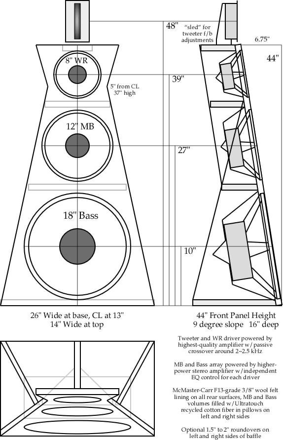

Here's the latest thoughts on what I'm planning this fall and winter. It has the most versatility in choosing drivers:
HF: custom RAAL ribbon, standard RAAL ribbon, Stage Accompany planar, matched Heil AMT's, or compression-driver & WG/horn.
8" Widerange: 18Sound 8NMB420, or exotique EnABL'ed Alnico Lowthers, PHL, or Fertin Field-Coil widreange drivers.
12" Midbass: 18Sound 12NDA520 or 12ND710. These drivers are selected for smooth response in the midrange (suitable for professional 2-way applications) and very low distortion in the 100 to 1 kHz region.
15/18" Bass: 18Sound 15NMB420 or 15MB700, RCF L18P300, L18S800 or LF18N802. These are air-movers, true, but large peaks in the midrange are to be avoided. The 18" can replaced with a pair of side-by-side 12" drivers, of the type shown above.
As before, the variable-geometry principle means the the LF drivers are cascaded to aid the widerange driver below the baffle rolloff, so the mids are 8" only, the upper bass is 8+12, and the lower bass is 8+12+18. This avoids the heavy bass-boost equalization of the audiophile-driver OB systems, and retains high headroom thanks to large driver area.
The stereo amplifier used for the MB and Bass drivers allows independent equalization and selection of rolloff frequencies for these drivers - the starting frequency of gradual-slope rolloffs (Bessel recommended) controls the size of the overlap region. This allows control of the response in the 80 to 400 Hz region without using "boost" equalization, keeping amplifier and driver distortion low.
I'll probably use the Behringer DCX equalizer/crossover to get things started, and once I get know the system and room better, maybe switch to a professional analog parametric equalizer like the Rane. As for amplifiers, the Karna all-triode Class A1/A2 amplifier for the widerange and tweeter (with passive crossover), and either good-quality pro amplifier or a pair of Quicksilver PP amplifiers for the Bass/MB drivers (Mike Sanders of Quicksilver lives in Denver now and probably has recommendations for this frequency range).
The 9-degree slant gives approximately equal arrival times for the 8 and 18-inch drivers for a listener 5 meters away, as well as aiming the front-panel standing waves and driver peaks upward. The Gary Pimm-style cardioid bass/midbass unit will use the same "Ultratouch" recycled cotton filling as Gary uses, possibly in small pillows between the center strut and the side panels. The addition extension (and quality) of the Pimm bass approach relaxes the subwoofer question quite a bit.
"Raven" feels like the right name - the panels will be gloss or semi-gloss black, and the rear elements will use dark gray felt.

Hi Lynn, it looks nice with well staggered radiating dimensions. That 9 deg slant maybe a bit over the top. You don't need to get the voice coils inline. The radiation centres must be aligned by experiment and they will appear further front IMHO. My rough guess is that maybe you are going to need 5 deg slant.

Hi Salas, I did a little simple geometric modelling and found that for a 5-meter listening distance, there's a 4-inch (100mm) offset between the 8 and 18-inch driver. (Listening at the same 39-inch height as the 8-inch driver.) Add an inch for the deeper cone of the larger driver, and that's 5 inches, which translates into a 9-degree slant.
If you listen at higher than 39 inches, or closer than 5 meters, you need more slant. The only zero-slant condition is listening at 24.5 inches off the floor, the centerline between the 8 and 18-inch drivers.
This is assuming all drivers have equivalent acoustic lowpass functions. In practice we have acoustic lowpass filtering like this:
Lowpass for 8-inch: 2nd-order at 2~2.5 kHz
Lowpass for 12-inch: 1st-order or Bessel 2nd-order at 200~300 Hz (additional filtering above 1 kHz to force to idealized rolloff)
Lowpass for 15/18-inch: 1st-order or Bessel 2nd-order at 80~120 Hz (additional filtering above 1 kHz to force idealized rolloff)
The larger drivers have summed electrical + acoustic lowpasses that moves them further back in space (relative to the widerange driver). This would imply that I need more offset if I want the arrival times to be the same.
What's your take on this? If you assume a 5-degree slant, with identical drivers, fed the same frequency response - looking at geometry alone, it looks to me like the sound from driver closest to the floor arrives first.
P.S. Since we are free to use Nth-order Bessel lowpass filters for the MB and Bass drivers, I'm aware they can be moved back in space relative to the widerange driver by simply increasing the order of the non-overshooting Bessel filter. But this is a one-way street: they can't be moved acoustically forward of the WR driver unless the whole system uses a digital delay system, something I'd like to avoid as a design requirement.

I like the look of the Raven. 🙂 Nice sketch.
Not such a huge speaker after all. I've had OBs about that big in my small living room. The taper and final pinch at the top give it an elegant feel. There sure is a lot of cone surface and magnet weight going on.
When you say "In practice we have acoustic lowpass filtering like this:" do you mean these are your target acoustic curves and you will make whatever electrical filters are needed to achieve it? Or are you talking just electrical?
