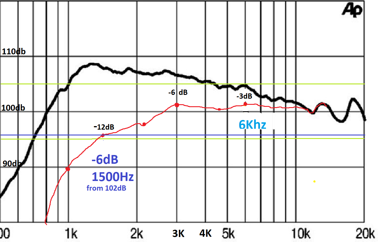

ln[6000/1000]/ln[2] = 2.585 octaves * -6 dB = -15.5098 dB
OK and yes, I see now that in my haste I took a too simplistic view, forgetting the driver's, XO roll-off below Fs, so the XO point will be somewhere between 7.2 - 1.44 kHz.
I thought about this frequency response by cutting the driver at 6kz 6dB / oct, taking into account the 18Sound factory diagram.
The Le on the woofer is a bit high and indicates a 745hz high frequency limit. Maybe look at the Faital Pro 12PR330 crossed at 1500 or lower.

Le is the voice coil inductance and for frequency analysis it can be considered to be in series with the voice coil DC impedance - Re.
These who together form an low pass filter for the current though the voice coil and when the frequency of the applied signal to the speaker passes Re/(2*Pi*Le) the current though the voice coil starts roll off with 6dB/octave.
So the greater Le the lower frequency for the roll off.
Warning: This is a very simplistic analysis and in the real world other things starts to influence the frequency response (like membrane breakup).
But it does explain the consequnce of a high Le
Martin
Correct and this is where the isolated assessment of Le comes under pressure as being to simple.
The membrane will start to break up (the rings visible in the membrane indicates that Beyma has designed a controlled break up) and this will influence the frequency response - typically by extending the frequency range.
However be aware that the claimed frequency range and the graph only applies on-axis: Depending on how well Beyma designed and implemented the membrane breakup you should expect "beaming" to set in somewhere between 1 kHz and 2 kHz.
In other words: On-axis you may get output to 6 kHz, but with a listening position just a little bit of-axis you will loose mid and treble.
Unfortunately Beyma does not show this for their low frequency speakers.
Martin
