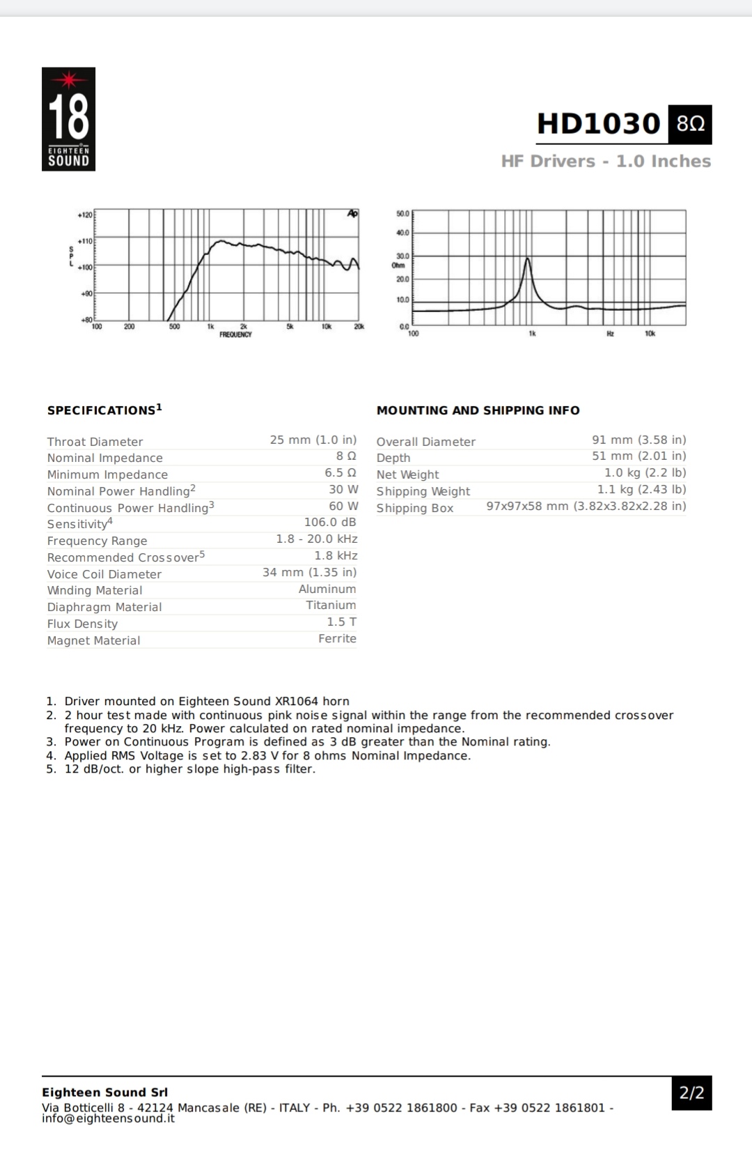

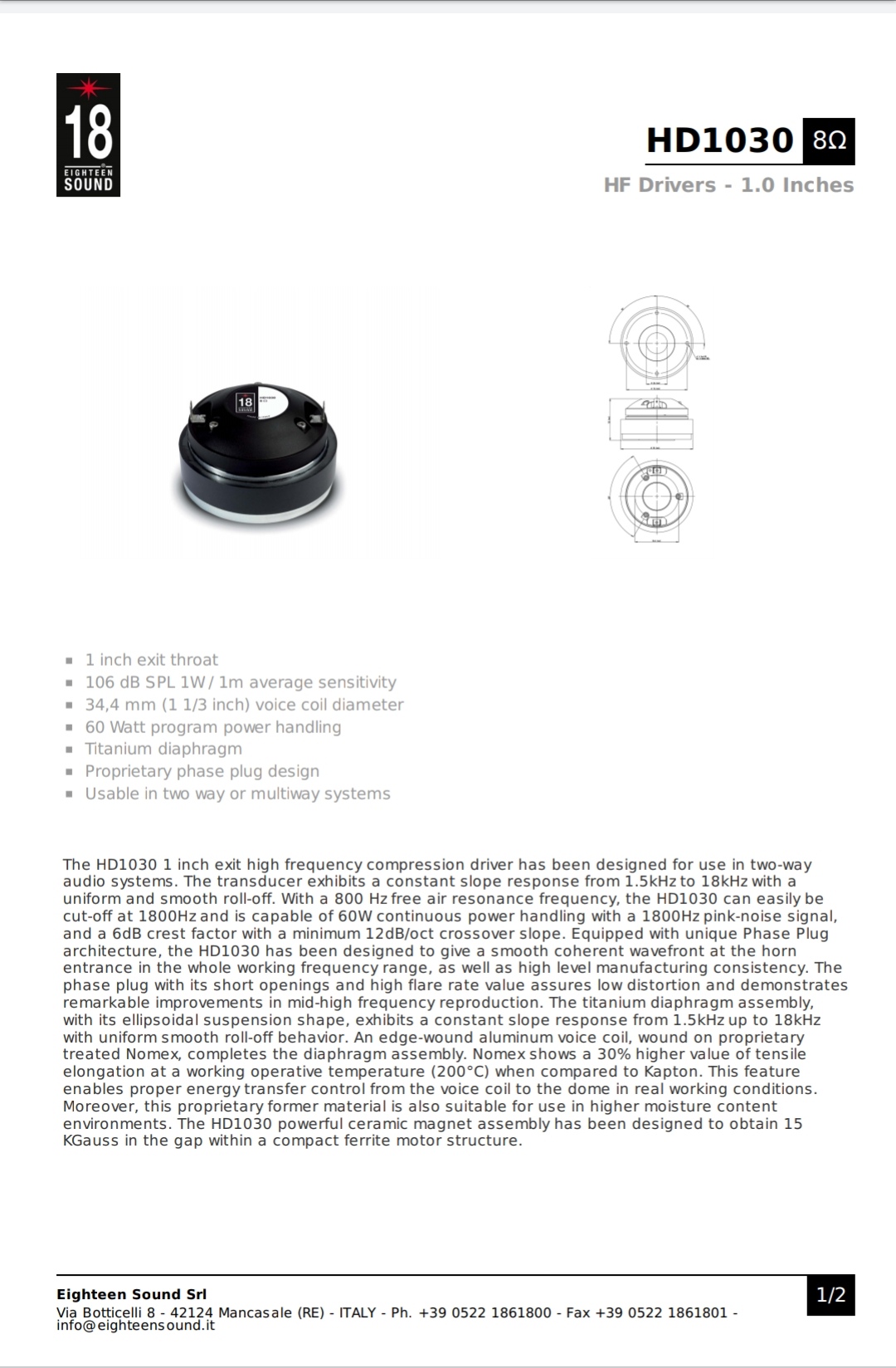

Well, it can in theory handle a ~ 1.45 kHz/2nd order or ~ 1.27 kHz/4th order in a HIFI/HT app...........
6 Kz First order would be fine?
Because the frequency resposne would be perfect for me with 6dB/oct
