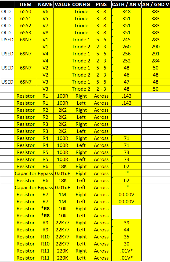

I think I may have badly miscalculated the 21mA on the second 6SN7 because I overlooked the fact that it is two double triodes, served by the same shared cathode resistor.
In any event, moving cathode resistor R6 to 12K and load resistors R9/R10 to 22K seems to have done the trick. There is no longer any nasty hardness and dryness to the sound.
Given that cathode resistor R6 was factory set at 18K and load resistors were 30K - originally optimized for 6SL7/6SN7 with 100K of GNFB - I do wonder what I have achieved electronically.
Is it simply a case of running the second 6SN7 tubes a bit hotter, to gain greater linearity?
As far as plate voltages go, the second 6SN7 is now running with slightly higher voltage (now ~130V) than the original factory setting, but the first 6SN7 now operate at less than half the plate voltage (now ~50V) compared to the 6SL7 tube it replaced - which was ~115V.
Would it now be prudent to reduce the R2 and R3 cathode resistor on the first 6SN7 to bring the plate voltage back to ~115V? Or is this unnecessary?

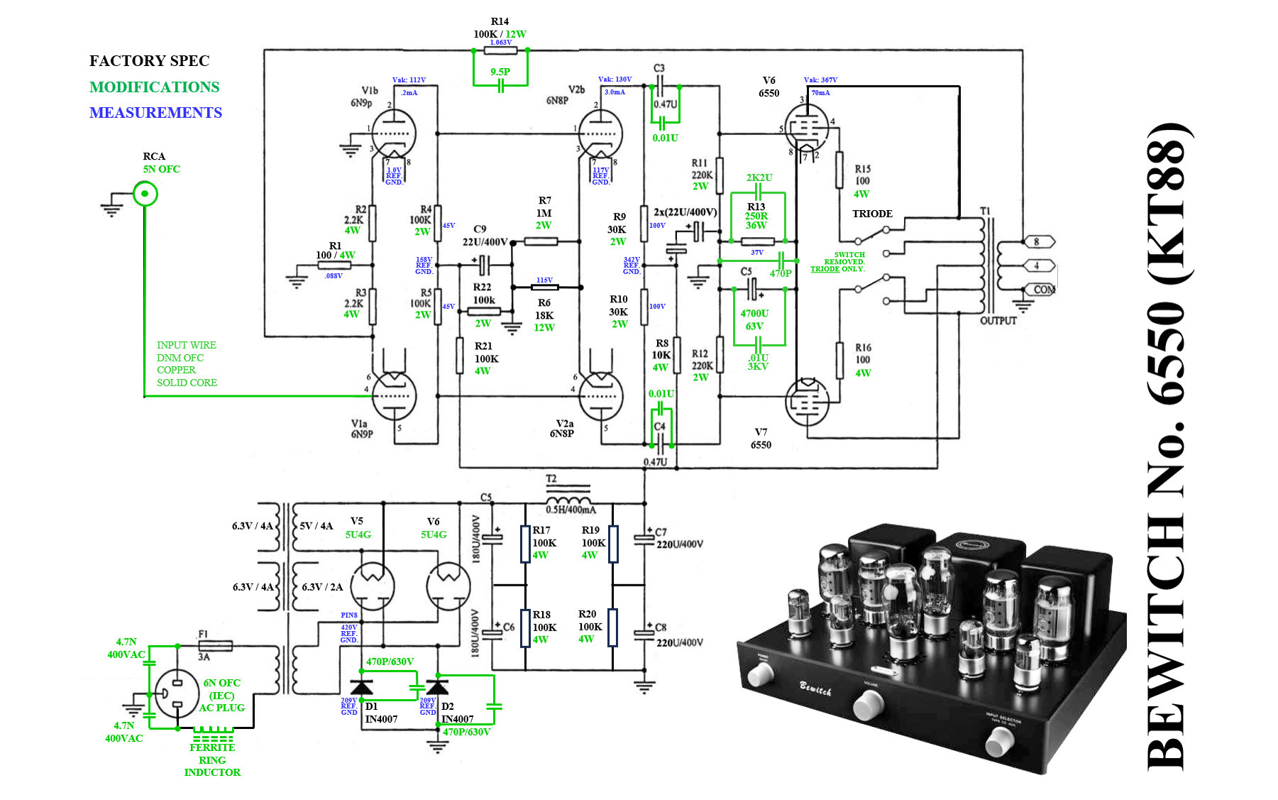

in any common cathode amplifiers, the plate load resistors are there to determine voltage gains, remember that the Rp of the 6sn7(around 7K) the next stage grid leak resistors(maybe 220K) and the plate load resistors are all in parallel as far as ac goes, this being said, the voltage gain can never exceed half the mu of the tube, x11 in the case of the 6sn7 that has a mu of 20..I think I may have badly miscalculated the 21mA on the second 6SN7 because I overlooked the fact that it is two double triodes, served by the same shared cathode resistor.
it is the plate voltage that determined output voltage swings, either you increase the B+ supply, or lower the plate load resistors, you choose...
you can try, do it in small incremental steps...the kt88 grid is biased at around 40 volts negative wrt cathodes, so a 115vdc plate on the second 6sn7 seemed plenty, but if i can i will add more to that plate voltage...Would it now be prudent to reduce the R2 and R3 cathode resistor on the first 6SN7 to bring the plate voltage back to ~115V? Or is this unnecessary?
yes, those resistors are gm reduction resistors to an already moderate gm tube, i wonder what they were doing there in the first place...Is reducing R2 and R3 down to 1.1K each a small incremental step?

R6 is back to 18K.
R9 and R10 are now at 22K7.
The second 6SN7 now has ~260V on the plate.
It's sounding pretty good with no smoke or red-plating.
Here's the present numbers.
Still running in TRIODE ONLY with zero GNFB.

I provide the final schematics below, to help anyone else on a similar journey.
I'd like to thank the many experienced diyAudio members who faithfully supported my learning process. Appreciated. Special mention must go to @TonyTecson, who has been a constant and tireless source of knowledge, competence and inspiration.
Here's the final outcome - with measured values attached.
SONDEKNZ BEWITCH 6550 UPGRADED SCHEMATICS: August 2023.

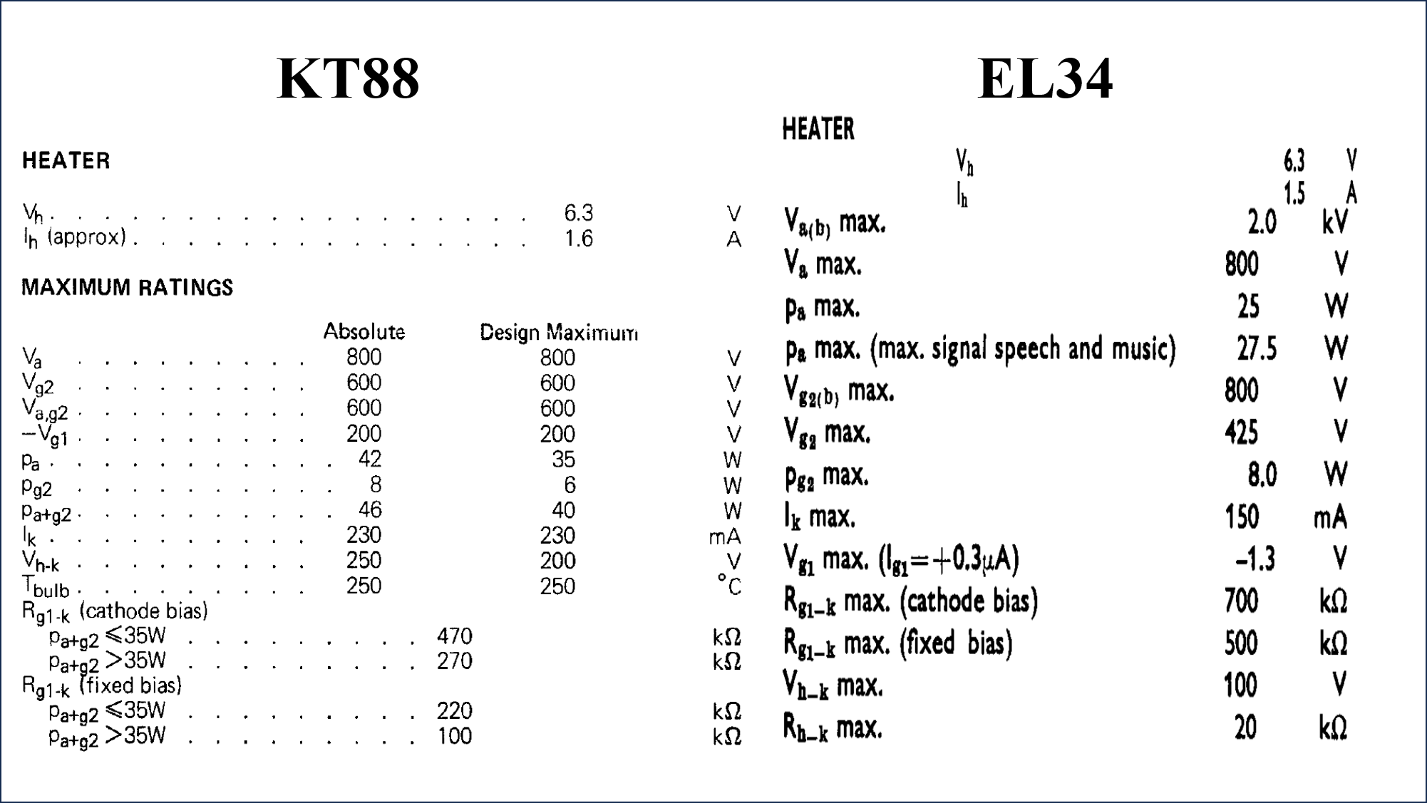

BTW Tony, I still have not forgotten our discussion about potentially running the BEWITCH 6550 using EL34 output tubes with zero GNFB - and (perhaps) getting better bass results from the present OPT, due to the reduced output power.
I have been studying the KT88 v EL34 TRIODE OPERATION datasheets and from my newbie perspective, it would appear that I could probably just drop a quad of EL34s into the present BEWITCH configuration - with no other changes - without too many concerns.
Obviously, things would change again, once the EL34s were in and GNFB was then removed.
Would you agree with my assessment?
If not, what have I missed?
Am I heading for disaster?

you are using cathode resistor bias so i do not see any big problems that can arise...
Thanks Tony. Appreciated.
I will drop-in a quartet of EL34s and see how it goes.

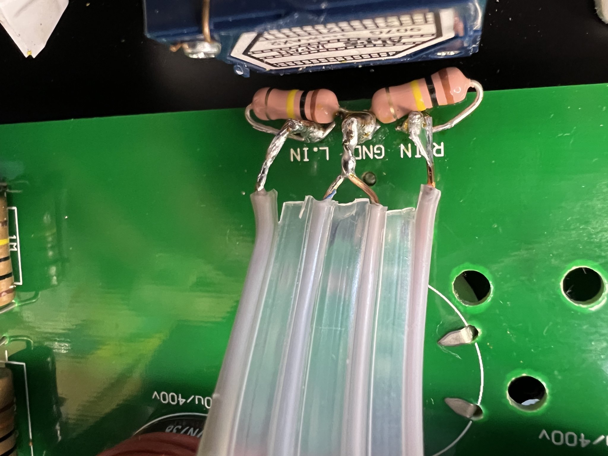

Thanks Chris.
I actually tried 100K Grid Leak/Stop resistors for V1a and the sound quality took a backward step.
(Not sure whether to describe them as Grid STOP or Grid LEAK, so I have attached a photo of the signal input, with said resistors in place...)
Everything sounded a bit rolled-off and overly smooth - so I removed them.
Do I need to spend big on low-noise resistors for this position?
I'm not sure what I risk, by leaving them out completely, to be honest...
Above photo shows a volume control not on the schematic. If that's immediately between the input jacks and the circuit as drawn you don't need another grid leak - the pot provides one. But I assure you, you can't hear or measure a 100K resistor in that location. A grid stop is a smaller resistor, maybe about 1K Ohm in series with the signal, mounted right at the valve socket. Suppresses RFI and helps stability. Can't hurt. The output valves should have grid stops also.

The ALPS volume pot is indeed completely out of circuit.
Not sure why I felt those 100K Grid Leak Resistors smoothed things out too much.
Here’s the full schematic with values,,,
What is the risk of leaving those Grid Leak Resistors out please?
Thanks Chris.
An example of "grid leaks" in your amplifier is R11, R12 at the output stage. These set the output valves' grids at 0VDC, and without them the output valves would have no negative bias and would run away and self destruct. V1a isn't in danger without a grid leak, because its anode current is limited by its anode resistor R5, but it won't be properly biased without its grid at 0VDC.
Presumably whatever is driving this amplifier is providing a 0VDC "ground reference" so you're fine when amp is connected to source. But when disconnected, you can't test your amp for DC voltages etc. by itself. Why invite grief when the solution is so simple? (and universal - all amps have this). If worried about loading a very high impedance source, you can make the input grid leaks 1M Ohm and that'll work fine.
