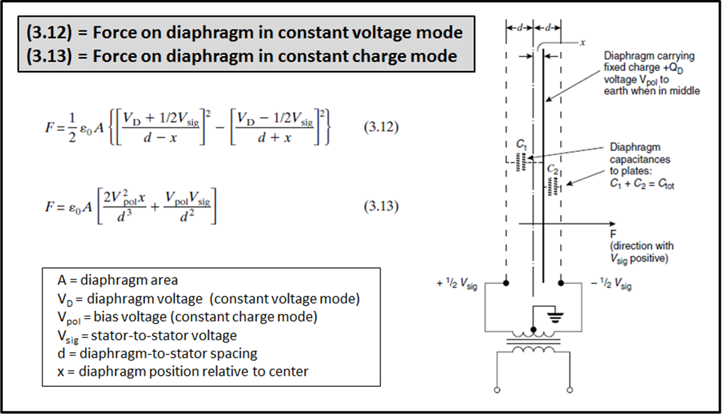

Interesting graph, do you mind sending the equations behind ?
The graph was created using the standard force equations for constant voltage and constant charge ESLs first published in the Hunt's "Electroacoustics". Personally I find the Baxanadall derivation and description in Section 3.2.2 of the reference below much easier to follow.
Attached is an excerpt showing the equations and relevant figure.
Force was calculated for a range of diaphragm positions(x) with VD = Vpol, and Vsig = 0.

thank you for the attachement, bolserst..
