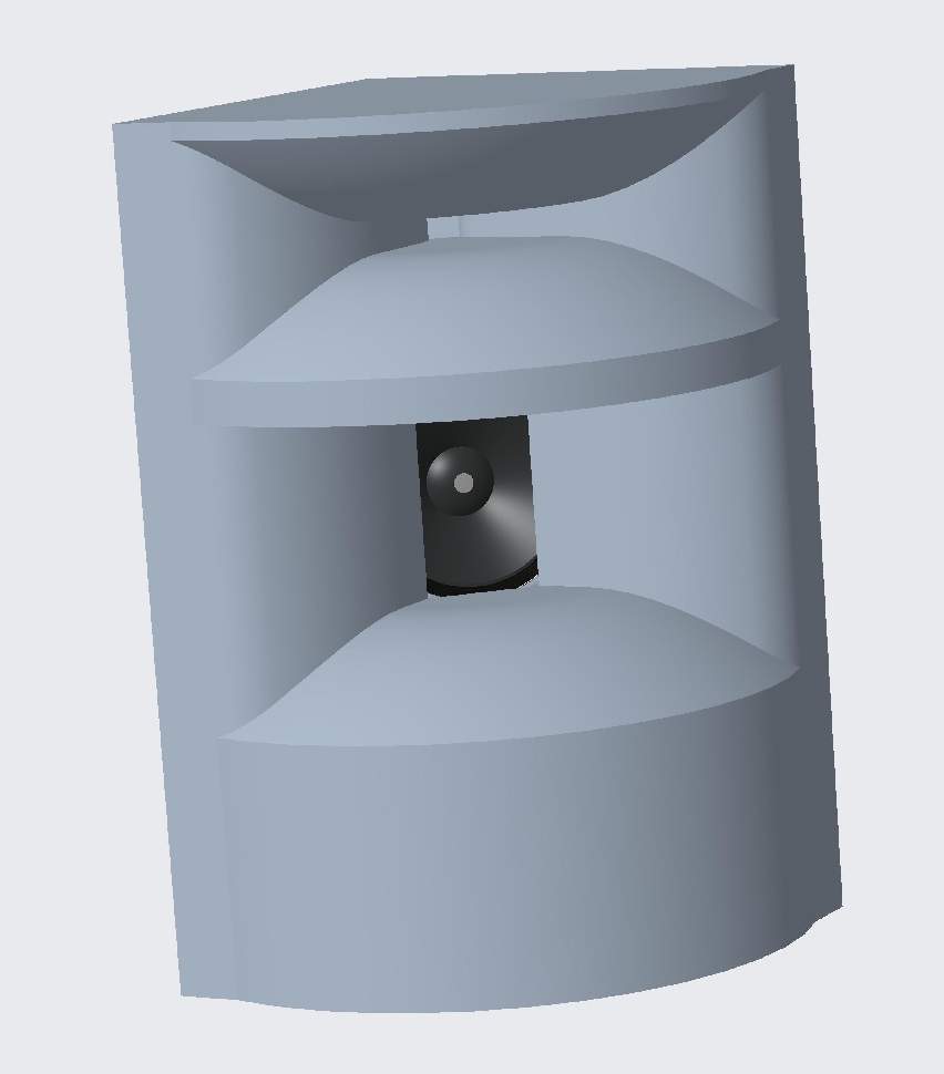

I'd love to hear more about your thoughts on the corner cabinets you're contemplating.
A picture says more than 1000 words. It will be built in three sections, Bottom BR box connected to the GPA 416 front horn section and on top, well the top. This way a can in the future seal off the mid section and add a pair of 12" sub drivers below the 416.
Really love this design and concept... something like a BR + FLH TAD 2402?
Did you by chance come across the 'Blue Thunder' 2-way published in Sound Practices magazine as you were contemplating designs? One of several interesting choices the designers made was to allow the width of the TAD 4001 horn to dictate the width of the enclosure. Lots of questions - I'll be PMing you when I can get time.

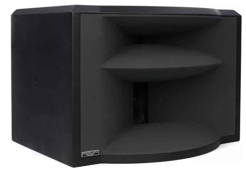

I happen to have a pair of Altec 828 cabinets in my garage which I'm storing for a friend temporarily. I finally got around to giving them a good listen today, using the same Altec 416 drivers we've been discussing here.
The shortcomings of the Altec 825/828 are well understood, and they're pronounced enough that I couldn't live with them in a primary system. But I was sufficiently stunned at what they do well to begin exploring whether there are BR + FLH designs (specifically using Altec/GPA 416/515) out there that capture some of the 828's visceral impact while improving on its weakness. An enclosure issue for a different thread I suppose, but your design seems to be aiming in that direction.
To bring this back on topic, provided I go with an 'old school' spec'd driver, it's clear for my purposes that the 6.3ft^3 volume of my current enclosures is woefully insufficient for achieving the kind of scale or extension I'm looking for.
With modern day woofers, PRs, not sure 'sub' woofers would be required except for low B pipe organ symphonies: RCA LC9 - Google Search
