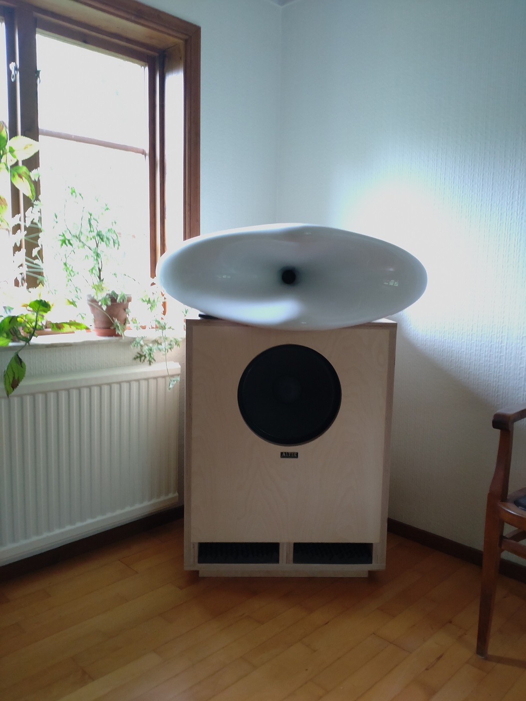

Interresting thread 🙂
I am today running a pair of corner placed 2-ways with a GPA 416 in a flow restricted 280l BR cabinet and a TD-4001 on a E-JMLC 300. It is very pleasing and have stayed a 2-way for over a year even though it was planned to become a full 4-way. I have in the past used both Altec 416 and 515 and i would say from memory of those units that tha GPA 416 lands somewhere inbetween the two Altecs. I have no experience of the GPA 515.
I can say that as it is now, the GPA 416 is NOT leaving my living room anytime soon 🙂 but I plan to give them a new home in the form of a corner variant of the 825/A7.

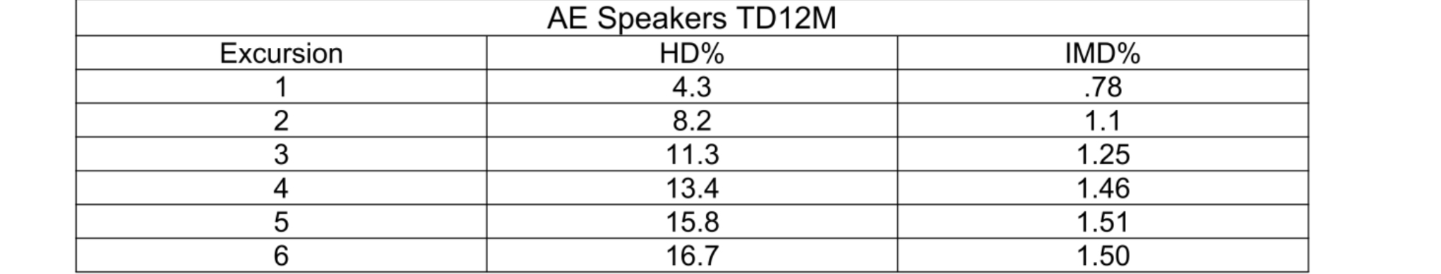

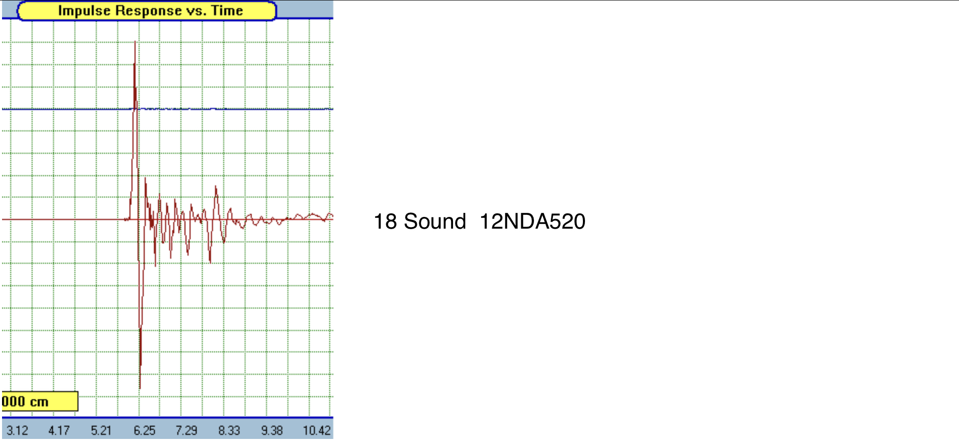

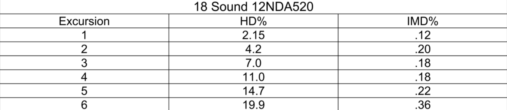

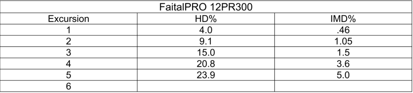

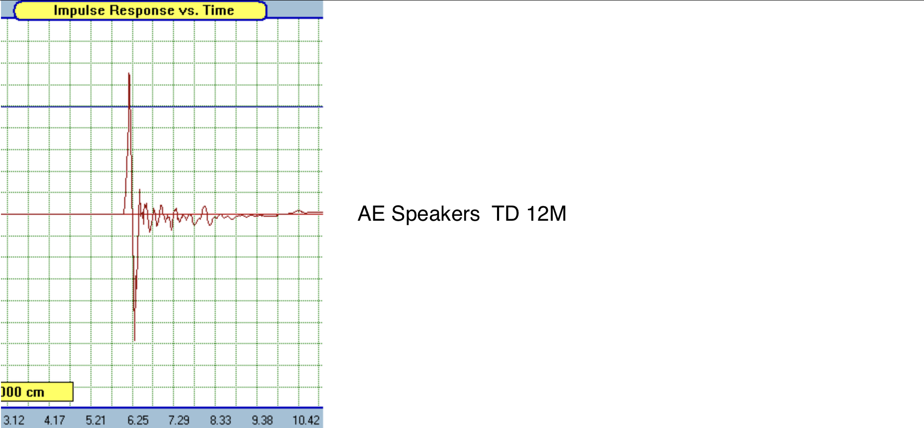

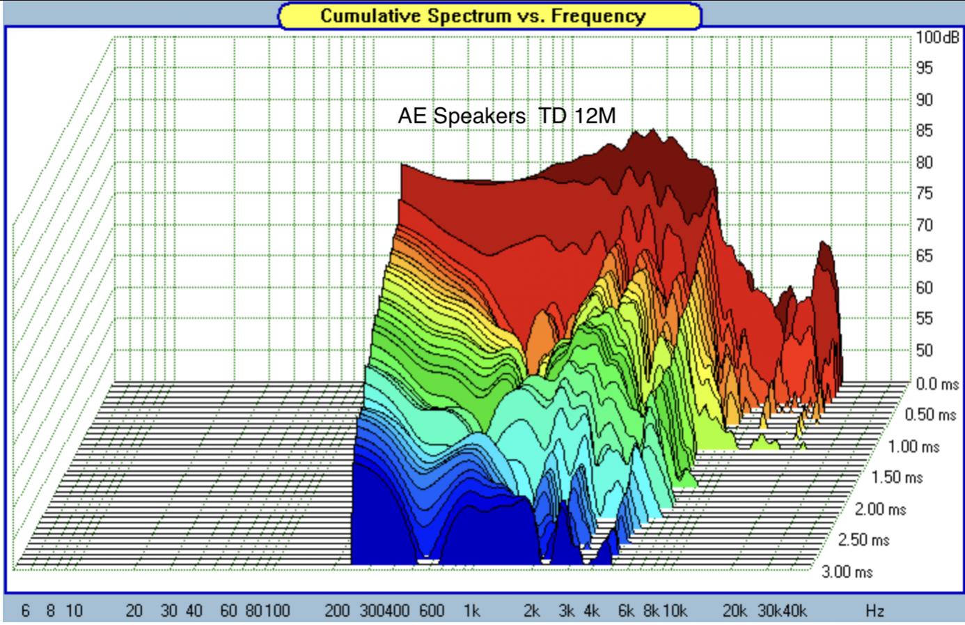

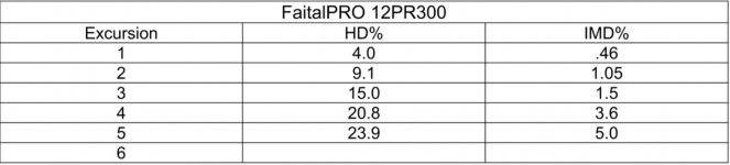

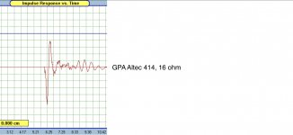

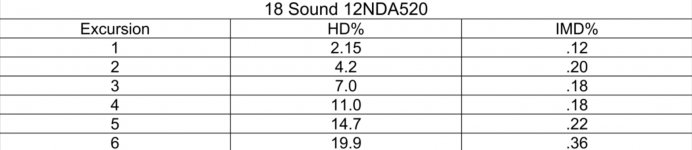

Might be of interest ~ you may not know:
I know we’re talking about 15 inch drivers, but there are some very good 12 inch drivers’ quite comprehensive measurements
18 Sound 12NDA520
AE Speakers TD12M
B&C 12HPL76
Eminence Kappalite 3012HO
FaitalPRO 12PR300
GPA/Altec 414, 16 ohm
The GPA 414 certainly has a lot more distortion
And ~ four 15 inch drivers on another page
12" - drivervault
