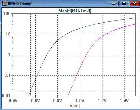

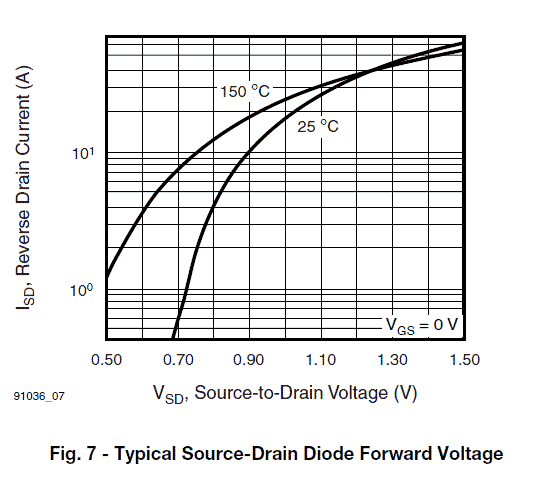

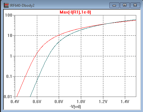

I used Bob's values as a starting point. Then, if I find the plots are not like the data sheet then either try altering the values or enhancing the model. I think Bob has started by looking at existing models, eg Vishay model (31 Oct 1999) body diode (MD2) has Is=5e-9, N=1.4, Vj=5, m=0.87. Note that has Vj=5.
Use a Jig that plots Ids versus Vgs. Keantoken posted my jig for the IRF640 in this post. This does not show changes in Vj (a capacitance parameter) only Is and N (also Rb the VDMOS body diode series resistance).
The plots for the standard VDMOS body diode at Tj=25C and 150C are attached. The left plot is 25C and the right 150C. Compare this to the datasheet plot Fig 7 (attached) and you can see the VDMOS has the 150C on the wrong side! It's completely wrong because the VDMOS doesn't have the right tempco for Is parameter (probably the default is no tempco for Is). You can see this by adding a tempco for Is using curly brackets gives the right curves (see attached Jig2). Jig 2 model follows:
*VDMOS with subthreshold (c) Ian Hegglun and Keantoken Jun 2016
.model IRF640-Tja_ VDMOS (Rg=5 Vto={4.30-6m*(Tja+temp-25)} Lambda=3m
+ Rs={35m*(1+3.5m*(Tja+temp-25))} Kp={13.0/(1+8.8m*(Tja+temp-25))}
+ Ksubthres={0.23*(1+4m*(Tja+temp-25))} Mtriode={0.35} Rd={0.1*(1+5m*(Tja+temp-25))}
+ Cgdmax=2600p Cgdmin=10p a=0.35 Cgs=1250p Cjo=3000p Tnom=temp
+ m=0.75 VJ=5 IS={1n*(1+0.3*(Tja+temp-25))} N=1.3 Rb={0.01*(1+2.5m*(Tja+temp-25))}
+ Vds=200 Ron=0.15 Qg=67nC mfg=IHKT1703)
I don't have a jig for plotting the body diode capacitance. As I suggested (in the earlier post) the body diode capacitance variation with Vds is not very important to get perfect. Most of the drian-source capacitance variations are set by the VDMOS parameters Cgdmax, Cgdmin, a=0.35, Cgs and Cjo. A jig available for fitting these parameters on the web here. I'll attach my jig used to fit the IRF640 caps.
