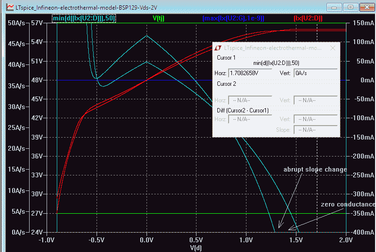

LTspice Infineon subcircuit BSP129 plots
Thanks Keantoken, excellent work as usual😎
I'd like to know what type of MOSFET model Infineon use. Anyone recognise it?
Attached are some Vgs and Vds plots to check out the model. They plot two curves each. Stepped Tj non-electrothermal. OR you can plot a Fixed Tj plus an electrothermal. You choose which ones by changing the .Step commands: turn one off and the other on then re-Run. Some findings:
  • The Vds plot you can see subthreshold conduction is modelled and the threshold temp co is modelled.
  • The Vds-2V plots show entering saturation where there are abrupt changes in the slope just like LTspice vdmos. There is no drain conductance in saturation -- not sure if it is set to zero, or if it is not modelled. It's not obvious from the listings on how to set the drain conductance like Lambda does in the VDMOS. Anyone know how?
  • The Vds-50V sweep shows the drain conductance in saturation increases as Tj rises -- this is something that standard (isothermal) models do not give and at lower audio frequencies could easily change simulated distotion in many designs.
These seem to be excellent models. Obviously a lot of work has gone into developing them and making them available for a fairly wide range of simulators. The Introduction PDF Table 2.1 says the PSpice code ".lib" does SiMetrix, LT-Spice, and Multisim. Early documents are dated 2006.
The transition into the subthreshold region of conduction looks a little too sharp. Comments?
Bob
