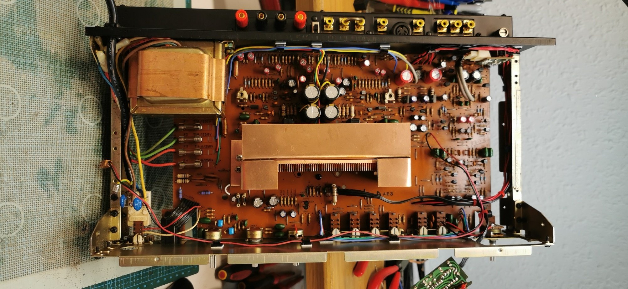

I completely rebuilt .remodeled and rewired this 3020 with solid tinned, no problems at all.
Yeah, I'm not saying it can't be used - I was just relating my experience that plain copper solders more readily. I presume it's because of oxides on the tin plating. To be clear, I do use tinned wire but not for my better projects (or, where I'm crimping the connections).
