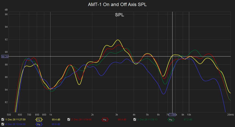

An ESS AMT-1 (December 2019 vintage) on- and off-axis SPL response plot. Red is on-axis, while the other traces are taken at 15 degree intervals. The blue trace is 45 degrees off-axis (IIRC).

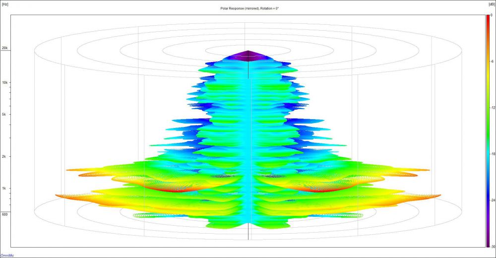

Here is a polar sonogram, showing the need for wings below ~2 kHz.

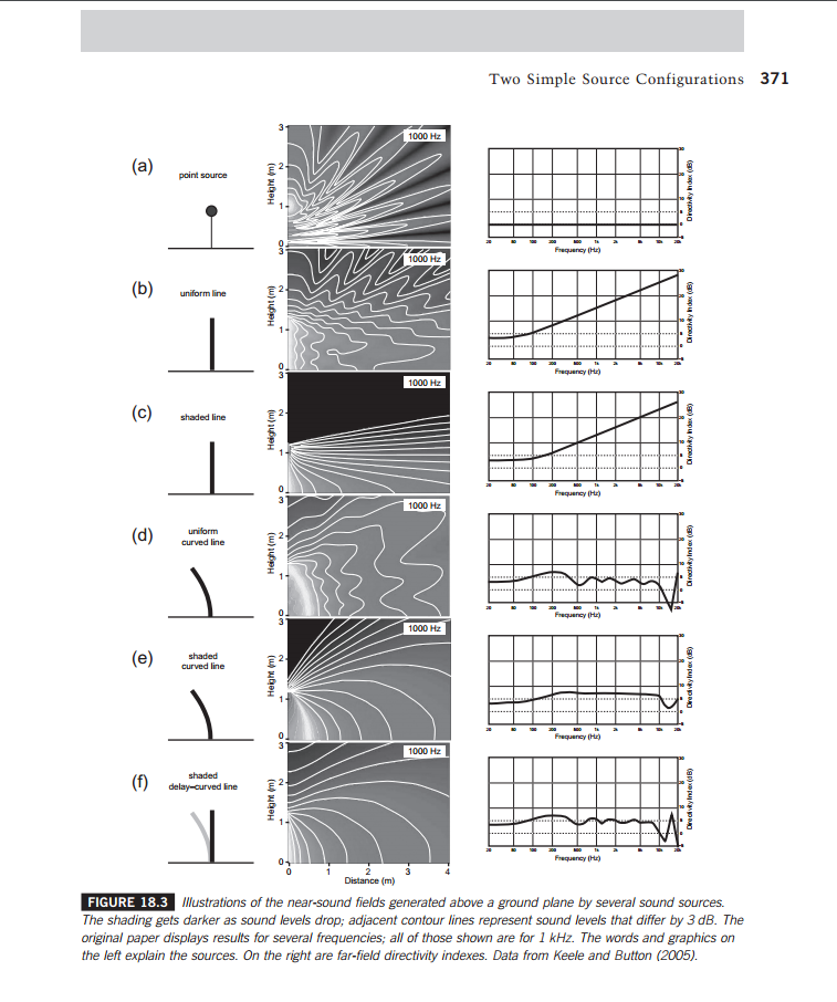

I use my AMT-1s (single-high, then later dual-high) without wings crossed at ~700 Hz to Belle bass bins. Tilting back the top AMT-1s about 20 degrees approximates a "shaded array" [configuration (d) in the following figure from Toole's book] upwards (i.e., NOT in a floor bounce direction) to improve vertical polar response so enable a much wider vertical envelope than just the double-high AMT-1.

Not the smoothest response
I beg to differ. Those were all in-room measurements on top of a glass or hard wood surface.
With a small amount of absorption, the response gets even smoother. Note the vertical scale is in 2 dB increments--not 5 dB.
(If you're looking for an excuse to screen them out of solution, I think you're going to have to look elsewhere than SPL response.)

Was there no smoothing applied to that curve at all? Not even 1/12 octave?
It's on the plots--in the legend for each trace.
