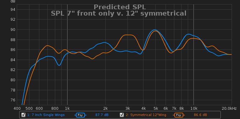

An ESS AMT-1 (December 2019 vintage) on- and off-axis SPL response plot. Red is on-axis, while the other traces are taken at 15 degree intervals. The blue trace is 45 degrees off-axis (IIRC).

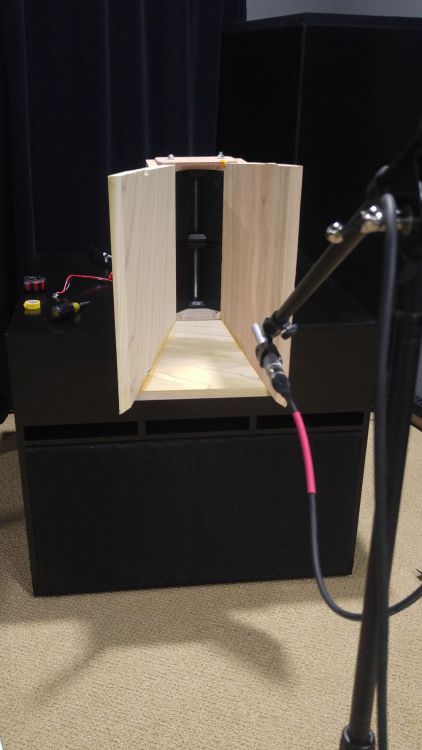

Here is a polar sonogram, showing the need for wings below ~2 kHz.

I beg to differ. Those were all in-room measurements on top of a glass or hard wood surface.Not the smoothest response
With a small amount of absorption, the response gets even smoother. Note the vertical scale is in 2 dB increments--not 5 dB.
(If you're looking for an excuse to screen them out of solution, I think you're going to have to look elsewhere than SPL response.)
Chris

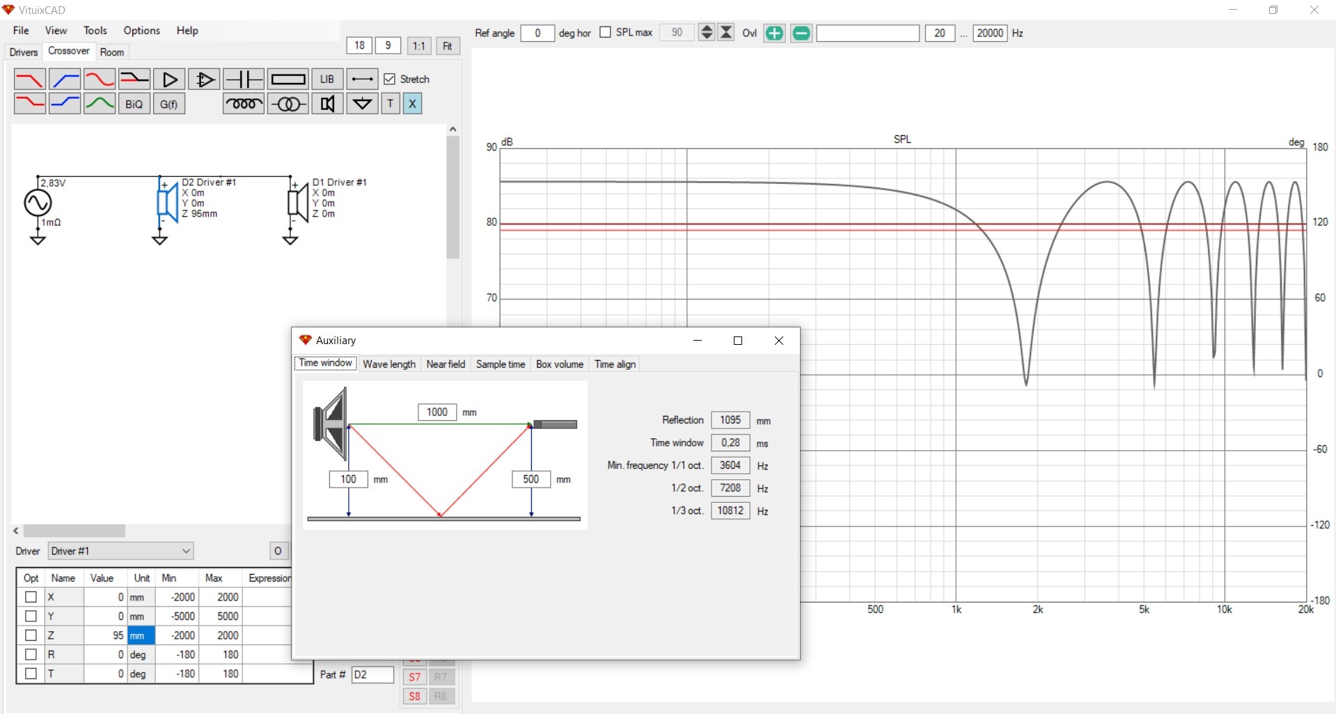

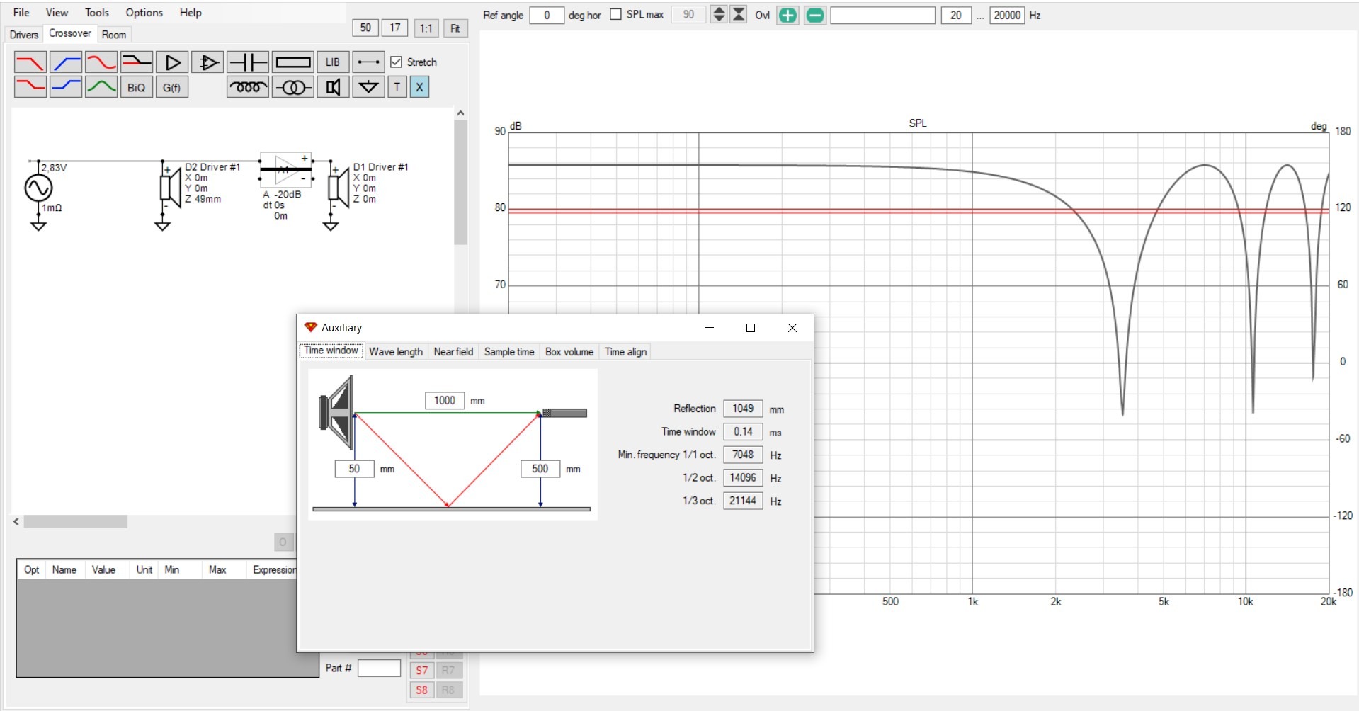

Mmm... another way to mitigate desk bounce, perhaps:
I don't know if I mentioned also about a very tight-dispersion Synergy horn as well, something like 60x40 or 90x40. Not everyone's cup of tea.

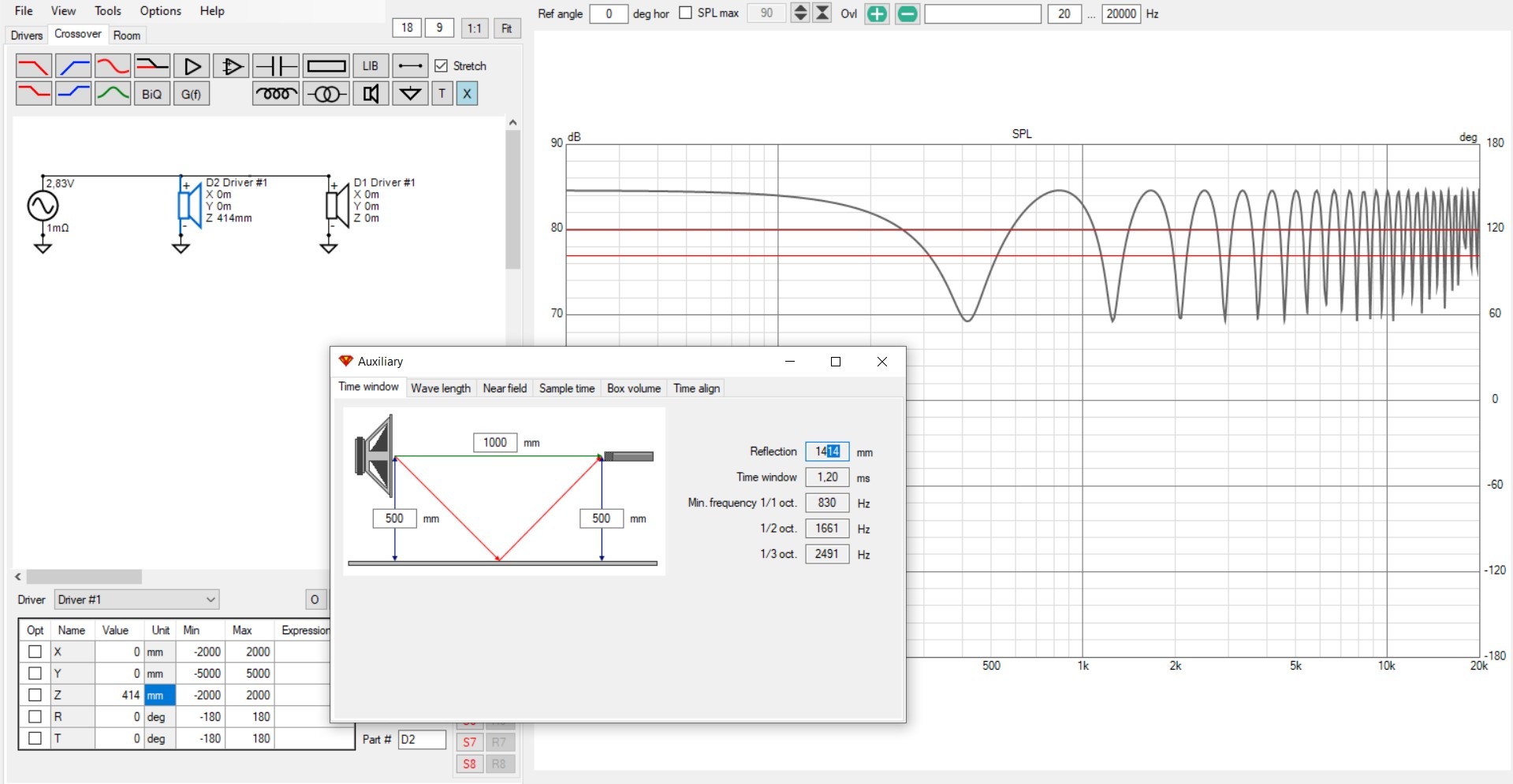

One more - using a really deep desk to make more space for an absorber right where the desk bounce happens. (You get more usable desk depth in front of the absorber in a 1:2 ratio as you increase the desk depth)
- Low/no-baffle TM dipole, with high-dispersion tweeter (3/4" dome or equivalent) and relatively low-freq high-order crossover to the midrange (due to the severe "off"-axis requirement - see below)
- Tilt the baffle toward the ceiling about 45 degrees or so. This should point the dipole null right at the desk bounce in most nearfield setups.
- (Monopole) woofer can be right at desk level, up-firing if needed.
- Because the speakers would be very close to the back wall, a substantial amount of absorption on the back wall would help with imaging (but not so much or so close as to actually prevent the speaker from operating as a dipole). Same with the ceiling; would be a good idea to hit the ceiling bounce with a small cloud of absorption "floating" above the tweeter/mid dipole baffle as well.

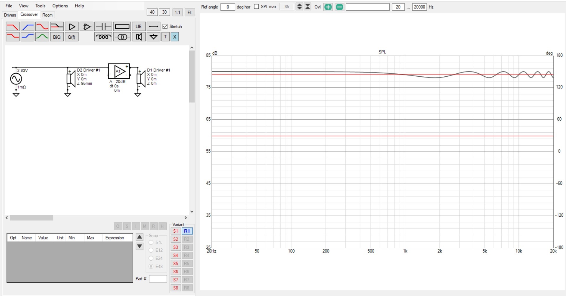

Was there no smoothing applied to that curve at all? Not even 1/12 octave?
It's on the plots--in the legend for each trace.
BTW: do you take in-room acoustic measurements using something like REW? Personally, I wouldn't try any of this without one of these and something like REW with a calibrated microphone for acoustic measurements.
