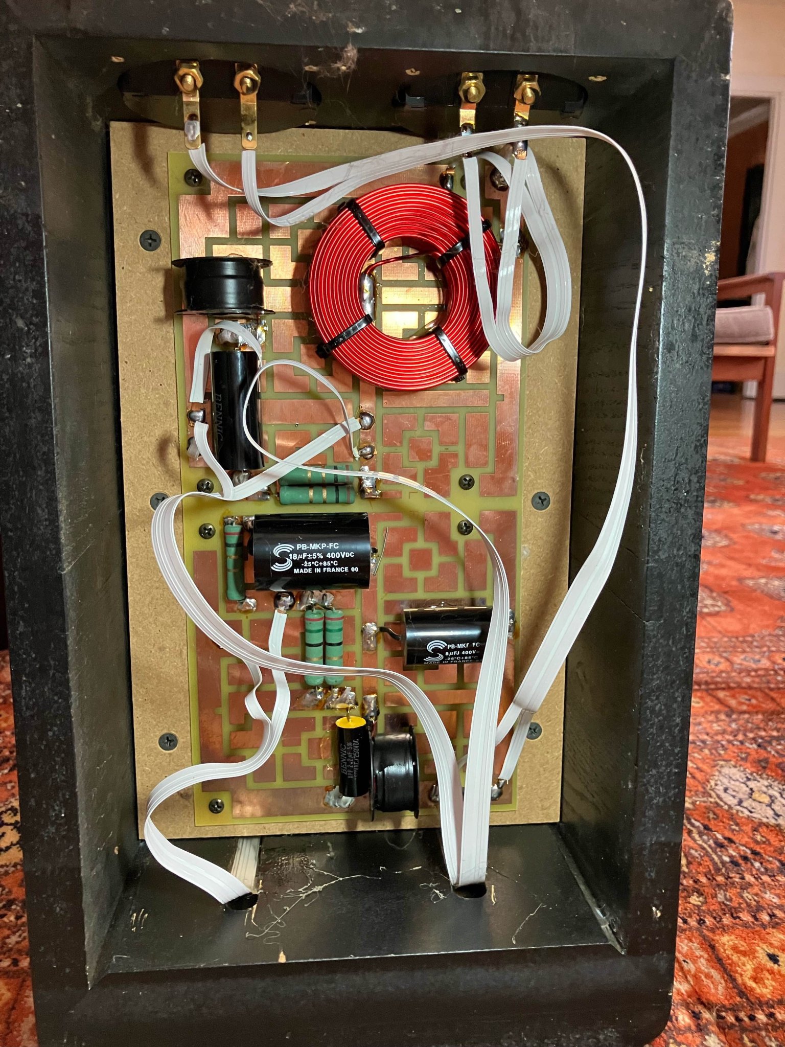

Do you have a pic of that insert with the crossover on it? Is this supposed to fit into the opening as the base of the cab? If so, then there wouldn't be any space for the battens anyway and the plinth would attach to that instead. I had missed this detail earlier in the thread. But with that baseplate glued in, it just screws onto that
There's a pic up at Post 25 in this thread but I'll try to attach a bigger one here. The crossover is on the underside of the plate you mention. I think there's enough space for battens, but they can't go across the rear and probably shouldn't go across the front; shouldn't need to go across front really because the facing battens (on the sides) would only be about 6" apart or less.Ecaroh

Ecaroh, considering how the cavity is populated, change of recommendations. Can you please measure the available wall height on the inside side panels?
This one can do with a lil bit of fine touch, do you have access to home or online 3D printing? We can design a custom bracket for the side panels that will accept plinths or steel plates while not compromising any future access to xover or portability and handling
A better lit pic will help to see space around the terminals to see if the bracket bars can be run the length of the cavity. Basically the largest bars that would drop in and still be able to clear the PCB and inside back of the speaker terminals. These bar pairs would get permanently epoxied in and feature threaded holes for attaching any baseplates

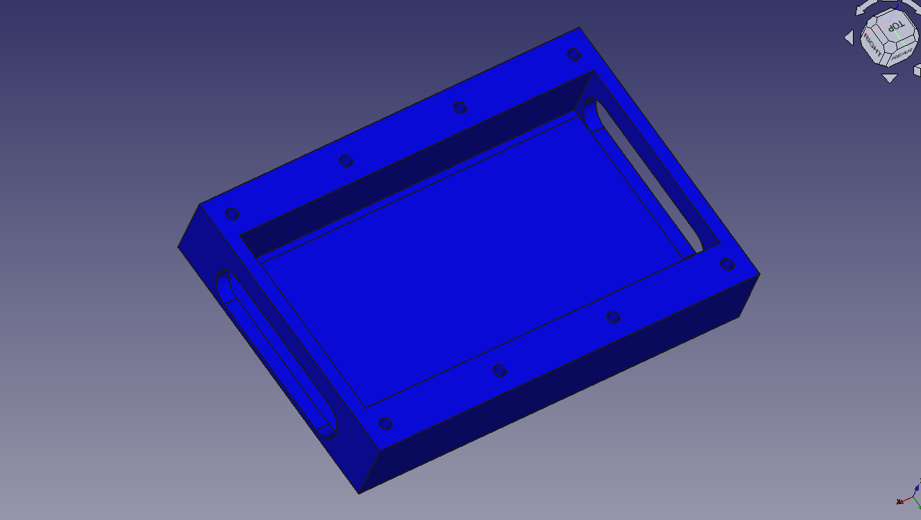

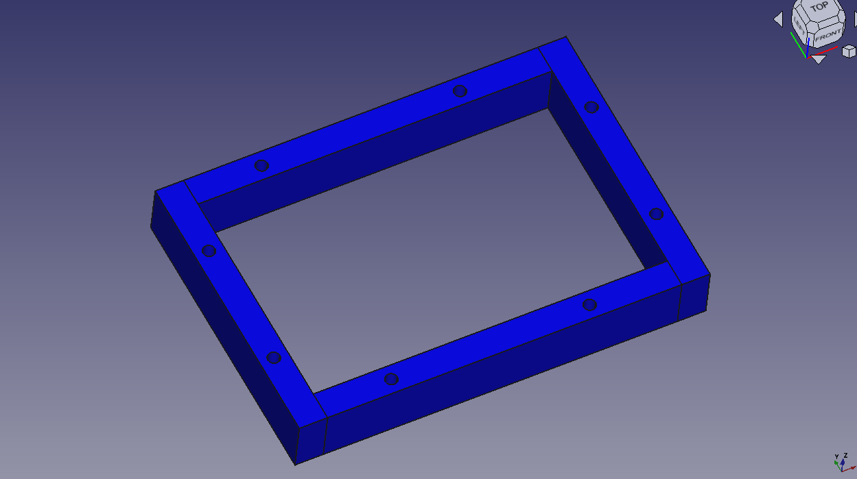

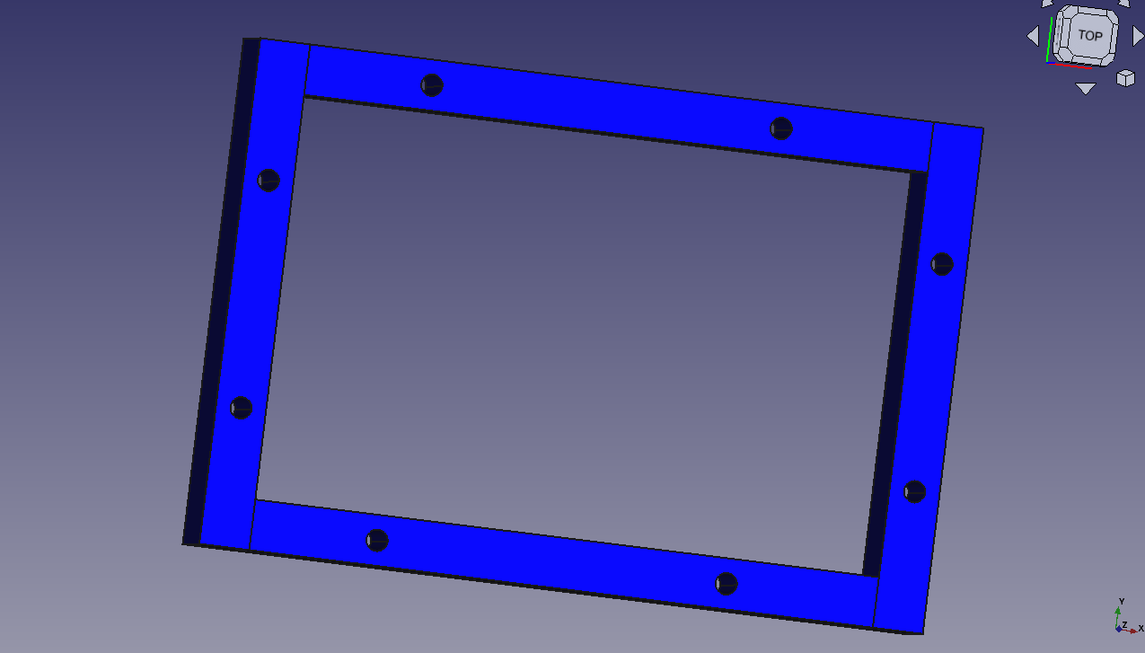

As an alternative to wooden battens. A printed inlay for the cavity. Such a structure gets epoxied in, the PCB fitted into that and the baseplate or plinth over that using the 8 threaded M10 holes
If you know your way around FreeCAD, you can modify the file to suit your application

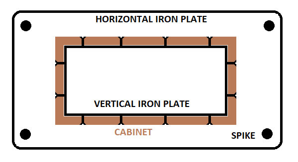

Please note that I (still) don't know how to use a 3D drawing program or maybe even Paint, but the following plan view sketch roughly describes what I would do if the speakers were mine in an attempt to leave things as they were originally built as much as possible and also so that they could be reversible.
The iron or steel base plate with spikes in the 4 corners and four perpendicular plates welded in the center which exactly reflects the internal perimeter of the speaker in which it is inserted like a sort of (iron) box inside the (wooden) box, fixed with appropriate screws placed laterally on the external sides of the wooden cabinet of the loudspeakers.

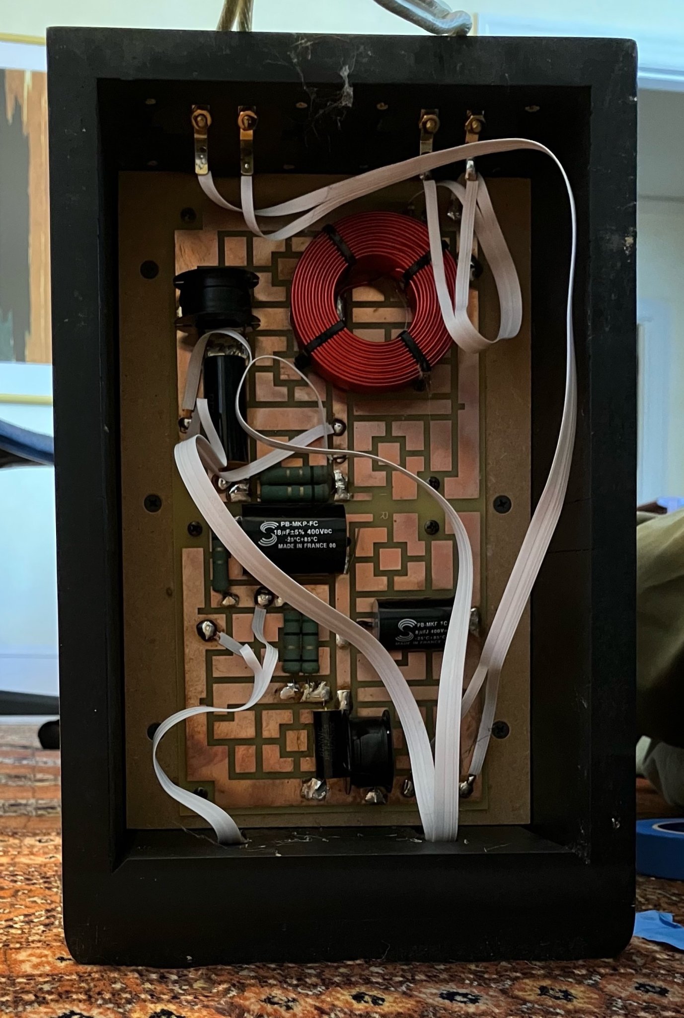

Just to close the loop, attaching here a better-lit photo. Height of available side walls is about 3.25", and there's nearly an inch of margin between the circuit board and those walls. So two battens approximately 1"x3.25" can screw into the side walls and abut the existing baseplate where the crossover is mounted. The rear, where with terminal cups are, isn't practical to work with. The front may be able to accommodate an additional batten, not flush with the board; resulting in a U-shape. Again many thanks to all.
Cool man, the wooden battens sounds like a plan. For the thread length available, with M10, just PLA+ is fine. Going with wood, please allow a few recommendations
See if you can carefully take that PCB off and that unfinished backing plate. Do a thorough inspection. Check what that backing is being screwed to. Is it a full plate? Is there a hole behind there? And such. This is because once you glue those battens on, there is no further access
