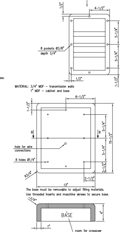

Tell me more about this steel plate base, dimensions and also the inner dimensions for the box opening? Also, about the wood plinth type too. Metric please. A sketch in FreeCAD is quicker and easier to do than a rough drawing
Randy, thanks so much for breaking out the method with alloy bar. Working out of a more modest skill-set and shop, I think I'll end up doing battens out of 1"x2" or 1"x3" lumber, trying to get an actual 1" rather than 3/4". Battens glued and screwed into the inner face of the MDF, then screwing the plinth straight into the battens. I don't expect to have to remove plinths more than once, and I think this construction will be adequate for that.

Do you have a pic of that insert with the crossover on it? Is this supposed to fit into the opening as the base of the cab? If so, then there wouldn't be any space for the battens anyway and the plinth would attach to that instead. I had missed this detail earlier in the thread. But with that baseplate glued in, it just screws onto that
A representation of the batten ring done in cad. The bars are 20x40mm and the threaded holes are M10. This ring gets glued up inside the cab opening, and screws can be used if desired. Just epoxy is fine for my use

There's a pic up at Post 25 in this thread but I'll try to attach a bigger one here. The crossover is on the underside of the plate you mention. I think there's enough space for battens, but they can't go across the rear and probably shouldn't go across the front; shouldn't need to go across front really because the facing battens (on the sides) would only be about 6" apart or less.Ecaroh

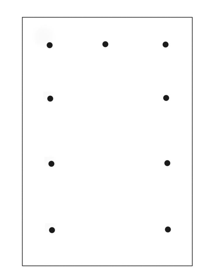

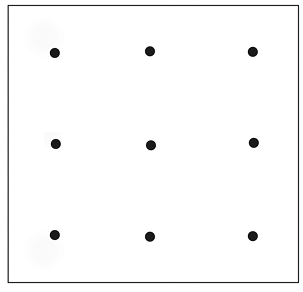

Please note that I (still) don't know how to use a 3D drawing program or maybe even Paint, but the following plan view sketch roughly describes what I would do if the speakers were mine in an attempt to leave things as they were originally built as much as possible and also so that they could be reversible.
The iron or steel base plate with spikes in the 4 corners and four perpendicular plates welded in the center which exactly reflects the internal perimeter of the speaker in which it is inserted like a sort of (iron) box inside the (wooden) box, fixed with appropriate screws placed laterally on the external sides of the wooden cabinet of the loudspeakers.
