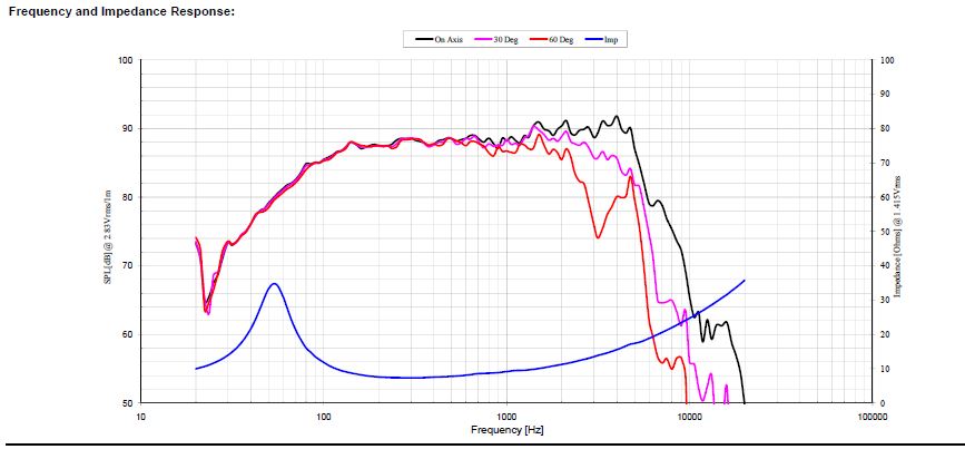

The Peerless 830874 looks good:
Peerless 830874 HDS 164 PPB MidWoofer Speaker

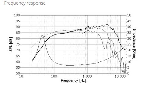

As does the dustcap-free SEAS U18RNX-P:
H1571-08 U18RNX/P
They both seem to cry out for that 5kHz (4.7uF/ 0.2mH/1.5R) shunt notch after the bafflestep coil so familiar to speaker builders. Of course, it might be 4.5kHz. Some fiddling required.
H1571-08 U18RNX/P
There is no reason to notch the U18. The response once the BSC is applied is VERY smooth and has no blemishes to worry about. It's a fantastic driver!

And a note about the cheaper (e.g. SLS series) Tymphany/Peerless/Vifa woofers - almost all of them have simple motor designs. Combine that with a breakup node in the 2-6KHz region and you get bad trending 3rd and 5th order harmonic distortion through the upper midrange. They are best used as the woofer in a 3-way crossed low (<800Hz). For a 2-way you need to look toward the HDS series if you want low distortion up to a higher crossover point (2KHz~). When deciding between drivers of the same series, try to pick the one which has a smooth roll off starting at a low frequency. Be weary of drivers which seem to be almost completely flat out to a certain point and then fall off a cliff - the reason for the extended response is that the response is being assisted by a cone breakup node which will cause higher non-linear distortion lower down in the frequency range. In the case of the HDS series almost all of them have breakup nodes, the PPB is probably the most benign so i'd choose that for a 2-way assuming that the motors are all identical. The aluminium cone will be the best if you cross below 1.4KHz (breakup node is 7KHz / 5th order HD = 1.4KHz) because the dip in the response between 1.5KHz to 7KHz will make the harmonic distortion go way down in the upper midrange.
