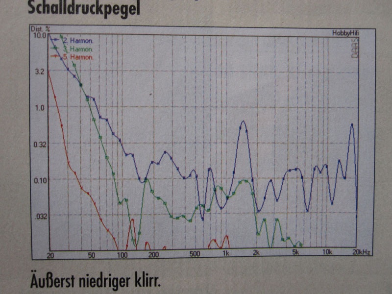

Hope these attachments come out
Wavecor's Balanced drive 7" woofers look good. A local manufacturer (Eastern Electronics) has been using Wavecor for a few years now. They have still to produce a commercial product using teh Balanced drive drivers though.
Thanks for those tests Andy; the distortion profile for 3rd harmonic is a bit worse than Zaphs test of the Peerless 830883 between 200-500Hz & the peak at ~1.5K, and probably a bit higher overall distortion below ~100Hz.
Can any German reader give us a summary of the conclusions of that test?
Pete McK
Pete McK
D'oh, just realised Andy's test relates to a 7" unit; I was thinking of the 6" WF106WA02 which is available here. Interesting that Wavecor give before & after burn-in figures for the 7" unit, and the test results are consistent with a slightly burned in unit - looks like Wavecor's published measurements are reasonably reliable...
