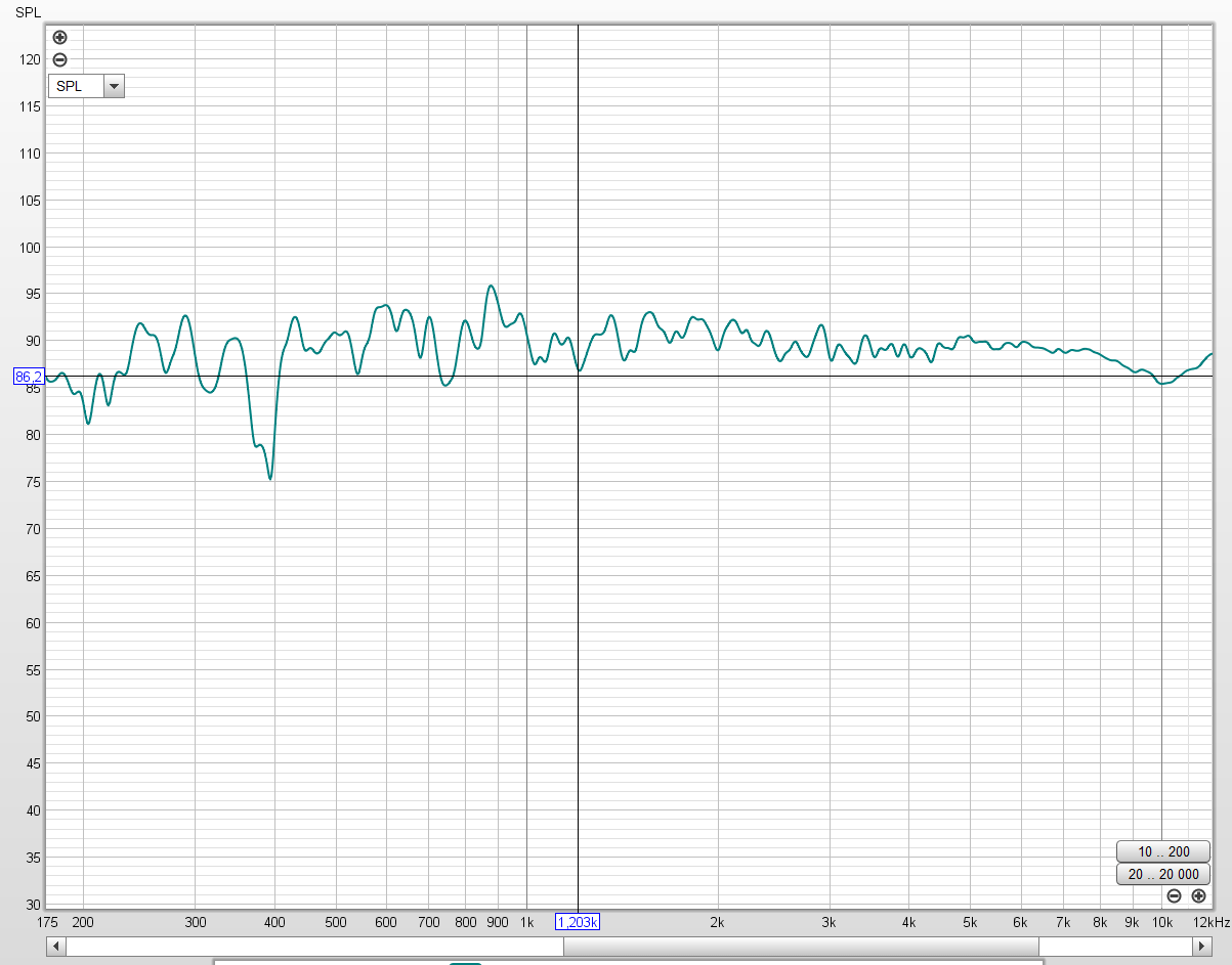

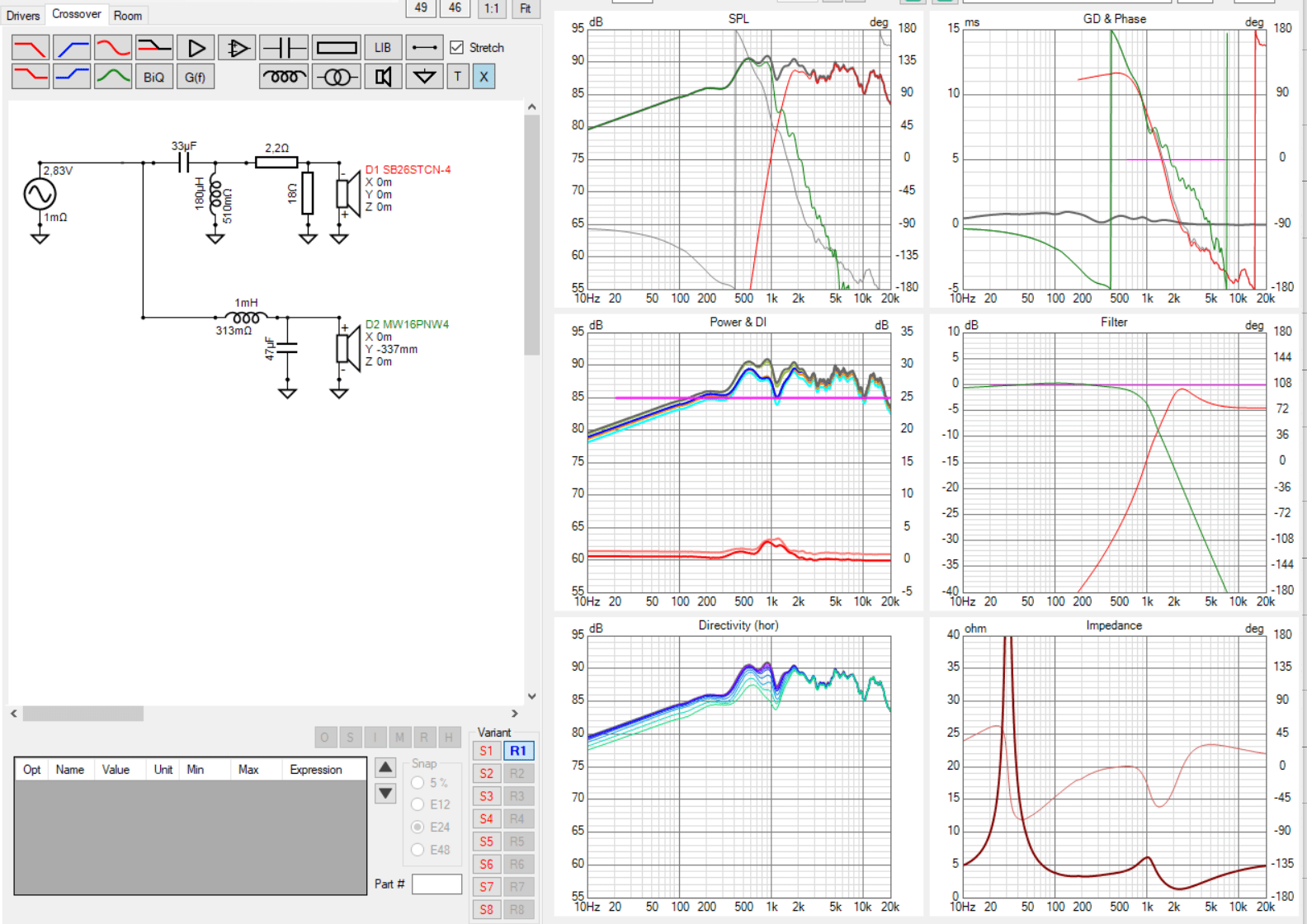

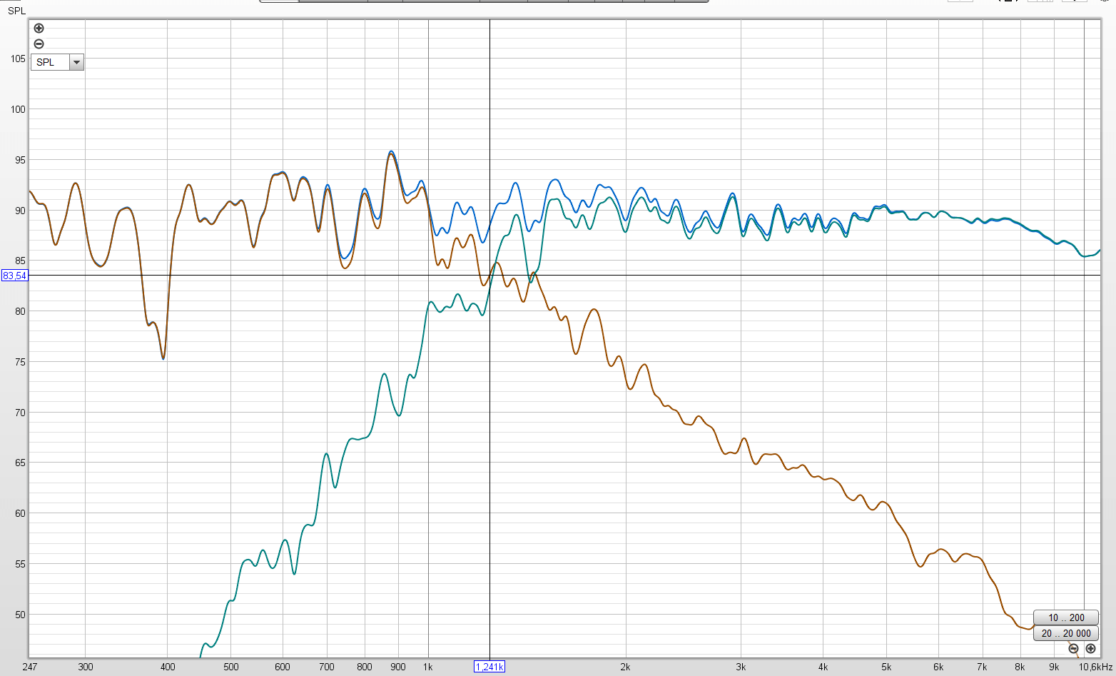

I ordered SB26STCN-C000-4 and made test speaker box with MW16PN to check is it possible to use SB26STCN cut at 1 kHz.
Actual cut off is at 1.2 kHz.
SPL line of 0.65 V signal, actual SPl level is little lower, I had not calibrated SPL level. Measured in room at 1m from speaker, not gated, only 1/24 octave smoothing is applied.

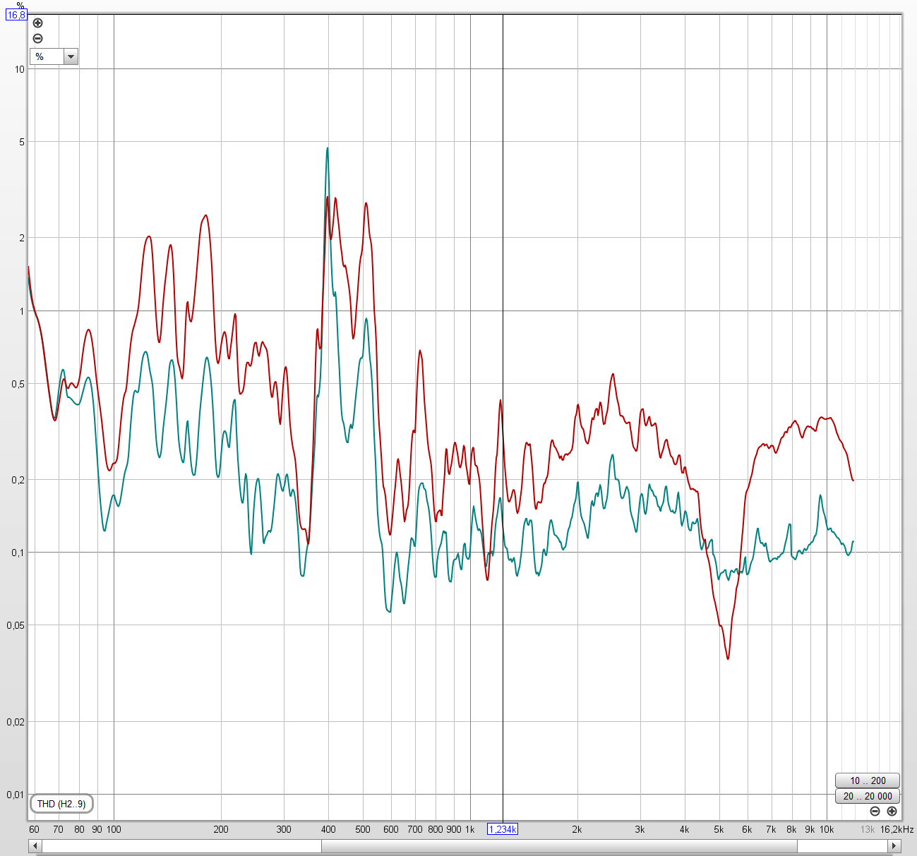

Distortions.
Higher line is at 2.0V signal, lower is at 0.65 V signal, measured in room at 1 m distance.
Also I find with this measurement MW16PN has some kind of THD issue at 400 and 510 Hz.
But generally no problems, SB26STCN cut at 1.2 kHz have no significantly bigger THD than midbass speakers have.

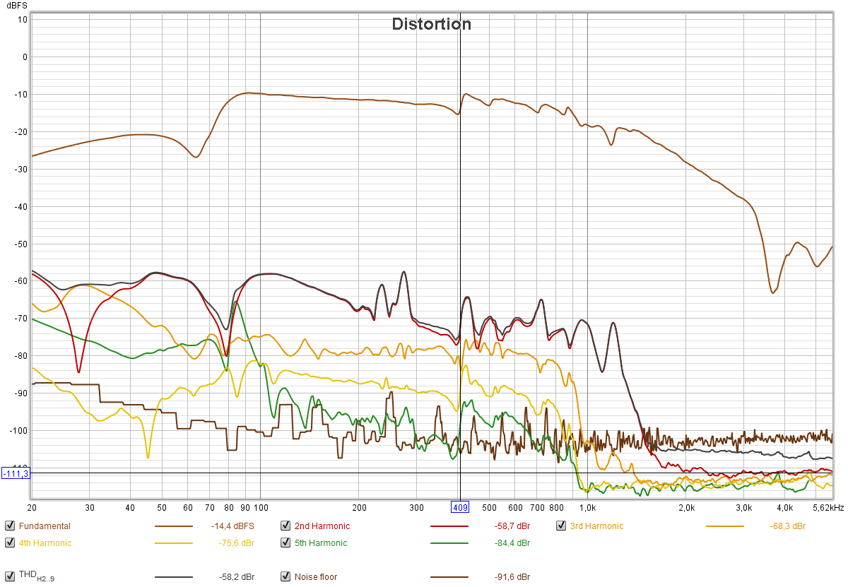

You may want to measure the distortion of each driver individually to make sure it is where you think it is.
A near-field distortion measurement typically gives cleaner data also.
Not trying to rain on your parade, but if you really have 2-5% distortion from 400-500 Hz at that low a level, many would consider that a lot of distortion.
96 dB at 1 meter is a pretty common higher level distortion test. For example:
