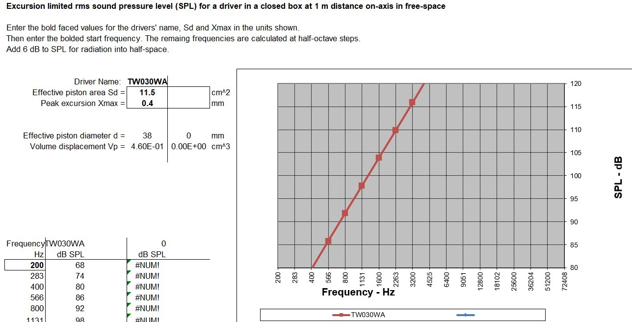

I was not correct. Sound pressure is proportional to cone acceleration, it is second derivative of cone displacement. If we talk about sinus signal it is 180 degrees delayed and in opposite phase with cone movement. So cone movement amplitude limitation when reaching Xmax symmetrically will cause direct H3 THD. Unsymmetrical amplitude limitation will cause H2 THD.Why I need to look at H3 (K3)? I know it is long disputed issue her on DIYaudo, but as sound pressure is caused by cone velocity not by cone movement amplitude, then H3 of sound pressure is not caused by cone amplitude limitation but by limited cone velocity (out vs in movement velocity) and H2 is caused by cone movement amplitude limitation.
