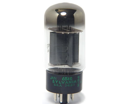

If of any interest, I had occasion to compare some 26 unused 6L6s over the last year or so: 8 x 6L6GC: GEC (NOS); 8 x 6L6EH, 2 x 6L6GC RCA black plate (NOS), 6 x 6L6WXT and 2 x 6L6GB (Ultron). They were all within 10% of one another (mostly closer) at nominal Ia = 75mA, on 330V h.t., fixed bias.
Many manufacturers, US and others have taken liberty with tube construction over the years. The specs and the curves shown in tube manuals are usually averages from a small lot of tubes made before the tube was released for production. Over the years production may have moved to a different location, or the production equipment may have been changed. Tooling wears out and gets replaced. Did you ever wonder how some tubes were manufactured over a 30 or 40 year span, but the curves in the tube manual were never changed.
As the production of vacuum tubes declined the manufacturers took even greater liberty with what they put inside the glass. Some tubes had the guts from an entirely different tube put inside them. This is especially true with TV sweep tubes, and tubes made for military contracts. The later version may have similar specs at the intended operating point, but is likely to be radically different in another circuit.
I have been testing several versions of 6EM7 dual triodes lately. There are a few different versions of these and the low Mu triodes are indeed quite different. They measure different as well with a Mu varying from 4 to 7 under the same conditions. These have an obvious difference in gain in a circuit without feedback, but may sound similar in a high feedback circuit where open loop gain variations are not as important.
I have seen several cases of some creative "tube stuffing" but none as far out as this one. The story goes like this. Sylvania needed to make some 6B4G's to satisfy a military contract. The 6B4G is a DHT, but Sylvania had already ceased production of DHT's. They found a suitable beam tetrode, the 6AV5GA which is a TV sweep tube and simply wired the base up to the same pinout as the 6B4G. Do you think this will sound the same as a 6B4G in your DHT amp? Are the curves identical to the 6B4G? I didn't think so. This is obviously the worst case, but there are differences in tubes with the same number stamped on the glass.
And yes, I have popped a pair of these into a 6B4 amp. They have far more bass than the real 6B4G's, but give up some of the DHT detail.
