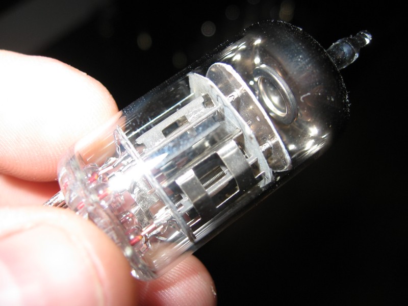

Stereophile helped me out here. I'm now running Electro Harmonix 12AX7's, which reduced the brightness and warmed the amp up significantly, along with Sylvania 6sn7 chrome domes, which really give the amp a rich, full sound and tightens the bass up wonderfully! I really have a beautiful sounding system now. I thought it sounded great with the Chinese tubes, but the sound with my current tubes just blows me away.

As spock would say "interesting". Does anyone know why tubes with the same number(eg 12ax7) would sound different. Is there some standard for the manufactures of tubes. When the chinese make the 12ax7,where did they get the equipment to make it? Did they buy the equipment from the U.S.What are they missing when they manufacture the tube? Any ideas?😕
keithgreenhalgh said:As spock would say "interesting". Does anyone know why tubes with the same number(eg 12ax7) would sound different. Is there some standard for the manufactures of tubes. When the chinese make the 12ax7,where did they get the equipment to make it? Did they buy the equipment from the U.S.What are they missing when they manufacture the tube? Any ideas?😕
Tolerances of sizes, I suppose, so parameters are different.
Well, the insides of the tubes are completely different. You can look and physically see that the Chinese tubes and the reproduction Electro Harmonix tubes aren't constructed anything alike.
Charles.

ChopperCharles said:Well, the insides of the tubes are completely different. You can look and physically see that the Chinese tubes and the reproduction Electro Harmonix tubes aren't constructed anything alike.

Yes, they are different. But your original question was about bass so I proposed to eliminate an output tranny and get better bass like I did when needed to fix a guitar amp ASAP when no output transformer was available at all, so I implemented a hybrid output stage. As the result, the amp sounded superb with bass guitar as well.
ChopperCharles,
As you have found satisfaction, I should not comment further. But matters are a little confusing. A 12AX7 (ECC83) is a 12AX7, unless the manufacturer went very wild with his designations. When you say that the internal construction is "not anything alike", I begin to wonder; what exactly did you have? It would be most interesting to have close-up photos, but that might be impractical for you.
I am not going to open a hornet's nest about tubes of the same designation sounding different; just to say that in any half-decent design and with proper tubes, that will not happen. (By proper tubes I mean differing by no more than +/- 10% from the published characteristics.) I have seen the Russians being pretty liberal with their designations, e.g. using exactly the same innards for a KT66 and a 6L6 - but the former is twice the cost.
But I am glad that you seem to have solved your problem.
