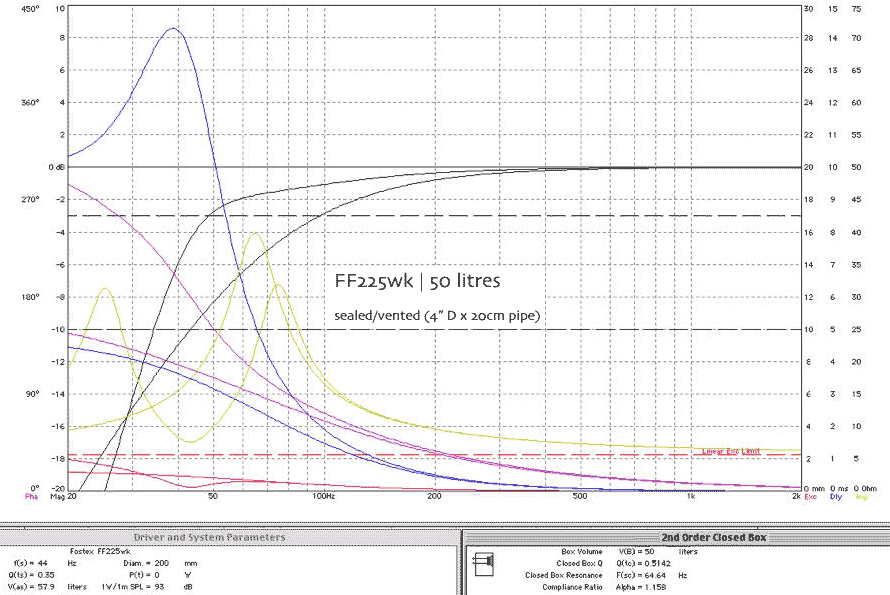

50l box idea. About $180.
https://www.madisoundspeakerstore.com/approx-8-fullrange/fostex-ff225wk-8-full-range/
https://www.madisoundspeakerstore.com/bullet-tweeters/fostex-ft17h-horn-super-tweeter/
Buy one, add a tweeter and go mono. Just a suggestion.
